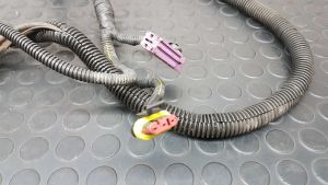

Harness:<br>
[[File:Opel Astra Power Steering Pump Harness.jpg|frameless|border]]
<br>

== Electrical Connection [https://openinverter.org/forum/viewtopic.php?p=3771#p3771] ==
When i turn to start the car i have one latching (or two) relay to provide "engine on" signal for car computer. I connect blue/white wire here nd as soon as i start inverter power steering is on!
[[File:Opel_Astra_Power_Steering_Pump_Harness.jpg|alt=|border|right|frameless]]

=== Pinout and Cables ===
{| class="wikitable"
|+Wire Colors and Functions
!Cable Color
!Gauge
!Function
|Red
|"thick"
| +12V Supply
|Brown
|"thick"
|Chassis Ground
|Black
|"thin"
| +12V Ignition Signal
|Blue-White
|"thin"
|"Engine Running" Indicator from Alternator
To ensure a quick start up of the pump the signals on the black and blue-white wire need to be sequenced. The black wire indicates that the ignition is on. This alone does not start the pump, probably to save battery capacity for starting the internal combustion engine. Only if there's voltage on the blue-white wire present the pump starts. This would be connected to the alternator to indicate the engine is running and the alternator provides enough current to feed the power steering pump.
Connecting both wires together and feeding them +12V at the same time works as well, but results in slow spool up of the pump.
=== LIN Communication ===
=== Power Consumption ===
The pump should be connected via an 80A fuse to the 12V. The initial current will be quite high, the idle current should be around 6A without delta pressure from the steering column.
