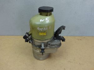

Opel Power Steering Pump
This type of power steering pump is made by TRW and used in the Opel/Vauxhall Astra G and Zafira A. It's called the "Type 2" or "TRW 2" pump and is known to be quite noisy.
The correct oil for this pump is Fuchs TITAN CHF202 (formerly known as Pentosin CHF202) or anything that fulfills the Opel requirement 19 40 766. It has a green color. [1]

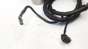

Electrical Connection [2]
Schematic from the Opel Astra G
Pinout and Cables
Wire Colors and Functions
Cable Color Gauge Function
Red 10mm² +12V Supply
Brown 10mm² Chassis Ground
Black 0.75mm² +12V Ignition Signal
Blue-White 0.75mm² Alternator Pin 61
Brown-White 0.75mm² K-Bus Diagnostics
To ensure a quick start up of the pump the signals on the black and blue-white wire need to be sequenced. The black wire indicates that the ignition is on. This alone does not start the pump, probably to save battery capacity for starting the internal combustion engine. Only if there's voltage on the blue-white wire present the pump starts. This would be connected to the alternator to indicate the engine is running and the alternator provides enough current to feed the power steering pump.
Connecting both wires together and feeding them +12V at the same time works as well, but results in slow spool up of the pump.

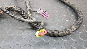

LV Connectors
Two different sets of connectors have been seen on this pump:
1) TE/AMP Superseal 1.5 series
  • Pump harness (F): 282087-1
  • Mating socket (M): 282105-1
  • Terminals: 183036-1 (20AWG)
  • Seals: 281934-2 (2.4mm ID)
2) Bosch Kompakt 1.a series
  • Pump harness (F): 1 928 404 221
  • Mating socket (M): 1 928 405 136
  • Terminals: BDK 2.8 series
Mechanical Connection and Dimensions
The hydraulic high pressure line has an M16x1.5 thread [3].
