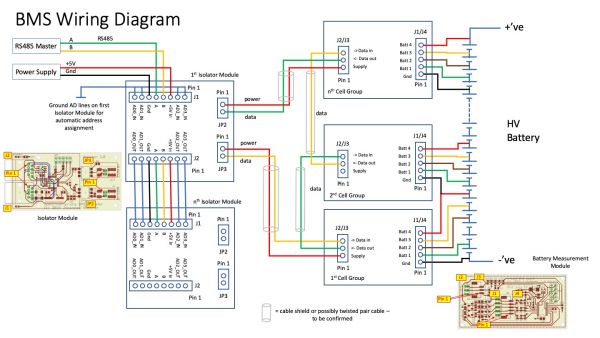

== Wiring Diagram ==
[[File:BMS Wiring Diagram.jpg|none|thumb|600x600px|Wiring Diagram]]

The communication is terminated/translated via an isolator module. It translates the "proprietary" 1-wire protocol to a standard protocol, currently RS485. Its output connects the the first cell-groups positive terminal via a 1k resistor (Pin 3 of the 4-cell module) and the communication input. Its input connects to the last cell groups positive terminal, also via 1k resistor and the communication output.
All communication that goes into the first module is forwarded in a daisy-chain manner out to the last module. Each cell module can see the communication stream of the modules BEFORE it but not the modules after it. Exception: address mode, discussed below.
Wiring Diagram
Wiring Diagram
