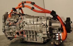

Description
The L210 is a continuously variable transmission (CVT) which can be found in the Lexus gs300h. It is very similar in design to the gs450h CVT. It contains two motor-generators - MG1 and MG2. When used as originally intended, MG1 is spun by the ICE, via a planetary gear system, and acts primarily as a generator. MG1 also acts as a starter motor for the ICE. MG2 is connected to the output shaft via a second planetary gear system to provide traction directly to the rear wheels.
The ratio between MG1 and the output shaft is 2.6:1. The ratio between MG2 and the output shaft is 3.333:1.
The official power output of the CVT is 105kW and 300Nm of torque, but this has yet to be tested.
For use in a pure EV application, the ICE input shaft can be locked stationary with a plate or bar. This allows traction to be provided by both MG1 and MG2.

Connections
Left hand side
Left hand side connections
  1. MG1 3-phase power connection
  2. MG1 resolver (and temperature) port
  3. MG2 resolver (and temperature) port
Right hand side
Right hand side connections
  1. Water input/output for oil to water heat exchanger
  2. Mechanical shifter and shift sensor port
  3. Ground strap
  4. MG2 3-phase power connection
