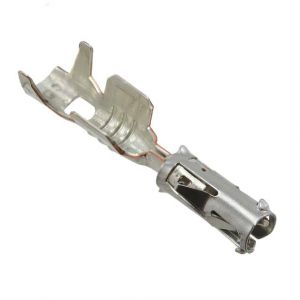

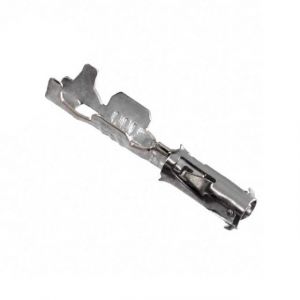

A good alternative to this, otherwise difficult to obtain, connector is to replace the receptacle/header with the following parts from Molex:
{| class="wikitable"
!Image
!Part No.
!Item
!Quantity
|036638-0002
|CMC header connector 48pin
|1
|064320-1311
|CMC receptacle 48pin
|1
|064320-1301
|CMC wire cap
|1
|[[File:064323-1039.jpg|thumb]]
|064323-1039
|CP terminal
|4
|[[File:064323-1029.jpg|thumb]]
|064323-1029
|CP terminal
|32
|064325-1010
|CMC plug
|8
|064325-1023
|CMC plug
|4

Inverter interface connector (A62) 90980–12630 Black connector on the side of the inverter. This connector is not sold anywhere to our knowledge.
Image Part No. Item Quantity
036638-0002 CMC header connector 48pin 1
064320-1311 CMC receptacle 48pin 1
064320-1301 CMC wire cap 1
064323-1039 CP terminal 4
064323-1029 CP terminal 32
064325-1010 CMC plug 8
064325-1023 CMC plug 4
