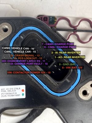

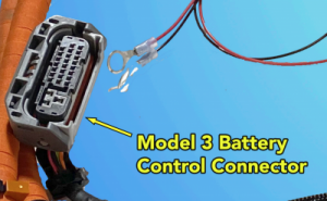

[[File:M3conetor.png|thumb|hv controller connector]]
[[File:M3 HVS Pinout.jpg|thumb|pinout from HV controller]]

=== HV controller ===
[https://openinverter.org/forum/viewtopic.php?t=1650 Model 3 High Voltage Controller]
the HV controller located in the penthouse controls the PCS, contactors, pyro fuse, talks to the bms boards, etc
reading cell voltages and controlling contactors can be done by talking to the HV controller over CANbus
you can read cell temps and voltages with [https://www.scanmytesla.com/ scanmytesla] and hooking up a obd connector to the hv controller canbus
the HV matting connector is:
Sumitomo TS Sealed Series
[https://kinkong-connector.com/ru/products/6189-6934-ID2081.html 6189-6934]
[http://prd.sws.co.jp/components/en/detail.php?number_s=61897077 6189-7077]
aliexpress: https://nl.aliexpress.com/item/1005003491557509.html?spm=a2g0o.productlist.0.0.4bbf7ac6nm1SAJ&algo_pvid=ed562c44-660e-4e11-96f9-d5e5b150d5d7&algo_exp_id=ed562c44-660e-4e11-96f9-d5e5b150d5d7-0&pdp_ext_f=%7B%22sku_id%22%3A%2212000026035026850%22%7D
see thread post https://openinverter.org/forum/viewtopic.php?p=31886#p31886

HV controller
you can read cell temps and voltages with scanmytesla and hooking up a obd connector to the hv controller canbus
6189-6934
6189-7077
