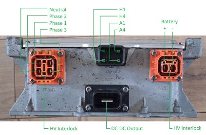

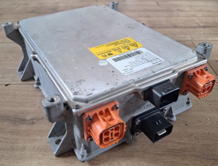

EP3CCU1130B
MG4 charger
EP3CCU1130B pinout
LV pinout
Specs:
AC input 1: 85-265V 32A Max
AC input 2: 300-456V 16A Max per phase
DC output 1: 220-490V 24A Max
DC output 2: 220-490V 31.5A Max
Dimensions: 31 x 27 x 11 cm (37 with connectors and coolant connections)
weight: 8,5 kg
To use the charger:
Connect pins on the LV connector:
H1 to switched 12V
G4 to ground
C1 to CAN H
C2 to CAN L
B2 Via a 100k resistor to pin 12
E1 Via a 100k resistor to pin 12
D2 see pin E1 and B2
A1 to C4
C3 to C4
D4 to C4
C4 (see pins A1, C3 and D4) this outputs a square wave at 50Hz.
A3 to CP
B3 to PP (or resistor to ground, 220 Ω for 32A max or 680 Ω for 16/20A max or 2000 Ω for V2L )
Connect pins on the AC HV connector to the charging port and the protective earth to the case.
The HV interlock needs shorting, integrated in the AC connector.
Connect pins on the DC HV connector to the DC bus.
The HV interlock needs shorting, integrated in the DC connector.
Controlling the charger:
This is more complicated it uses 1 CANFD bus at 500kbit 2Mbit data rate. It needs 4 messages (maybe 7)
0x4E1, 0x4E3, 0x4F3 keep the charger awake (longer the other messages).
0x15A
  • max DC charge current
  • max DC charge voltage
  • BMS charging command
0x15B
  • BMS_Operation_State
0x08A DCDC control
  • DCDC_Mode_Request
0x12C: BMS data
  • min/max cell voltages and cell numbers
  • min/max cell temperatures and cell numbers
  • battery voltage
  • battery current
