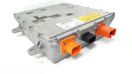

MG ZS Charger
MG ZS Charger Part number(s)
Part Number Description Phases AC/DC Input 1 AC/DC Input 2 AC/DC Output 1 AC/DC Output 2 DC/DC Input DC/DC Output Weight
ZS10BC6600A (10822241) MG ZS AC Charger single phase 85-265V 32A Max N/A 230-480V 20A Max 6.6KW Max N/A N/A N/A 8.5kg
EP2CCU1130A (11276088, 11428079) MG ZS AC Charger three phase 85-265V 32A Max 85-265V 16A Max 250-500V 24A Max 250-500V 32A Max 250-500V 9-16V 220A Max@13.V
EP3CCU1130B (11489298,11572316) MG 4 Charger three phase 85-265V 32A Max 300-456V 16A Max 220-490V 24A Max 220-490V 31.5A Max 220-490V 9-16V- 220A Max@13.5V
EH3CCU6630B (11572315,11477526) MG4 Trophy single phase 85-265V 32A Max N/A 220-490V 22A Max N/A 220-490Vdc 9-16V 220A Max@13.5V
EP2CCU6625A (11237810) MG5 single phase 85-265V 32A Max N/A 230-450V 22A Max N/A 230-450Vdc 13A Max 9-16V 178A Max@14V
S12CCU1130C (11740109) IM6 three phase 85-265V 32A Max 300-456V 16A Max 420-900V 12A Max 420-900V 18A Max 420-900Vdc 9-16V 220A Max@13.5V

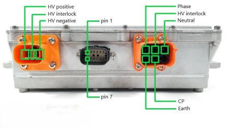

ZS10BC6600A
ZS10BC6600A Overview
ZS10BC6600A Pinout
LV Pinout
Specs:
AC input: 85-265V 32A Max
DC output 230-480V 20A Max (6.6KW Max)
To use the charger:
Connect pins on the LV connector:
1 to switched 12V
2 to ground
3 to CAN H
4 to CAN L
8 Via a 100k resistor to pin 12
10 Via a 100k resistor to pin 12
12 see pin 8 and 10
Connect pins on the AC HV connector to the charging port.
When using Foccci the CP can also be connected to Zombie CPspoof
output through a 1k resistor.
Connect pins on the DC HV connector to the DC bus.
The HV interlock needs shorting, integrated in the DC connector.
The PP in the AC connector is internally connected to pin 11 on the LV connector
Controlling the charger:
This is simple it uses 1 CANbus message 0x29C at 100ms interval on a 500kbit bus
In this message there are 3 values:
Max AC current
Max DC current
Max DC voltage
Reading data from the charger:

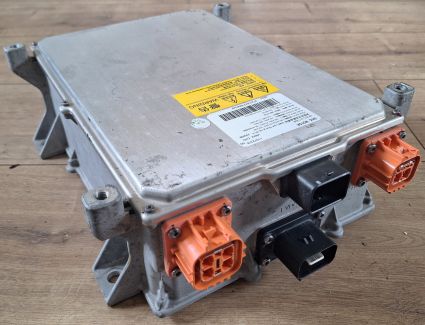

EP2CCU6625A
pinout from EP2CCU6625A damien bench demos in this video https://vimeo.com/924354403?fl=pl&fe=sh

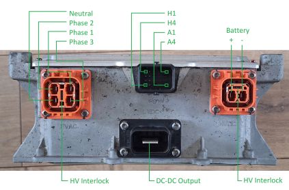

EP3CCU1130B
MG4 charger
EP3CCU1130B pinout
LV pinout
Specs:
AC input 1: 85-265V 32A Max
AC input 2: 300-456V 16A Max per phase
DC output 1: 220-490V 24A Max
DC output 2: 220-490V 31.5A Max
Dimensions: 31 x 27 x 11 cm (37 with connectors and coolant connections)
weight: 8,5 kg

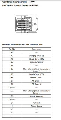

To use the charger:
H1 to switched 12V
G4 to ground
C1 to CAN H
C2 to CAN L
B2 Via a 100k resistor to pin D2
E1 Via a 100k resistor to pin D2
D2 see pin E1 and B2
A1 to C4
C3 to C4
D4 to C4
C4 (see pins A1, C3 and D4) this outputs a square wave at 50Hz.
A3 to CP
B3 to PP (or resistor to ground, 220 Ω for 32A max or 680 Ω for 16/20A max or 2000 Ω for V2L )
Connect pins on the AC HV connector to the charging port and the protective earth to the case.
The HV interlock needs shorting, integrated in the AC connector.
This is more complicated it uses 1 CANFD bus at 500kbit 2Mbit data rate. It needs 4 messages (maybe 7)
0x4E1, 0x4E3, 0x4F3 keep the charger awake (longer the other messages).
0x15A
  • max DC charge current
  • max DC charge voltage
  • BMS charging command
0x15B
  • BMS_Operation_State
0x08A DCDC control
  • DCDC_Mode_Request
0x12C: BMS data
  • min/max cell voltages and cell numbers
  • min/max cell temperatures and cell numbers
  • battery voltage
  • battery current
