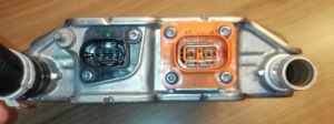

Connectors
Webasto HVH50 connectors

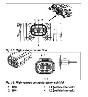

The HV connector is a Tyco HVA280 connector with A-key (might be different on other devices). Part # HVA 280 / TE Internal #: 4-2103177-2 / TE Internal Description: PLUG ASSY, KEY B, FA,CPA, HVA280-2PHI XE[1].
The small center pins are for interlock (detect that the connector is seated). The right pin on the connector (FIG 16 / with tab facing upwards) is HV+, the left one HV-

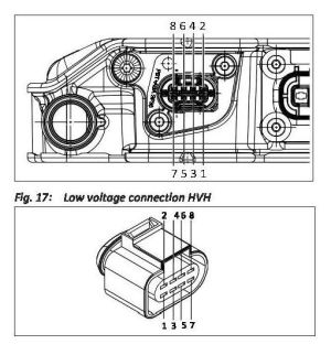

The LV connector is best found by the VW part number 1J0973714
  • Pin 1 is permanent 12V
  • Pin 2 is an analog output
  • Pin 3 is an analog or PWM input
  • Pin 5 and 7 are interlock - not sure what to do with it, can be left floating.
  • Pin 6 is LIN
  • Pin 4 and 8 are unused
Ground must be connected to the case via a stud.
Low Voltage Connector Pin Layout
Pin Layout For HV Connector
