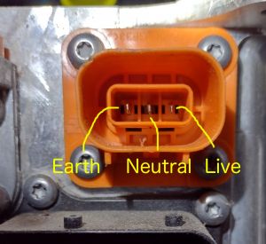

AC Connection
Golf GTE and all 5QE915682 series 3.6 kW chargers - Part number TE Connectivity 2103177-2
MLBevo
TE YHVA630-5phm-6mm-A and HV output coding A is 2141256-1
