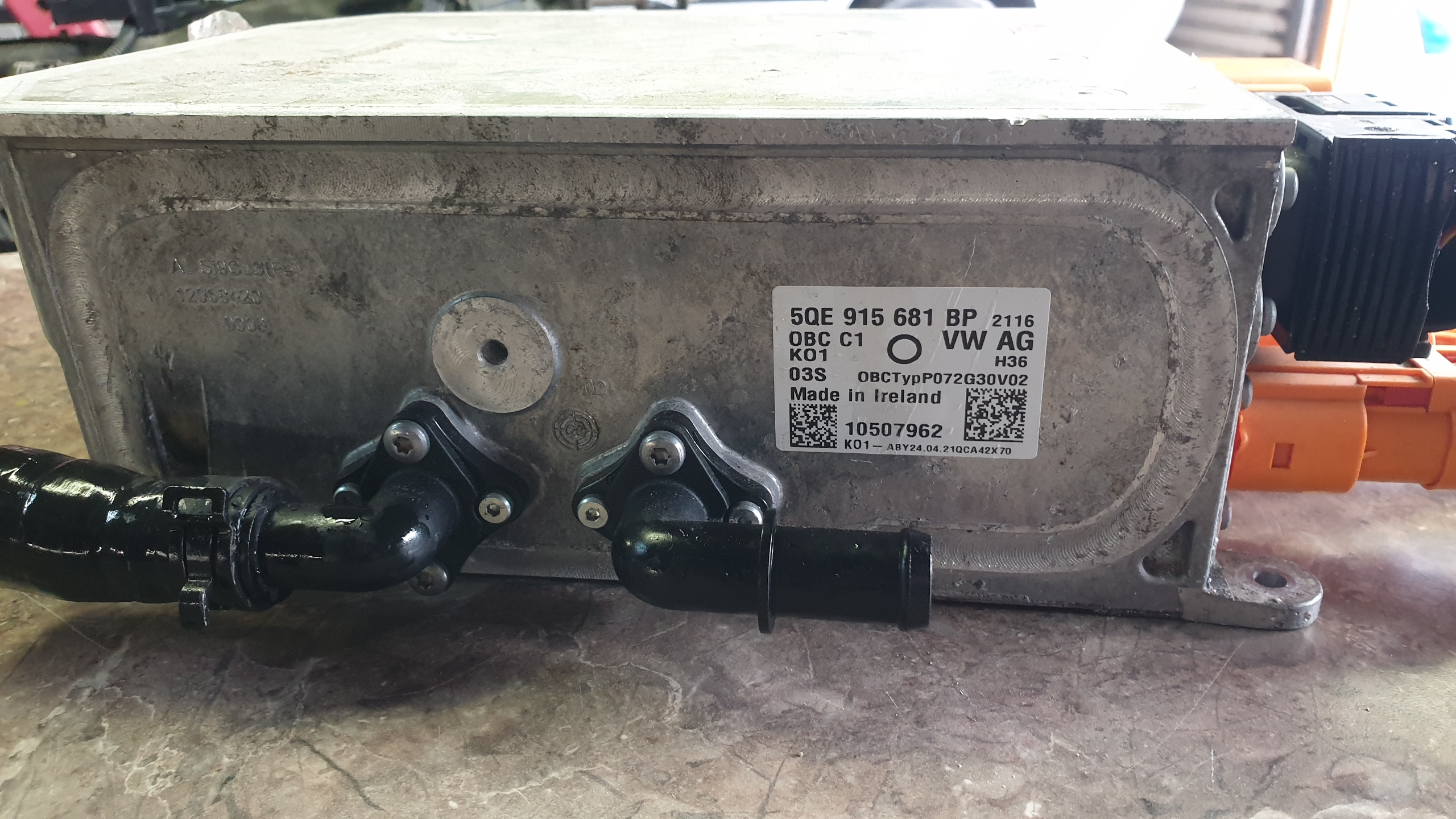

I think this particular charger is 11kW 3phase. Kind of obvious from 5 pin AC input connector...
5QE915681BP

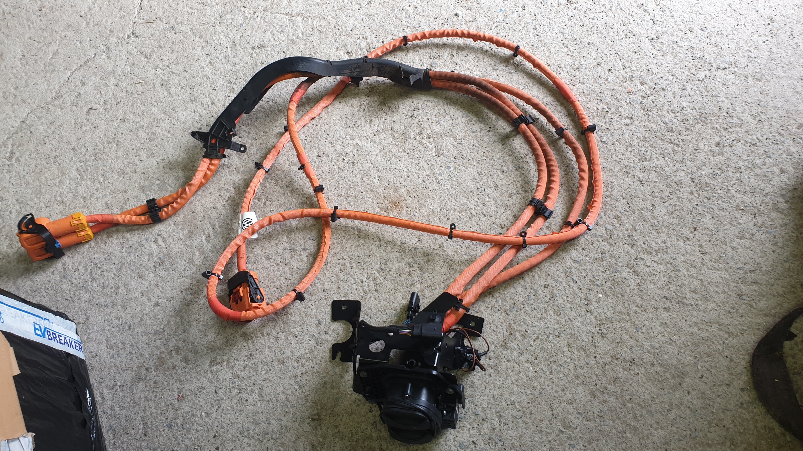

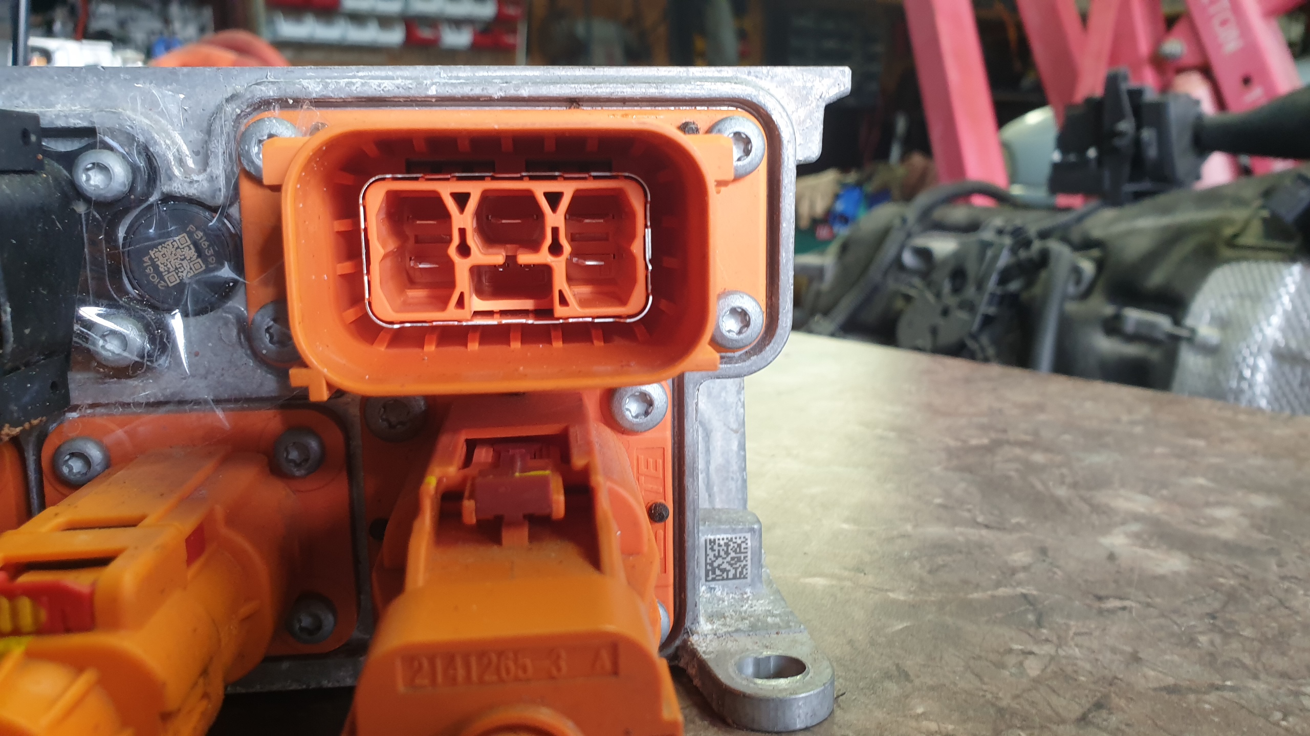

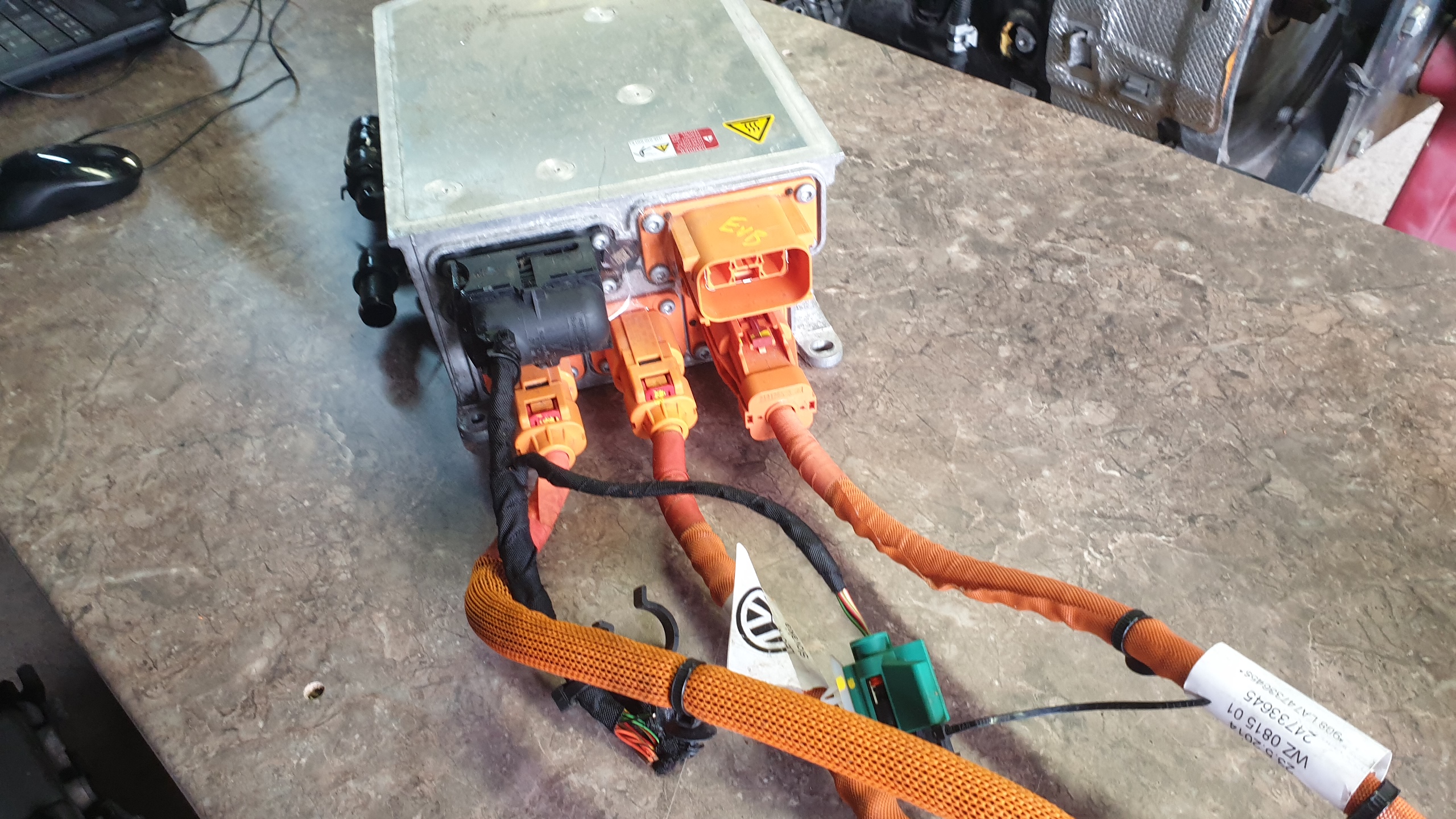

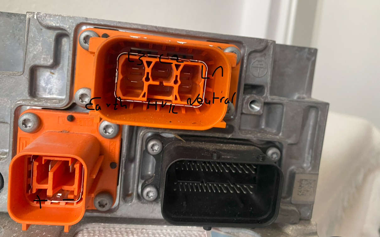

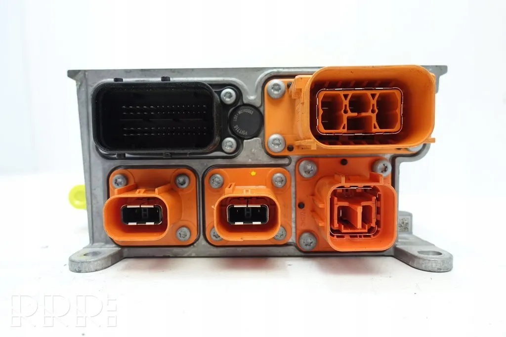

Well, the charger arrived along with charge port and some cables.
The 60 pin signal connector is TE part number 2208272-1 which they helpfully have no data available to mere mortals :
https://www.te.com/usa-en/product-2208272-1.html
A quick search on Ali gives a possibility :
https://www.aliexpress.com/item/1005001420591206.html

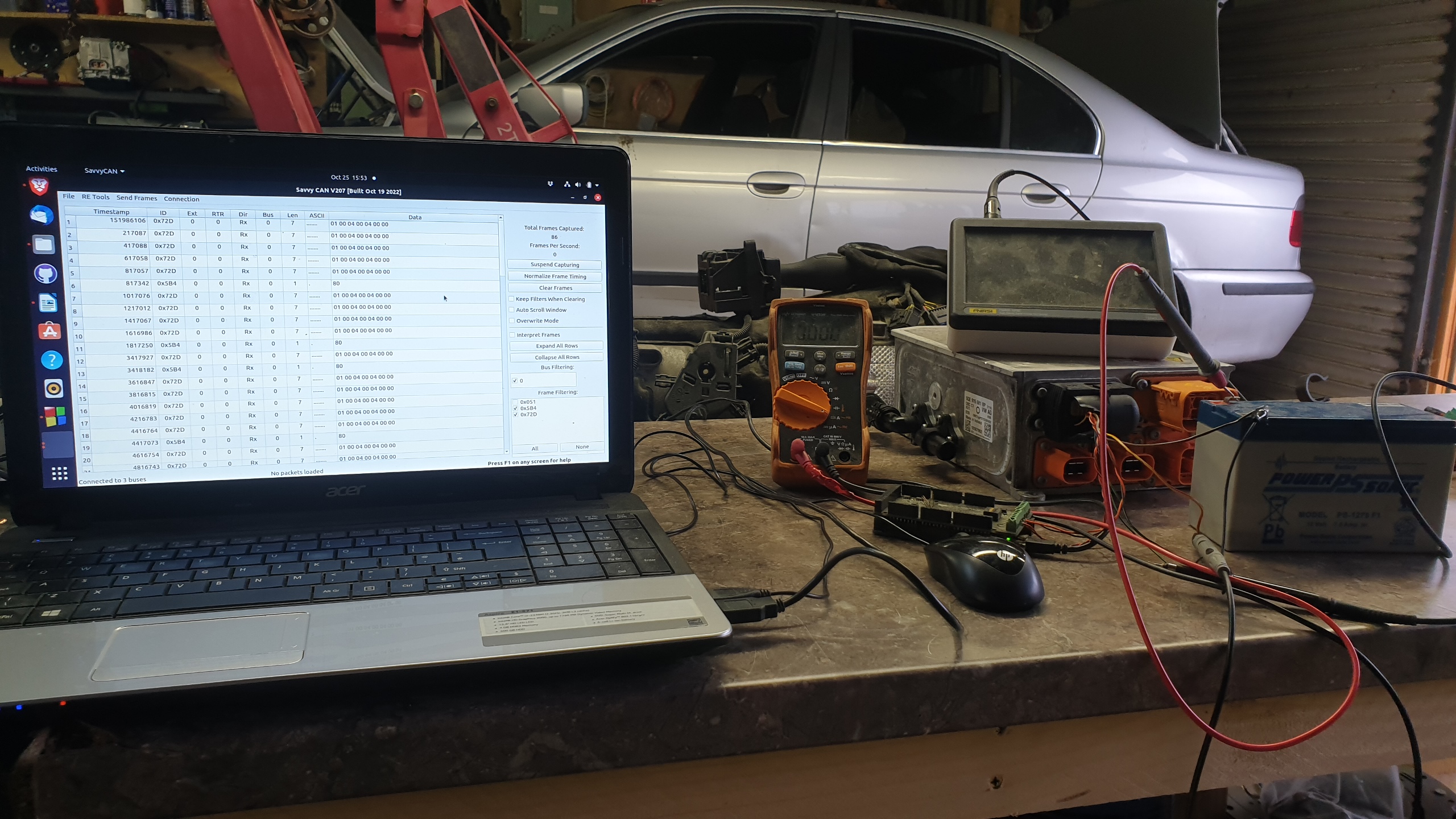

Charger has 2 CAN busses, 12V and GND and two hvil wires. On application of 12v no can is sent and charger goes asleep after approx 10 secs.
Sending any CAN msg gets it to wake and send 2 ids of its own.

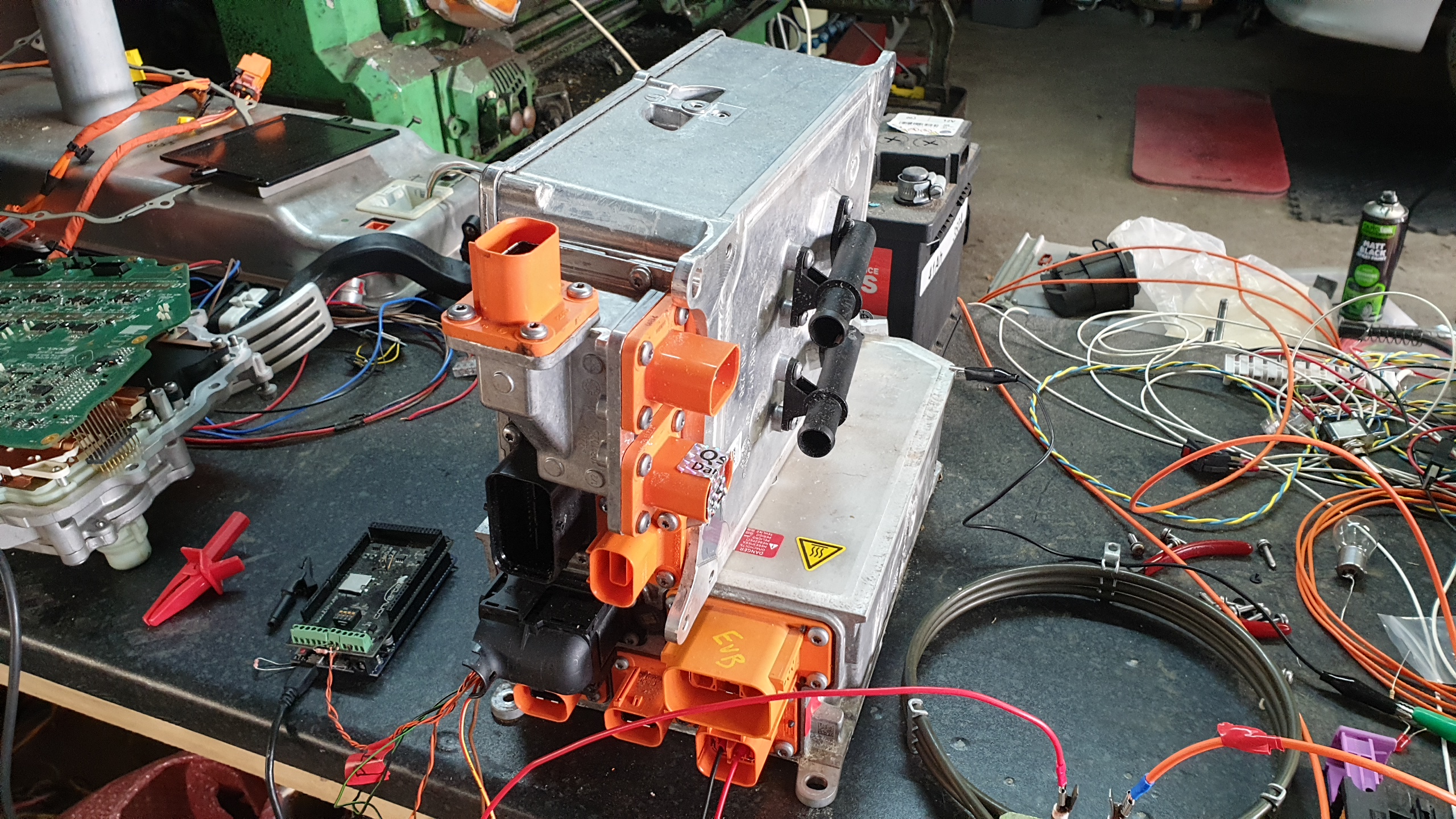

No I wont be taking it apart. The plan is to reverse engineer the CAN messages needed to make it work outside a VW so it can be used in conversions.

Made a Github repo for the charger to start collecting data:
https://github.com/damienmaguire/VW-OnBoard-Charger
Included on there are some logs from today's testing. I think I've found the CAN ids with AC and DC voltages so if anyone wants to help decode them would be much appreciated.

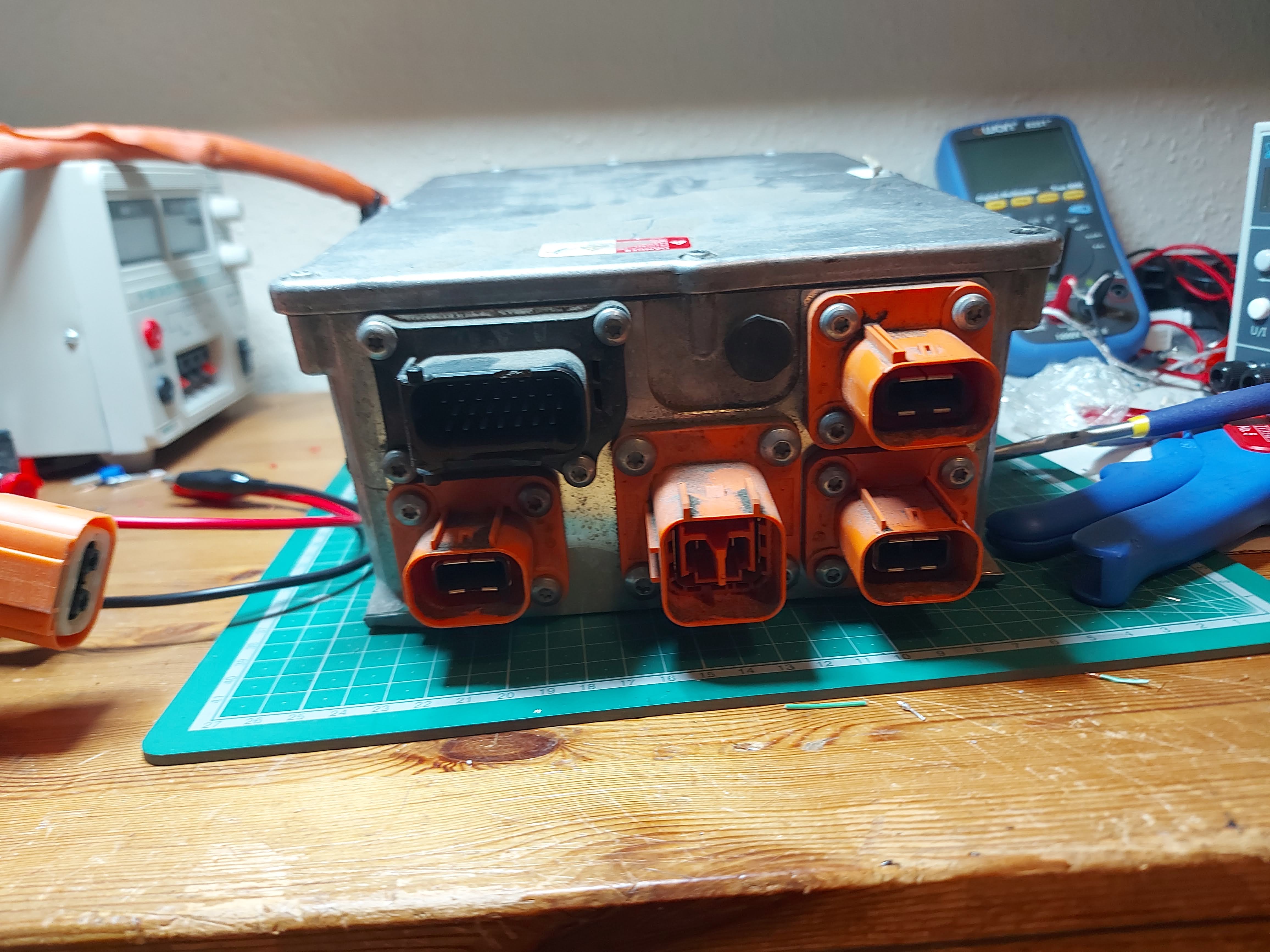

I got a VW E-Golf charger, you guys think it be the same canbus controlls?
I have gotten myself quite setup with some testing gear now so might as well give this ago. Different pinout though, what is best way to get me some of that VW service manual info?

Got a Golf PHEV charger in the post this morning from Germany. 150 Euros. At first glance CAN messages from this model seem idential to the logs in DomT repo so it does look to be the case that there are different CAN messages used in different models. Also it seems from the wiring that the PHEV charger manages the charge port whereas the Mii version does not. Updated some logs in the repo with first bench test result.

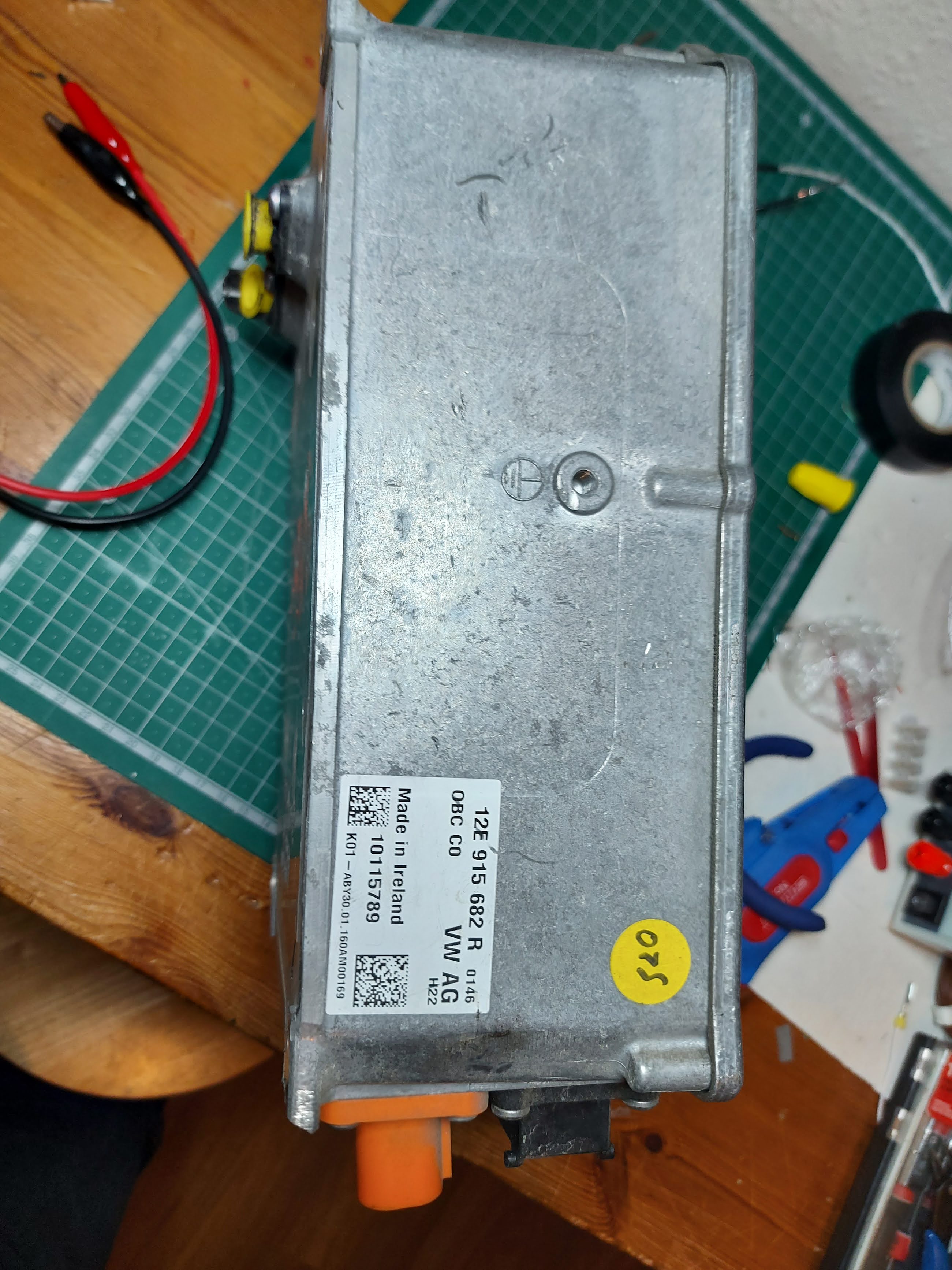

I pulled a log of my charger which I believe is from an Egolf. Some can message IDs match with Damiens Golf Phev charger and some are unique.

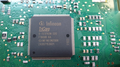

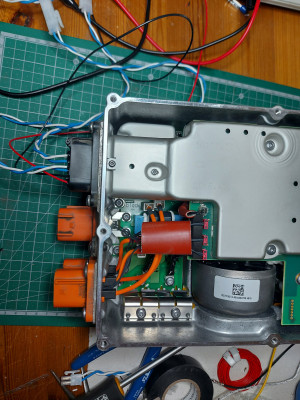

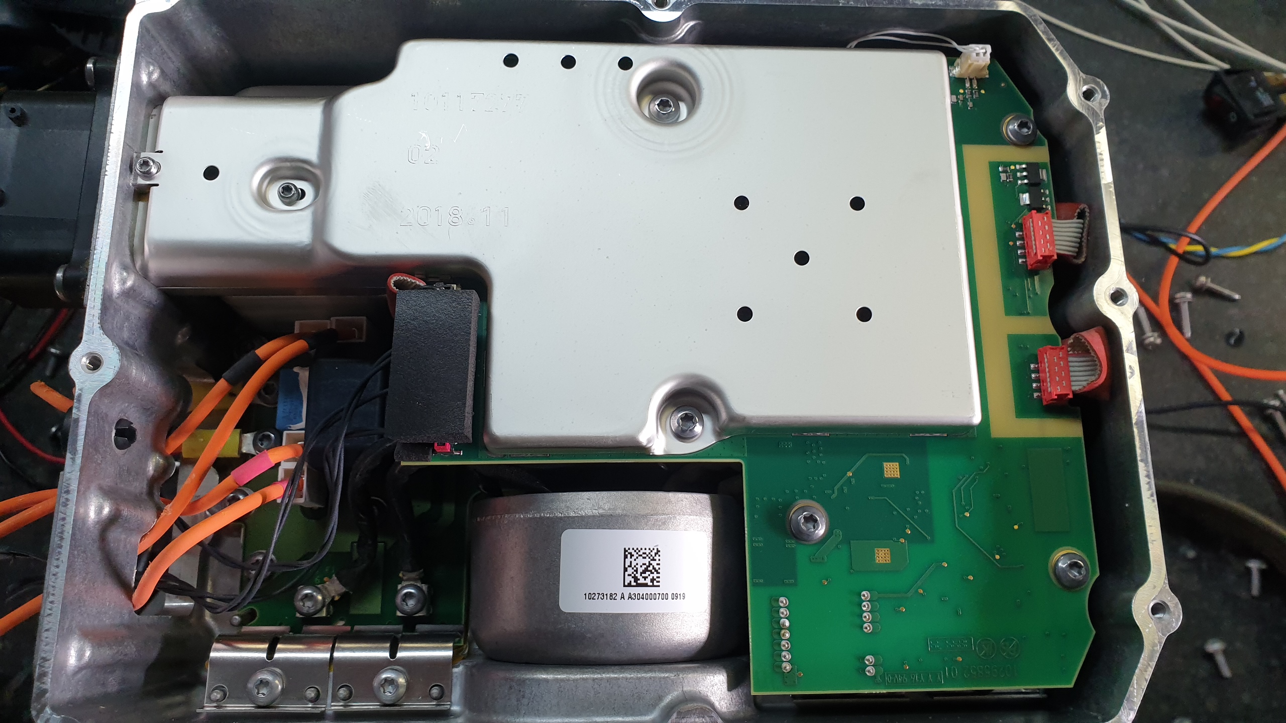

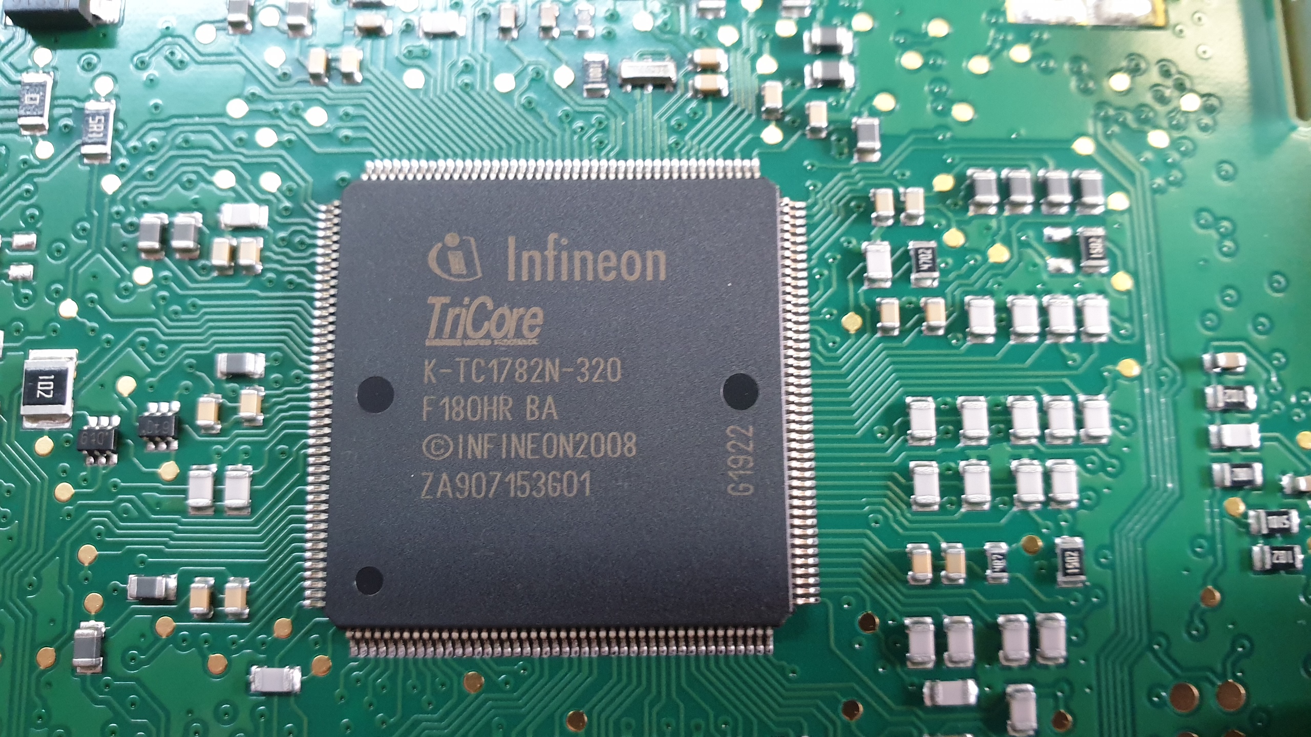

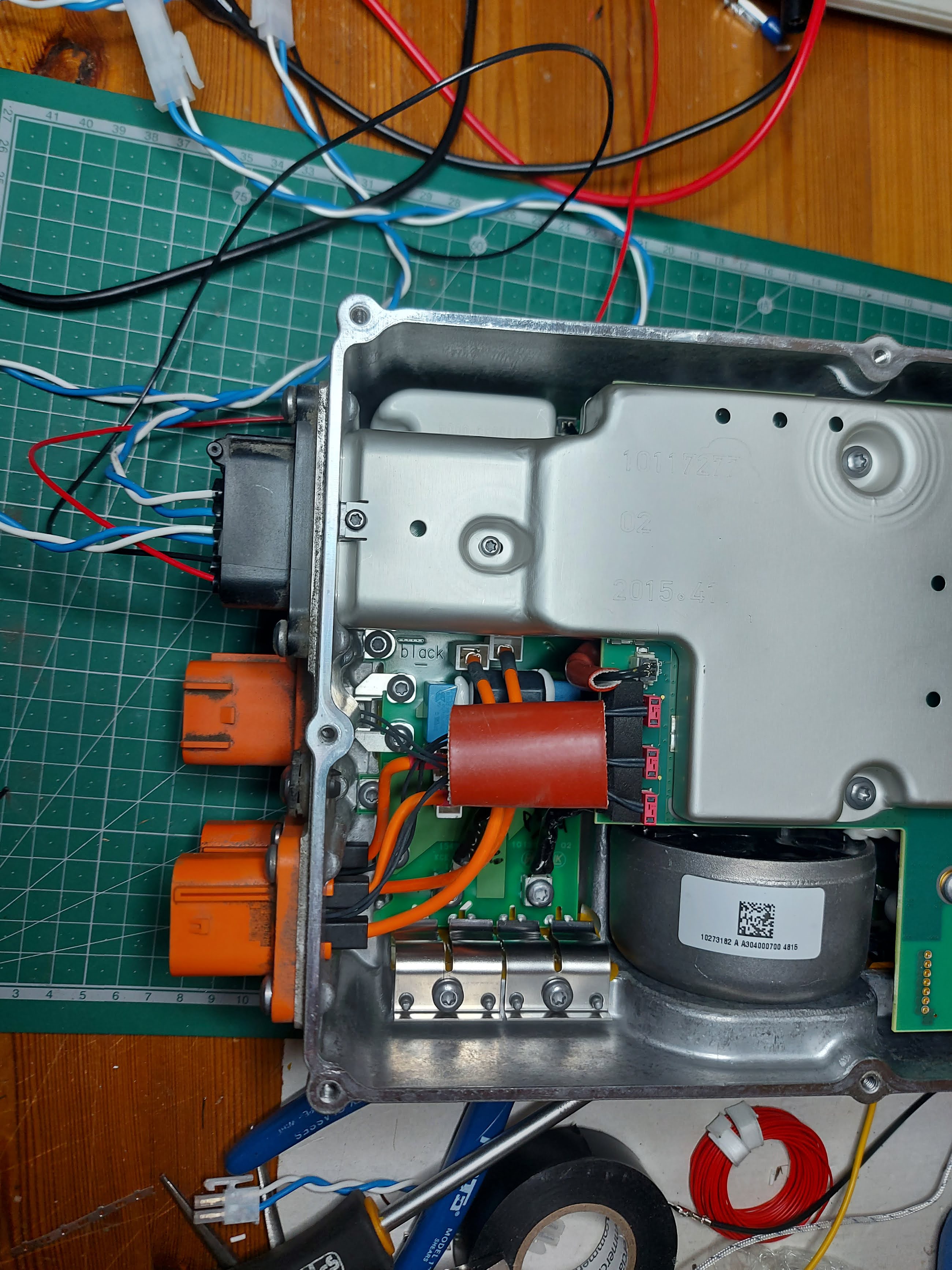

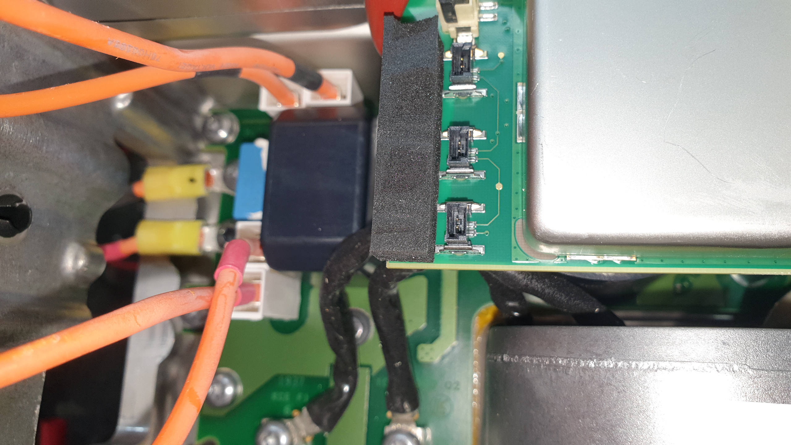

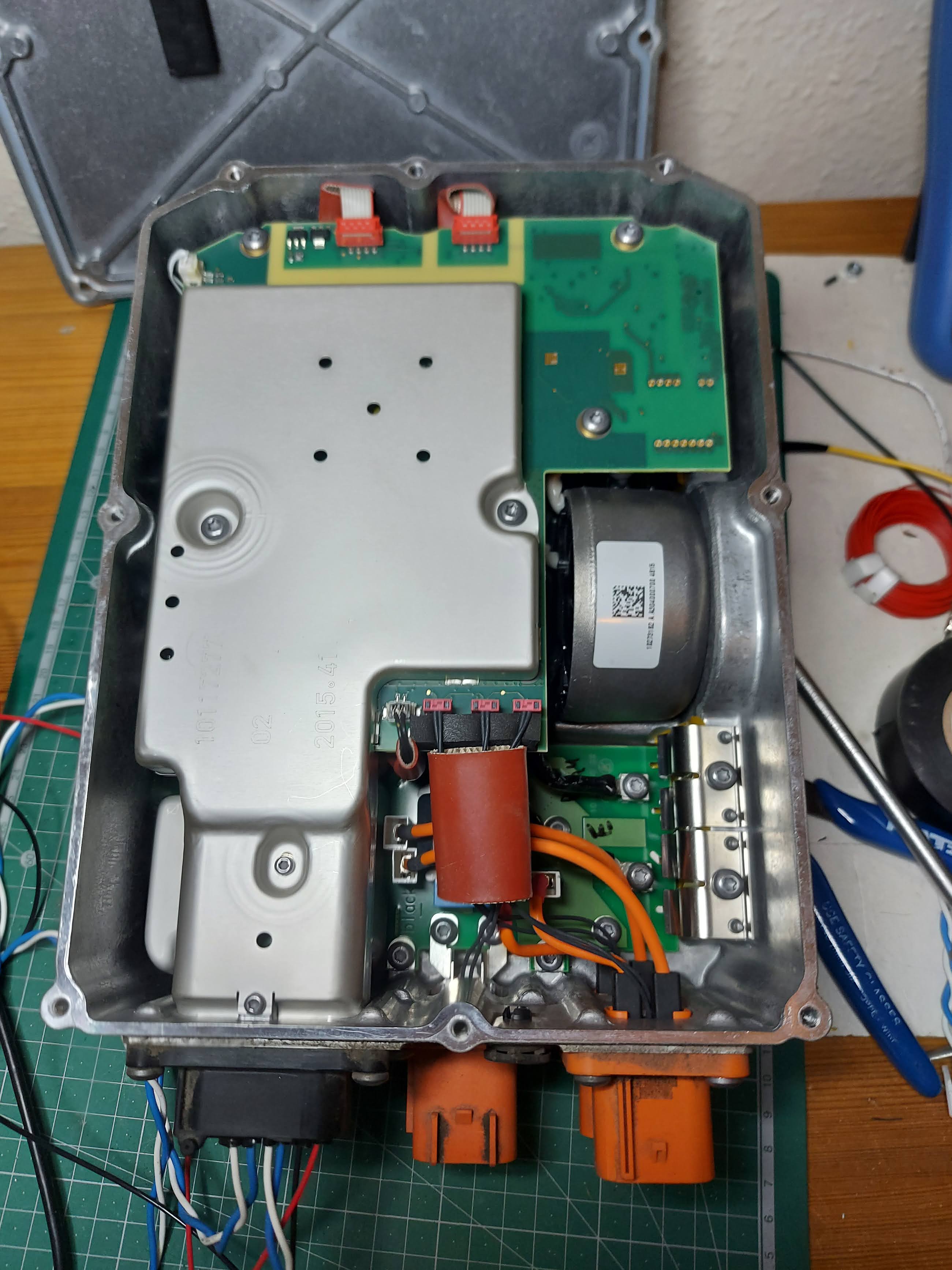

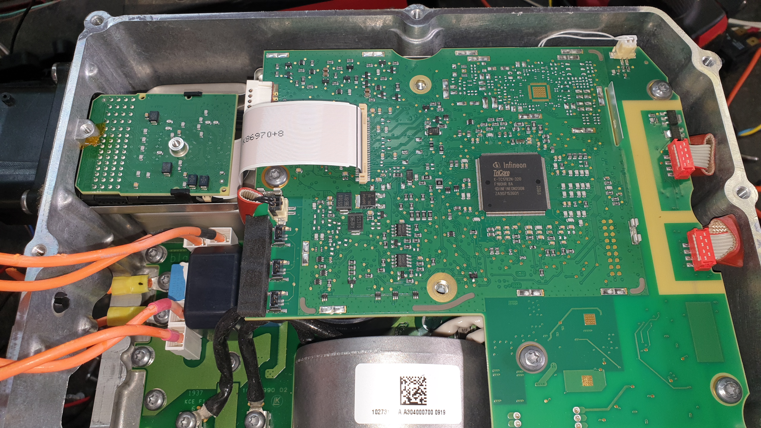

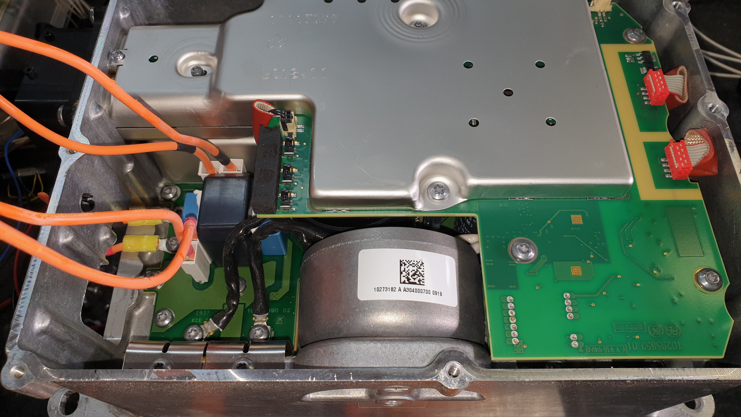

Cracked mine open for a few pics. At least this model can be opened. They welded the cover on the Mii version. Right to repair VW ??

So after a bit of digging we have some good news on the 60 pin data plug that seems common to all the chargers.
VW part number : 5Q0906379. Ordered from my local dealer for 21 Euros. Will have next week and confirm fit.
Its also available online e.g. https://parts.vw.com/p/Volkswagen__/Hou ... 06379.html

Very familiar insides.Jack Bauer wrote: ↑Fri Oct 28, 2022 11:08 am Cracked mine open for a few pics. At least this model can be opened. They welded the cover on the Mii version. Right to repair VW ??
Gotten the HV orientation and figured the ground pin on the AC input.
I have an variac coming and got a HV DC power supply that I will connect up to do more reverse engineering. If only I could find some more reverse engineering on canbus of a Golf-E or GTE then we can make sense of the logs.
Have you sent one of the DomT logs into the charger to see if it spits out other new ids?

Is this welded one (5QE915681BP) 2 or 3 phase? There is L1-N and L2-N sweeps on the github, in log there is 0x1BFE2208 which might be L3, but it have more zeros than others.
Oh wait, perhaps VW marking TypP072 mean 7.2kW (2ph) and as Jalovick mentioned TypP11 is 11kW (3ph).

Neither charger is 3 phase.
So the data connector uses 2 pin sizes. TE part numbers : 5-968221-1 and 1241608-6.
Both available on the usual suppliers like Mouser, RS etc and on Ali for much better prices.

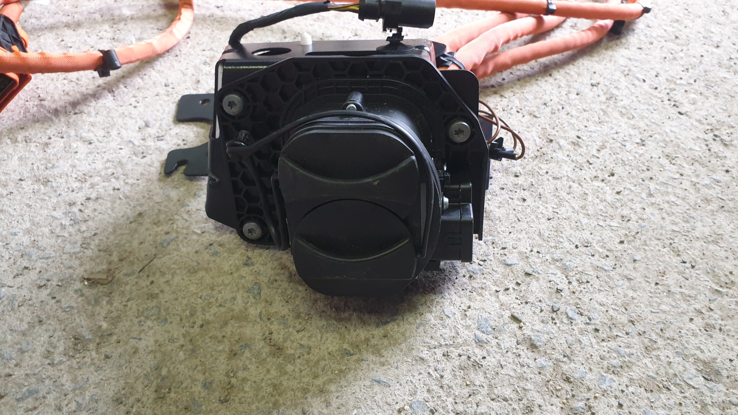

- Posts: 4000
- Been thanked: 1115 times
Re: MEB Chargers
Charge port temp sensor. While I dont have a Golf charge port I do have a loan of the CCS combo port from the Mii. Its AC temp sensor is reading 1067R at approx 15C ambient temp.
