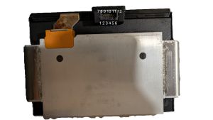

The Tesla Model 3 BMS controller
(Model 3 BATMAN details to be added)
It also has the compatibility with some MAX chip based battery modules. Tested with the Stellantis/PSA/Opel eCMP platform.

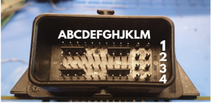

Pinout
1M : Permanent 12v via 2 Amp fuse
1L : Gnd
1K – CAN Low (different to github page)
1J – CAN High (different to github page)
1H – ISOSPI+ Model 3 bms daisy chain
1G – ISOSPI- Model 3 bms daisy chain
1F – Rx for Model S/X slave boards
1E – Tx for Model S/X slave boards
1D – 12v digital input 2
1C – 12v digital input 1
1B – Analog input (e.g. analog current sensor)
2M – Digital Out 2. Low side switch.
2L – Digital Out 1. Low side switch.
4M – 5V Output (e.g. Hall effect current sensor)
4M – 5V Ground.
4K - MAX TxP - RxP
4J - MAX TxN - RxN
4H - MAX RxP - TxP
4G - MAX RxN - TxN
