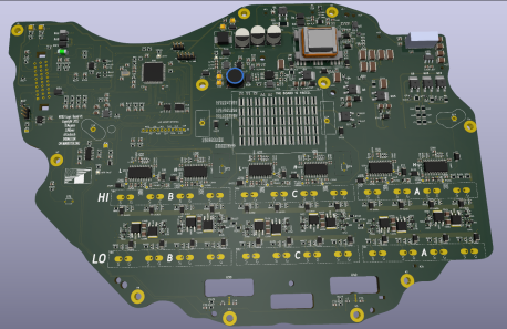

Open Source logic board for the Tesla Model 3 rear drive unit. Based on the inverter designed by Johannes Heubner using FOC control.
m3 inverter replacement pcb

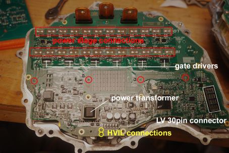

parts/ connections to salvage/ unsolder
the model 3 drive unit inverters feature a PCB with both HV and LV circuits, the gate drivers, and logic. thus a simple replacement brain board is not possible. canbus control is complicated and requires use of tesla's diagnostics software for inverter pairing. this is a legal greyzone and not a fully opensource option. Instead a full fledged replacement board with gate drivers was designed to allow full lobotomization of elon, thus gaining full opensource control of the model 3/y drive units!

parts needed to be fitted:
-current sensors: MLX91209LVA-CAA-002-SP (can be sourced from original board)
-gate drivers: STGAP1BSTR (can be sourced from original board)
-temp sensors: EPCOS : B57164K0473J000
-power transformer: VGT22EPC-200S6A12 (can be sourced from original board)
-30 pin connector + pins are a private stocked part, so must be salvaged from the original board
-30 pin mating connector: Sumitomo Original 6189-6987 61896987 https://www.aliexpress.com/item/1005005920568514.html

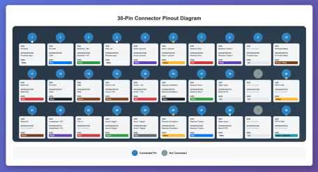

*the oem wiring harnesses used for the M3 motor are different through out the years in terms of color and some may be missing temp leads and other input of the same effect.
-11x torx T20 screws holding the board onto the case
-3x T10 securing the current sensor trim to the pcb
OR
- 2x T10 screws holding the pryofuse and current sensor trim
lv 30 pin connector pinout *note not all stock motor harnesses are the same, or use the same colors
