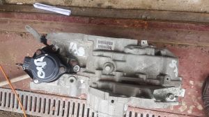

Gearbox

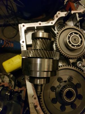

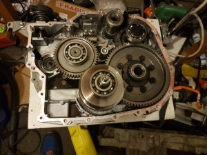

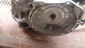

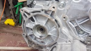

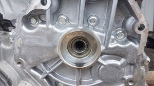

Inside the gearbox is pretty simple, there's a parking brake and some gears. The clutch requires some oil pressure before it can be electrically engaged, ideally we want to be able to do this at 0 rpm to be able the achieve maximum torque at launch.
The internal clutch that couples the 'generator' input to the half shaft outputs.
Outlander front gearbox.
Specs and Reduction Ratios
Parameter
Weight TBC
Motor - Differential ratio 9.663
Generator - Engine ratio 2.736
Engine - Differential ratio 3.425

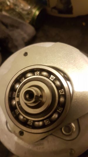

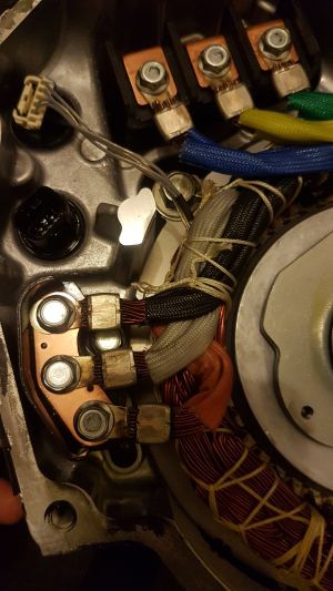

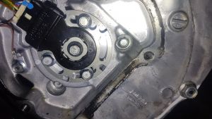

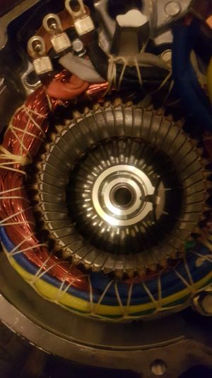

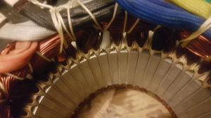

The 'generator'
It looks like this is the motor that is sold by SLEVB as https://www.secondlife-evbatteries.com/70kw-ev-motor-with-14000rpm.html
Interestingly they claim it as 70kW, where as the motor as 60kW, both weigh the same.

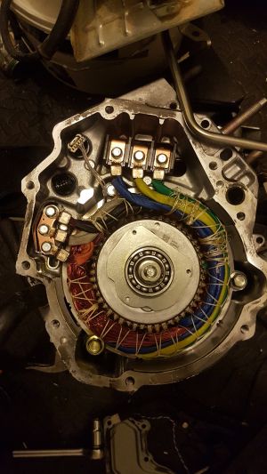

Specifications
Weight 29.5kg
Type Permanent Magnet Synchronous
Max RPM 14k (According to SLEVB)
Power 70Kw (According to SLEVB) but I suspect it's the same as the motor based on them weighing the same.
Manufacturer Meiden
Manufacturer Part
Suggested Firmware Use Field Orientated Control (FOC) firmware
Resolver Pole Count 8 (4 Pole Pairs) based on the assumption that it's the same as the motor below.

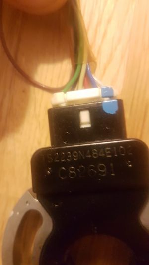

Resolver Part number C88691 / TS2239N484E102 (Tamagawa E102 series)
Looks to be a custom VR Type Resolver https://www.tamagawa-seiki.com/products/resolver-synchro/vr-type-resolver-singlsyn.html
Motor Pole Count 8 (4 Pole pairs)
Temperature Sensors This has 2 temperature sensors on 2 of the phase coils and also an oil temperature sensor.
Ld 0.1mH (used in the FOC firmware, Lq - Ld is a parameter)
Lq 0.3mH (used in the FOC firmware, Lq - Ld is a parameter)
Flux Linkage (used in the FOC firmware, is a parameter)
Critical Current (used in the FOC firmware, is a parameter)
Connector B-139
  • Pin 11 GTH1 - temperature in the U-phase coil (+ve)
  • Pin 12: GTH2 - temperature in the W-phase coil (+ve)
  • Pin 13: TH0 - oil temperature thermistor (+ve)
  • Pin 14: GTG1 - temperature in the U-phase coil (-ve)
  • Pin 15: GTG2 - temperature in the W-phase coil (-ve)
  • Pin 16: TG0 - oil temperature thermistor (-ve)
Connector B-140
  • Pin 1: R1 - the first connection for the exciter coil. If you have the original connector this has a black wire. It should be connected to the exciter - EXC - on your control board.
  • Pin 2: S1 - the first connector for output coil 1. (Red on the original loom. Connect to ENCODER CHAN A on your control board)
  • Pin 3: S2 - the first connector for output coil 2 (S2-1) (Yellow. Connect to ENCODER CHAN B)
  • Pin 4: R2 - the second connection for the exciter coil (White. Connect to GROUND)
  • Pin 5: S3 - the second connection for output coil 1 (S1-2) (Green. Connect to RESOLVER SIN)
  • Pin 6: S4 - the second connection for output coil 2 (S2-2) (Blue. Connect to RESOLVER COS)
  • Pin 7: GGND - earth connection to the ECU
  • Pin 8: Not used.
Note: some after market plugs have the pin numberings reversed from the above. As I currently understand it, the numbering should be as per the diagram with pin 8 at the bottom right with the locking clip on the top when you are looking at the cable end of the plug.

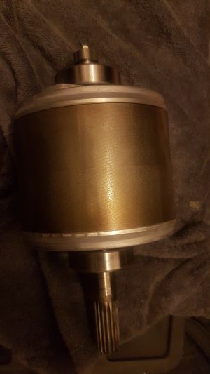

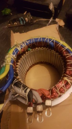

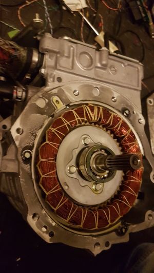

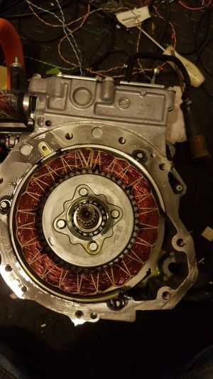

The motor
It looks like this is the motor that is sold by SLEVB as https://www.secondlife-evbatteries.com/meiden-ev-motor-60kw-14000rpm-electric-project-emrax-replacement.html
Specifications
Weight 29.5kg
Power 60Kw (According to SLEVB)
Manufacturer Meiden
Manufacturer Part S61

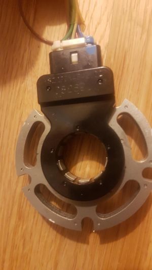

Resolver Pole Count 4 Pole Pairs based on the photo below, the shaft having 4 lobes.
Tamagawa will not release the datasheet for this unit. "Unfortunately, this is an exclusive model for our authorized customer.
We are not able to provide technical data directly to you."
Temperature Sensor This only have the 2 phase coil sensors and is lacking the oil temperature sensor.

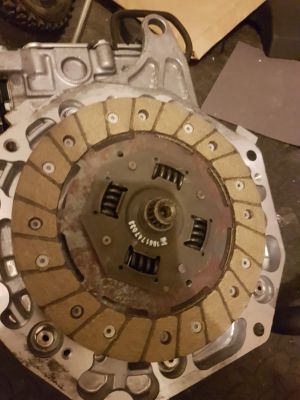

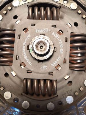

Output Shafts
The generator and motor have a 19mm output shaft with 17 splines. This is a very close fit for the Ford Fiesta clutch. Model number 8V21-7550-DE or G44BA. Another part number also fits HD2392 from Fiesta 77-92, Escort III
User @bexander points to https://aftermarket.zf.com/go/en/sachs/catalogs/#/ which shows that this fitting is common to a wide range of Ford and Mazda part numbers.
FORD
1518195, 1529952, 1576249, 1678827, 1708209, 1804545, 1805271, 1826509, 1852056, 2115219, 2245763, 8V21-7540-DA, 8V21-7540-DB, 8V21-7540-DC, 8V21-7540-DD, 8V21-7540-DE, 8V21-7540-DF, 8V21-7540-DG, 8V21-7540-FA, 8V21-7550-DE, 8V21-7563-DD, RM8V21-7540-DF, RM8V21-7540-DG, RM8V21-7540-FA
MAZDA
Y604-16-490, Y604-16-490A, Y604-16-490B, Y604-16-490C, Y604-16-490D, Y604-16-490E
