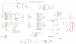

Schematic

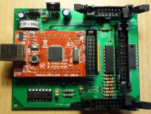

The main board is the heart of the inverter system. It contains all the intelligence that is needed to convert the users inputs into motor shaft movement. It also contains all the protection circuitry to avoid damage in case of errornous inputs.
Its distinct features are:

Analog Inputs and over-current protection
There are 3 external analog inputs on JP5.
  1. Throttle input, 0-3.3V (Pin 6). Cutoff frequency 16Hz, input resistance 10k.
  2. Regen pot input, 0-3.3V (Pin 8). Cutoff frequency 16Hz, input resistance 10k.
  3. KTY83 temperature sensor input (Pin 22 positive, Pin 21 negative). Cutoff frequency 16Hz
There are 4 internal analog inputs on JP4. Pins 5,7 and 10 provide a GND connection, Pin 8,11 and 12 provide stablelized 5V.
  1. Udc (Pin 4) Bus voltage input. 0-3.3V, cutoff frequency 16Hz
  2. Il1 (Pin 6) Current phase 1. 0V=-Imax, 1.67V=0A, 3.3V=Imax (software configurable). Cutoff frequency 48kHz.
  3. Il2 (Pin 9)
  4. Heatsink temperature (Pin 13)
The two current sensors are used for the programmable hardware over-current protection. A trip limit can be programmed that configures a hardware comparator. When the given current limit is hit, the PWM signals will be shut down without software interaction.

Communication
JP6 provides a TTL level (3.3V) UART interface. It can be directly connected to the provided TTLUSB adapter. Pin 1 provides the 3.3V net of the Olimex board. It can be used to power the board or to power an external module like a ZigBee or bluetooth transceiver. 100mA should not be exceeded. Pin 2 is TX, Pin 3 is RX and Pin 4 (next to the inductor) is GND.
The communication parameters are fixed to 115200 8N2 (2 stop bits!).
There is a CAN interface on JP5. Pin 25 is CANL, Pin 26 is CANH
Power input
The main board contains a regulated buck converter to power all of its components. The allowed input voltage is 7-26V.
