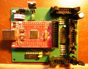

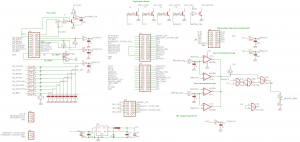

Main Board Version 1
Main board
Main board
Main board
The main board is the heart of the inverter system. It contains all the intelligence that is needed to convert the users inputs into motor shaft movement. It also contains all the protection circuitry to avoid damage in case of errornous inputs.

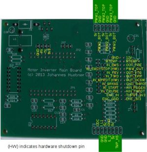

Pin Header Summary
Pin Header JP5
Pin Name
1 GND
2 30mA output for IR diode
3 Encoder input
4 3.3V
5 Cruise Control Input (12V)
6 Throttle Input (0-3.3V)
7 Start input (12V)
8 Regen Pot Input (0-3.3V)
9 Brake Input (12V)
10 GND
11 Motor Protection Switch (12V, PWM inhibit when low)
12 DC contactor output (open collector 3A)
13 Forward (12V)
14 Error Signal (open collector 3A)
15 Reverse (12V)
16 Over/Under Voltage (open collector 3A)
17 Emergency Stop (12V, PWM inhibit when low)
18 Temperature PWM output (open collector 100mA)
19 BMS Over/Under Voltage input (12V)
20 Precharge Output (open collector 2A)
21 Motor Temperature Input -
22 Motor Temperature Input +
23 GND
24 Vcc (7-26V)
