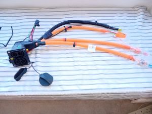

The MG5 uses a combined Type 2 - CCS2 charge port. The charge port is of fairly basic design.
The HV cables exit sideways to give a reasonably slimline (<120mm) profile
Charge port locking is implemented with the usual 12V actuator, polarity of wires is reversed to unlock. There is a manual pull cable override.
There are 4 temperature sensors, one each of +ve and -ve pins for AC (Type2) and DC (CCS) connections.
The sensors are of NTC type, esitmated to be NTC100K - measured resistance 107kOhm at room temp.[1]
The are no LEDs for lighting nor charge status indications.
Printing on the port specifies DC Max 200A, 750V; AC 32A, 250V. This is consistent with the MG5s max. charging speed of 80kw (400V).

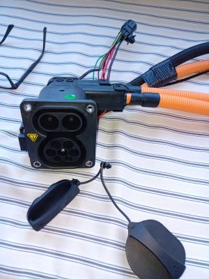

Connectors
- Low Volatge : 18-pin Sumitomo 6188-5910 [2] (6188-5911 to mate)
- AC : 4-in Yonggui YGC1174-EV-S - Unobtainium? (YGC1174-EV-S(3+2)P to mate, as found on MG Gen2 OBC)
- DC HV : Spade/M8 type connector.
Pin Out
| Pin | Wire Colour | Description |
| 1 | Red | Charge Port Motor Lock+ |
| 2 | Black | Charge Port Motor Lock- |
| 3 | Green | Charge Port Lock feedback - connects to pin 4 when locked. |
| 4 | Yellow | Charge Port Lock feedback - connects to pin 3 when locked. |
| 5 | Red | PP ProximityPilot |
| 6 | Red | Temp sensor Type2 AC +ve Pin temp (pair with pin 7) NTC100k |
| 7 | Red | Temp sensor Type2 AC +ve Pin temp (pair with pin 6) NTC100k |
| 8 | Black | Temp sensor Type2 AC -ve Pin temp (pair with pin 9) NTC100k |
| 9 | Black | Temp sensor Type2 AC -ve Pin temp (pair with pin 8) NTC100k |
| 10 | Brown | CP ControlPilot |
| 11 | Green | AC Earth |
| 12 | - | Not populated |
| 13 | - | Not populated |
| 14 | - | Not populated |
| 15 | Red | Temp sensor CCS +ve Pin temp (pair with pin 16) NTC100k |
| 16 | Red | Temp sensor CCS +ve Pin temp (pair with pin 15) NTC100k |
| 17 | Black | Temp sensor CCS -ve Pin temp (pair with pin 18) NTC100k |
| 18 | Black | Temp sensor CCS -ve Pin temp (pair with pin 17) NTC100k |
