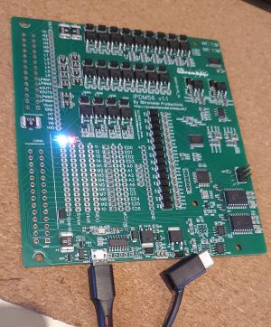

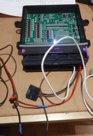

Connect the board to USB and power it up
This is a sanity check before you start soldering and chase your tail troubleshooting.
Use a good quality micro USB cable and power the board up through it via a charger or computer.

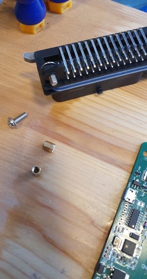

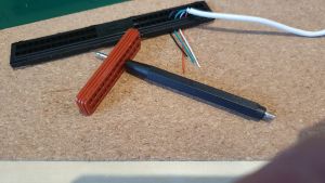

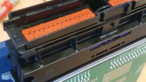

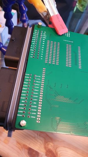

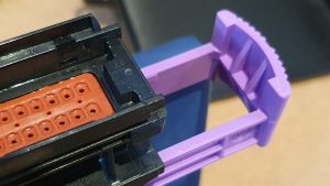

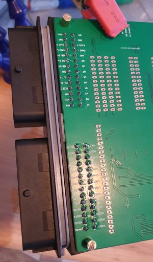

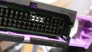

Solder the connector onto the board

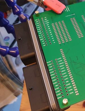

Before you start soldering, test fit the PCB to see if the remaining holes line up with the threaded mounts of the enclosure.
Apart from soldering equipment you will need two small screws and nuts to secure the 56 pin header connector to the PCB so it is secured during soldering.

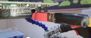

If you're in a rush, you should alternate between the two sections to avoid overheating the board and reduce stresses on the joints.

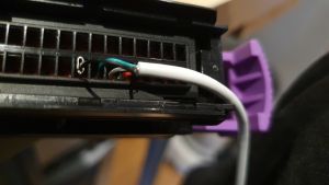

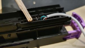

Wiring in the pins
(starting with the USB connection)
For powering the board from 12V DC it makes sense to use either Pin 3 or 4 for ground but only Pin 2 for +12V. Pin 1 was +Vbat on V1.0, it's M11 on V1.1. An automotive fuse is recommended.
If you want to use high side outputs, you have wire the supply into Pins 55, 56 and 33 for HOUT 1-9.

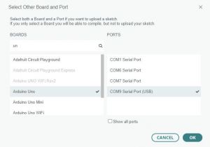

First program - blink LEDs off board
Set up the Arduino IDE. The ATMega 328 is also used on Arduino UNO, Arduino Pro Mini and Arduino Nano, so programming should be familiar. See https://docs.arduino.cc/hardware/uno-rev3 for some tips.
As the iPDM56 uses a CH340G USB-to-serial converter, the choice of bootloader will be ignored, just choose the correct serial port & Arduino Uno.

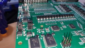

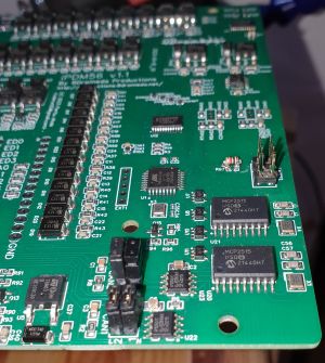

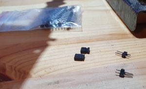

A CAN bus needs to be terminated on each end and the iPDM56 gives you the flexibility to terminate either CAN1 and/or CAN2 with jumpers. We need 4 pins and 2 jumpers (e.g. from a PC mainboard) each and something to hold them in place while soldering - I used a third hand, but tape should work, too.
Pre-assemble the jumpers and pins to ensure proper fitting, then solder the pins in.

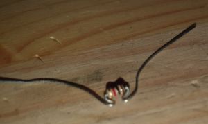

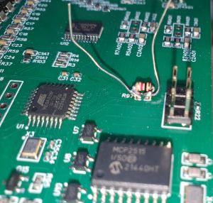

If you have v1.1 of the iPDM56, as per https://github.com/celeron55/ipdm56/tree/master/ipdmhw1.1, R97 needs to be replaced with a 1k resistor or CAN won't work. The existing SMD one can easily be "wiped off" with the soldering iron. I bent a through-hole version to fit as we're already soldering. Leaving the leads on until last allows you to check if the connection is solid.
