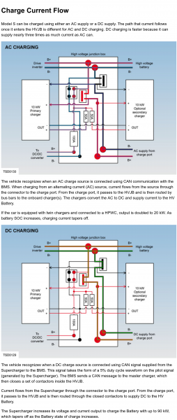

Tesla Model S GEN1 Rear HVJB operating prinicple, from early Tesla Model S Service Manual, Theory of Operation Guide.
