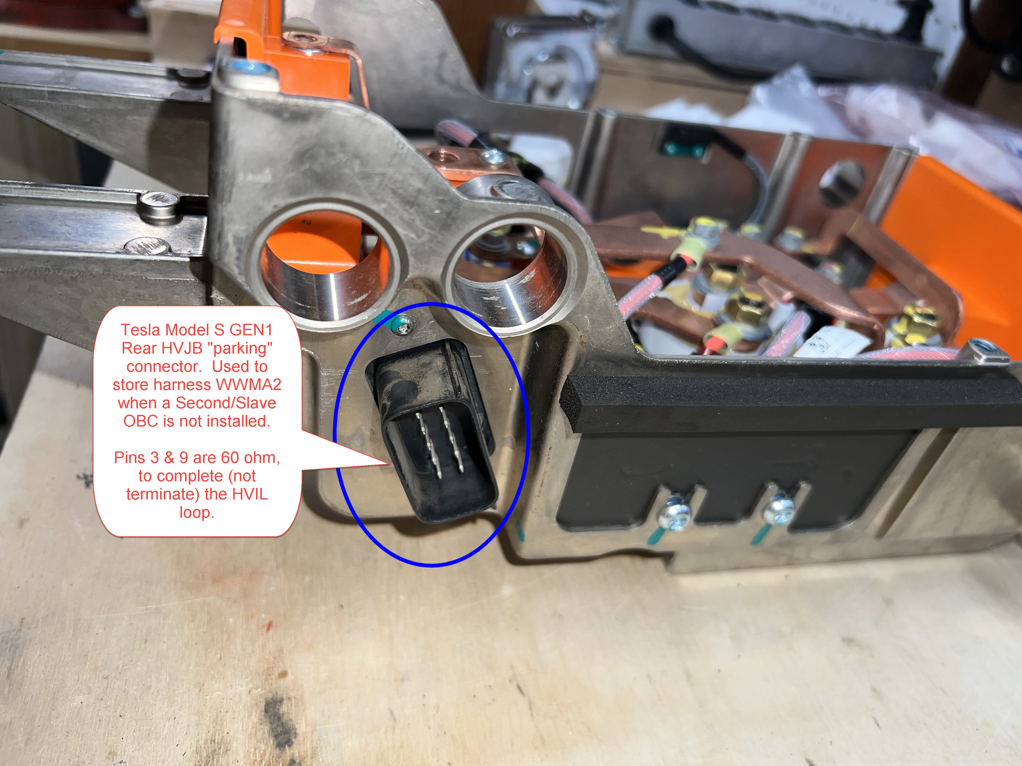

Telsa Model S GEN1 Rear HVJB: harness WWMA2 "parking" connector which contains only a 60 ohm resistor. This connector is used when a Tesla does not have a Second/Slave OBC.
