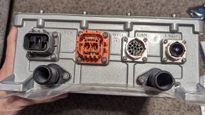

Terminal crimps
High voltage DC connector: AMP MCP 6.3/4.8K, CONTACT, SWS, part number 1241418-4, 10awg wire
High voltage AC connector (charge port): Identical to the HVDC, AMP MCP 6.3/4.8K, CONTACT, SWS, part number 1241418-4, 10awg wire
12v DCDC positive connection: Standard Circular Contacts Socket Contact, Machined, Crimp Barrel, Radsok, Size 6mm, Silver, Wire Range 20-25mm2, 4AWG, part number HS25BCS, 4awg wire
Low voltage signal connection: Standard Circular Contacts ECO MATE-RM, AQUARIUS , part number MS20M23F, 22awg wire

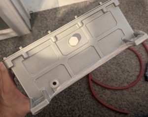

Rear Ground lug: M8 bolt, roughly equivalent to SAE 5/16ths unknown thread pitch
Connectors
Pin out connections
Documentation for the chargers includes detailed pin out instructions, and they're identical between the cascadia and dilong versions, with one exception
If sourced from dilong, use the dilong low voltage connector pinout:
A: CAN Bus High B: BMS/VCU Power positive, 12V+ when AC power is applied C: BMS/VCU Power negative, 12V- E: HVIL interlock 1 F: HVIL interlock 2 G: CAN Bus Low T: Power for DC/DC Converter logic, apply 9 to 16V to power internal logic S: Enable for DC/DC Converter, apply 9to 16V to enable. This is OR’d with the CAN Enable Command.
The cascadia version pinout is slightly different
