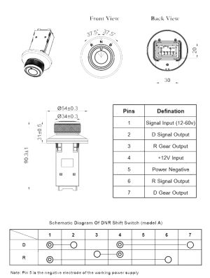

DNR Reverse Forward Switch Parking Gear Shift
DNR Model A Reverse Forward Switch Parking Gear Shift

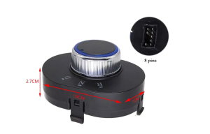

A complete directional switch with indication available on Aliexpress.
There is a schematic/connection table is in last pic of my previous post :)
Drive outputs pin 2 & 7
Reverse outputs pin 3 & 6
pins 3 & 7 output +12v
Pins 2 & 6 output whatever you feed to pin 1.

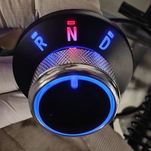

LEDs are not controllable separately, they switch color depending on selector position.
This looks to me like it is a mechanical rocker switch with rocker covered with a knob, so nothing fancy in that sense :)
There are two possible outputs for both D & R.
One is positive (connected to the +12v supply, which also powers the leds) and the other output is dependent on the pin 1 connection.
If pin 1 is not connected, you don't get an output from the pins defined as signal outputs.

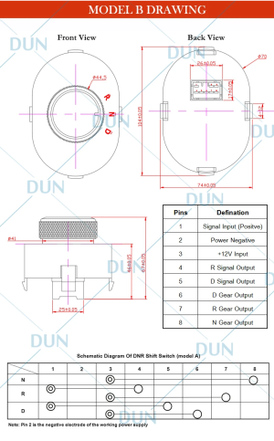

DNR Model B Reverse Forward Switch Parking Gear Shift
Warning Model B pinout schematic is not the same as Model A! See schematic for connection.

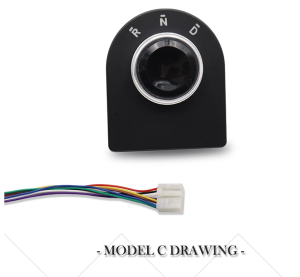

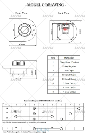

DNR Model C Reverse Forward Switch Parking Gear Shift
Warning Model C pinout schematic is not the same as Model A! See schematic for connection.
