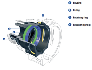

Quick Connect Coolant Fittings Info
Norma Quick Fitting
https://www.norma-connects.com/sites/dsemea/files/qbank/documents/NORMA-Quick-Connectors-Catalogue.pdf
