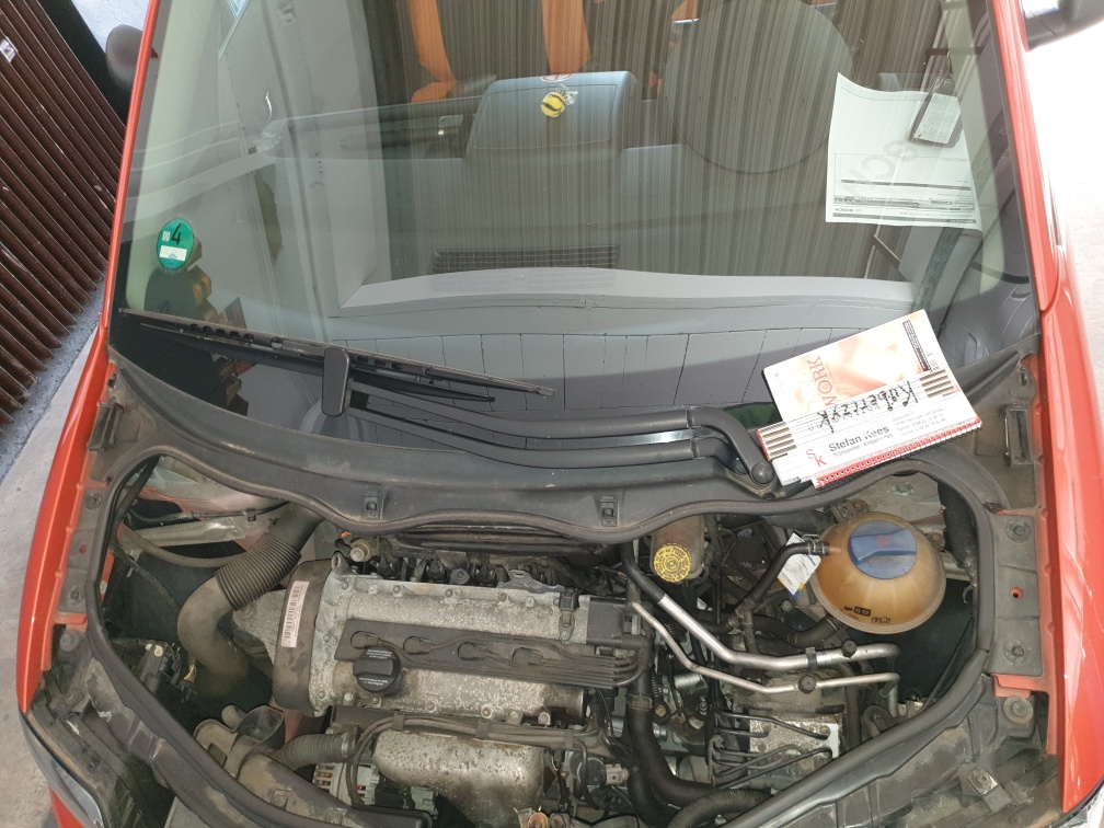

A friend of mine will attempt to convert his Audi A2.

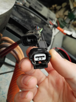

As recommended by Arber I bought a Renault Twizy Motor for him. It is rated at 12kW but apparently, by raising voltage and current can easily do 40kW. Unfortunately the motor does not have a front bearing, so mounting it to the transmission will be a bit more challenging. The output shaft is rather short, it does not stand out from the motor case. It has inner splines, 19 of them. Might be easier to add a key to the shaft?
Connectorwise it has two KTY84 sensors and a quadrature encoder. Pretty standard, runs off 5V and needs pull-up. Anyone know the part number of these connectors? I have hooked up the motor to a Gen2 Prius inverter that Damien donated a while ago. It does run though the inverter still behaves rather unique: Small sine amplitudes are not transmitted from gate drive input to IGBT output! So say at 24V if you swing 6000 digits all outputs sit at 50/50 dutycycle. Once you pass 7000 digits it starts to swing as intended. I hope that behaviour is less pronounced at higher DC voltage.

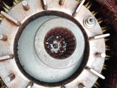

Well i didnt know about the bearing fact. Sorry. I can ask a friend who used that motor to convert his Fiat Punto. How did he do it. Since his punto is operational still. Marjan Bozic, you have met him in Slovenia last time.

All this conversion have in common that there were debates what to do with the axial load from the clutch. It can be like 40kg load when shifting etc... My first reaction was then you simply not use the clutch and shift like i do here... https://mazdamx3ev.wordpress.com/2018/0 ... lopka-ven/
The motor i was discussing has two ball bearings and they support weight of the shaft radially, but that kind of bearing also supports some load from the axial side. So it should not be a problem to ask a machinist to get you bearings with good seat to ward of some axial loads.
Did you dissassemble the motor yet? Can you send me some photo of bearing retention system in the front?
I also asked some of those cars drivers and their reply was to just use the plate on transmission housing and mount the motor to it. No bearing needs to be adapted. Make good effort to allign the center, but really clutch remains.
