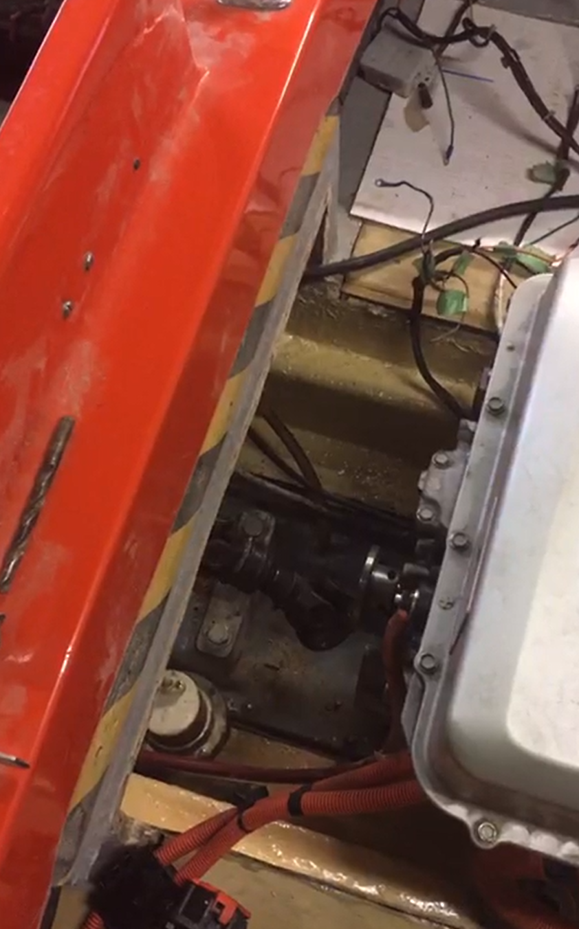

We have a jet boat powered by the Niassan Leaf 2 gen motor, inverter, charger, and 24KWt battery. The whole system runs from ZombieVerter on my own PCB design, with the latest firmware downloaded from GitHub.
If the motor is disconnected from the jet, it can reach 10.5K revs without any problem. But connected to the jet on the water, it is limited to about 2500 revs, and from about 2300 revs it starts wobbling.
I wonder what is causing the problem? My vision is that the water is not providing enough load or unbalanced coupler to the jet.
What do you think?
The motor is connected to the jet through the cardan, about 30cm long.

On top of Tom's ask, is it a single cardan joint? What's the angle it's running at?

jrbe wrote: Mon May 26, 2025 3:47 pm On top of Tom's ask, is it a single cardan joint? What's the angle it's running at?
It has two cardan joints, each end of the shaft. It has no angle between the jet and the motor, and about 5 degrees between the whole system to the floor

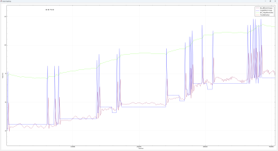

The boat is stored far from my current location, but I have a few logs with some parameters.
I've configured just the pots parameters, udcmin=330 and switched CAN bus and Leaf units, car set to none.
The temperature was about 15-16 Celsius. I've started from 2 pots, tried 1 and had 100 revs higher, but wobbling as well.

vitecd wrote: Wed Jun 25, 2025 5:27 am Joint been balanced. Today we have a ride on the river, not much changed, same shaking/limitation around 2300 revs. Rotation by hand not a problem
-How have you implementes the motor side driveshaft flange?
-Support bearings?
-Have you aligned the forks of the driveshaft?

I used part of the original reducer, but there was only one gear left. A hole was made, and a shaft was extended.
Without Jet connected, the motor is doing 10000 revs smoothly.

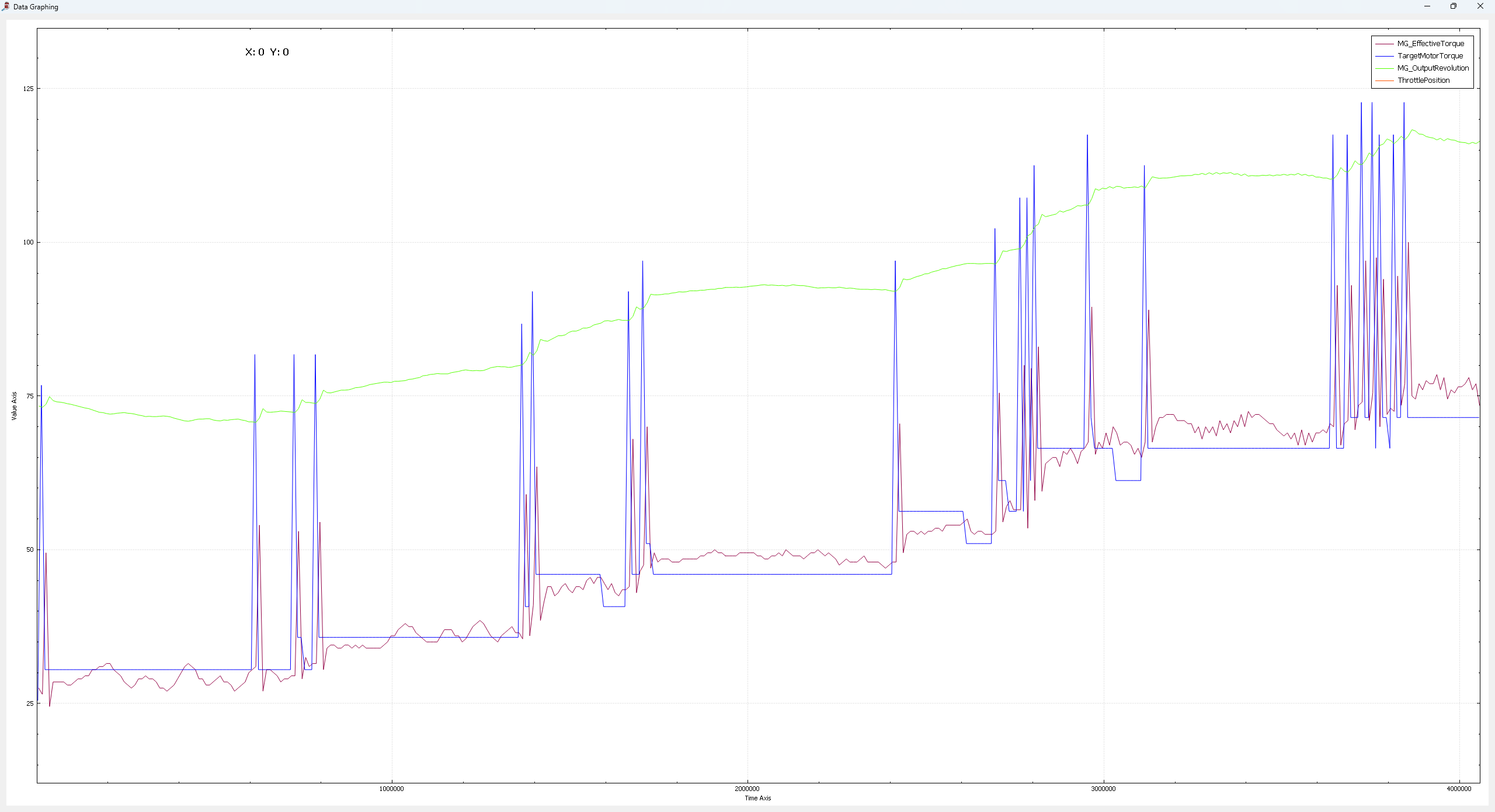

Not sure if it's meaning anything
revs .05 scale, 2300 max

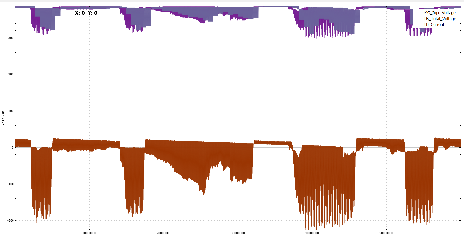

We will need logs of Potnom from zombie will doing this, there may be things limiting the torque request as its not flat out.
Edit your issue is: "udcmin": 360
This is limiting throttle, this should be shown by zombieverter and the potnom spotvalue
This is high for a 96s battery, change it to like 3.2 x 96 = 307V

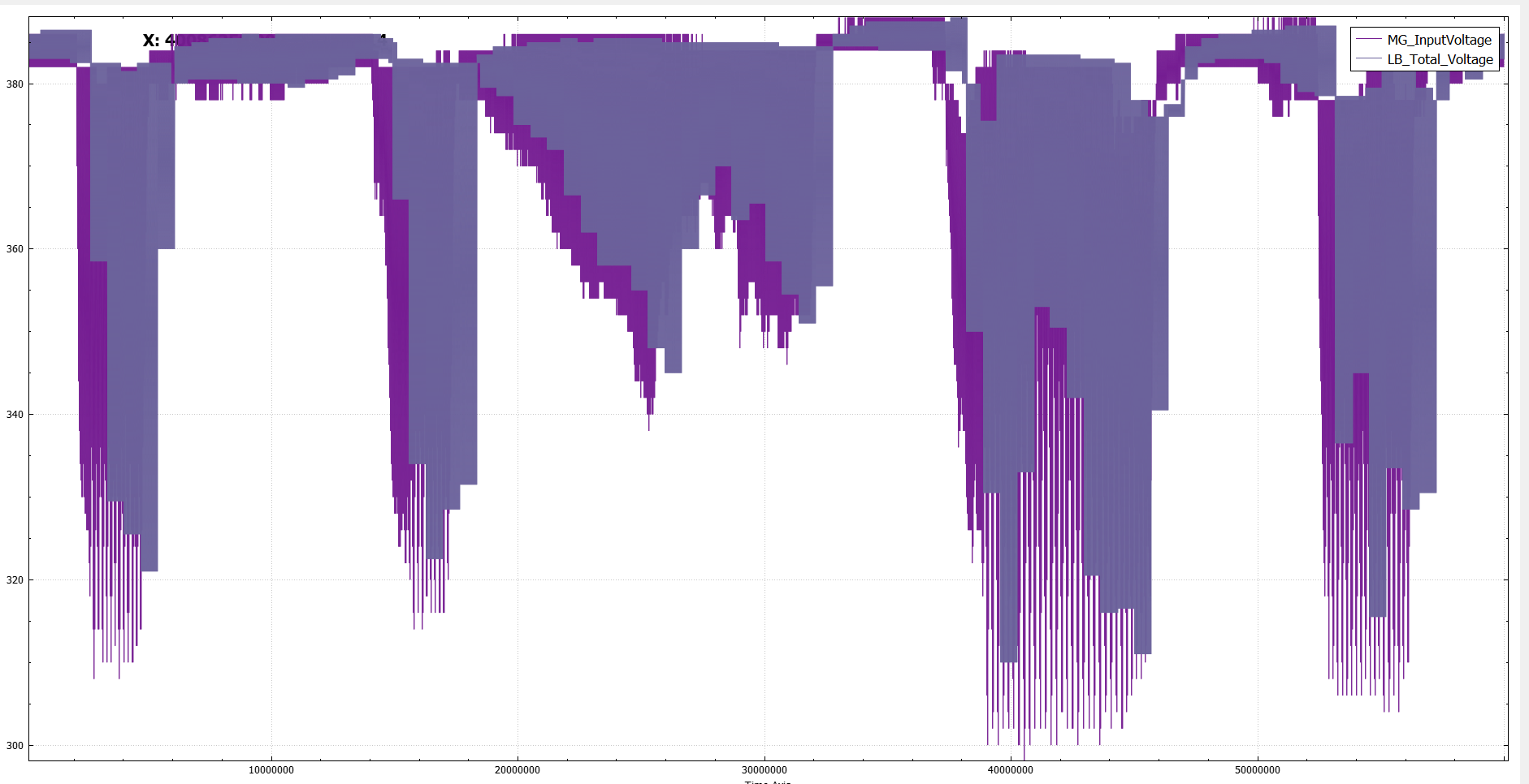

vitecd wrote: Thu Jun 26, 2025 2:34 am Without Jet, the motor spins 10000revs easily and smoothly.
Without load vs with load
Your CAN logs show the battery sagging down and thus the udcmin limiter kicking in, it kicks in before hitting udcmin as not to have an abrupt stop of of torque

You have a major problem in your High Voltage wiring or a really shit battery.
You running straight connection right, you do not have a resistor in series with your battery?
80V drop at 200A is ALOT

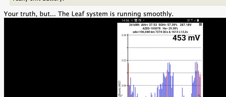

tom91 wrote: Sat Jul 12, 2025 10:15 am really shit battery.
Your truth, but... The Leaf system is running smoothly.

So you what you are seeing is the battery sagging 80V and the zombieverter forcing a derate. You could tune it by allowing less max throttle and decreasing throttle ramps to have less oscillation under heavy load.
vitecd wrote: Sun Jul 13, 2025 7:31 amYour truth
The truth, the battery is not capable of providing the power being requested from the leaf inverter. The zombie reactes based on feedback and not based on limit mapping unless you set it up.

My original problem was motor wobbling and not reaching top revs. From the logs, we can see that the torque request is jumping up and down. Can anyone guess why? I've checked the logs from the boat, and the HV drops down just a few volts; it's not the case.

vitecd wrote: Sun Jul 13, 2025 7:31 am Your truth, but... The Leaf system is running smoothly.
Smoothly?
A 400+ mV delta does sound like a weak pack or at least weak cell to me.
But if you are seeing a voltage sag of 80V at 300V that is not good.
Then you are allowing the inverter to draw way to much current.
So allow less current out and reduce the torque and current ramp up.
The power power you draw, the more voltage sag you will see. As Tom said.
