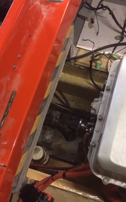

We have a jet boat powered by the Niassan Leaf 2 gen motor, inverter, charger, and 24KWt battery. The whole system runs from ZombieVerter on my own PCB design, with the latest firmware downloaded from GitHub.
If the motor is disconnected from the jet, it can reach 10.5K revs without any problem. But connected to the jet on the water, it is limited to about 2500 revs, and from about 2300 revs it starts wobbling.
I wonder what is causing the problem? My vision is that the water is not providing enough load or unbalanced coupler to the jet.
What do you think?
The motor is connected to the jet through the cardan, about 30cm long.

Joint been balanced. Today we have a ride on the river, not much changed, same shaking/limitation around 2300 revs. Rotation by hand not a problem

vitecd wrote: Wed Jun 25, 2025 5:27 am Joint been balanced. Today we have a ride on the river, not much changed, same shaking/limitation around 2300 revs. Rotation by hand not a problem
-How have you implementes the motor side driveshaft flange?
-Support bearings?
-Have you aligned the forks of the driveshaft?
vitecd
Posts: 11
Joined: Thu Jul 18, 2024 1:42 am
Location: NZ
Has thanked: 9 times
Re: Nissan Leaf Stack not getting revs underload
Post by vitecd »
I used part of the original reducer, but there was only one gear left. A hole was made, and a shaft was extended.
Without Jet connected, the motor is doing 10000 revs smoothly.

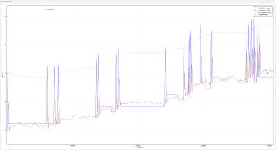

Not sure if it's meaning anything
revs .05 scale, 2300 max
We will need logs of Potnom from zombie will doing this, there may be things limiting the torque request as its not flat out.
Edit your issue is: "udcmin": 360
This is limiting throttle, this should be shown by zombieverter and the potnom spotvalue
This is high for a 96s battery, change it to like 3.2 x 96 = 307V

vitecd wrote: Thu Jun 26, 2025 2:34 am Without Jet, the motor spins 10000revs easily and smoothly.
Without load vs with load
Your CAN logs show the battery sagging down and thus the udcmin limiter kicking in, it kicks in before hitting udcmin as not to have an abrupt stop of of torque
