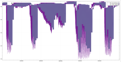

Some updates and questions. I've assembled... or reconnected?! another test bench, it is Nissan Leaf powered by ZombieVerter. During the connection testing, I mentioned two issues:
1. After PrechargeFail, negative contactor stays ON
2. After Power ON, PRECHARGE contactors stays ON.
Is it okay?

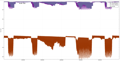

Logs and settings attached. The system keeps jumping, around 3800revs
leaf.7z
(1010.26 KiB) Downloaded 4 times
log (13).csv
(5.02 KiB) Downloaded 4 times
log (14).csv
(2.84 KiB) Downloaded 3 times
params (4).json
(2.14 KiB) Downloaded 3 times
Posts: 2446
Location: Bristol
Has thanked: 215 times
Been thanked: 600 times
Re: Nissan Leaf Stack not getting revs underload
You have a major problem in your High Voltage wiring or a really shit battery.
You running straight connection right, you do not have a resistor in series with your battery?
80V drop at 200A is ALOT
