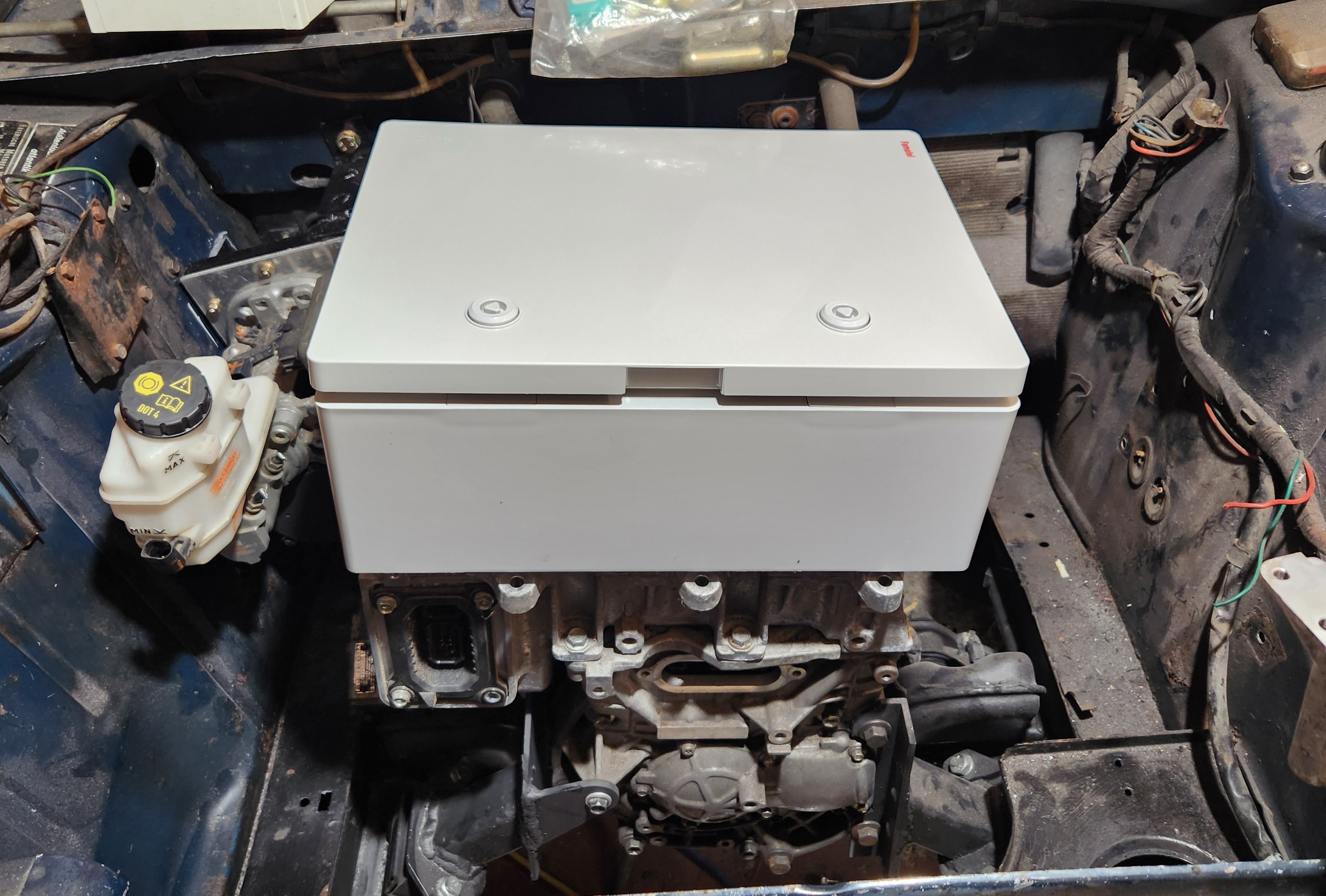

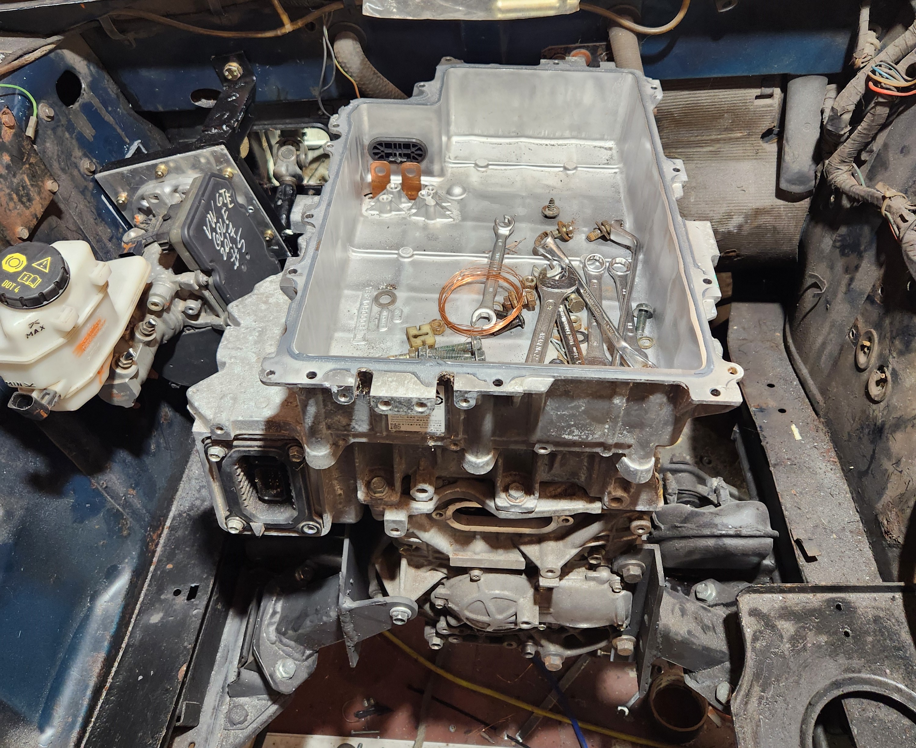

So I at a point where I would like to start on the HV junction contactor box.
I have tried looking through the posts for layout ideas, not having much luck.
Can you post a pic of your HV junction contactor box in your build.
I have a blank canvas now so want to get it right .
My setup is/will be a Leaf EM57 with invertor.
Leaf contactor box
Zombie
ISA shunt
Outlander charger ( position not decided yet , may go under back seat or boot area)
still have to make battery boxes
I bought a Industrial connection box, But it too big
I also have the base (has been stripped apart) of the leaf PDM , though have to make a Perspex/Ali lid for it.
Leaf contactor box
Zombie
ISA shunt

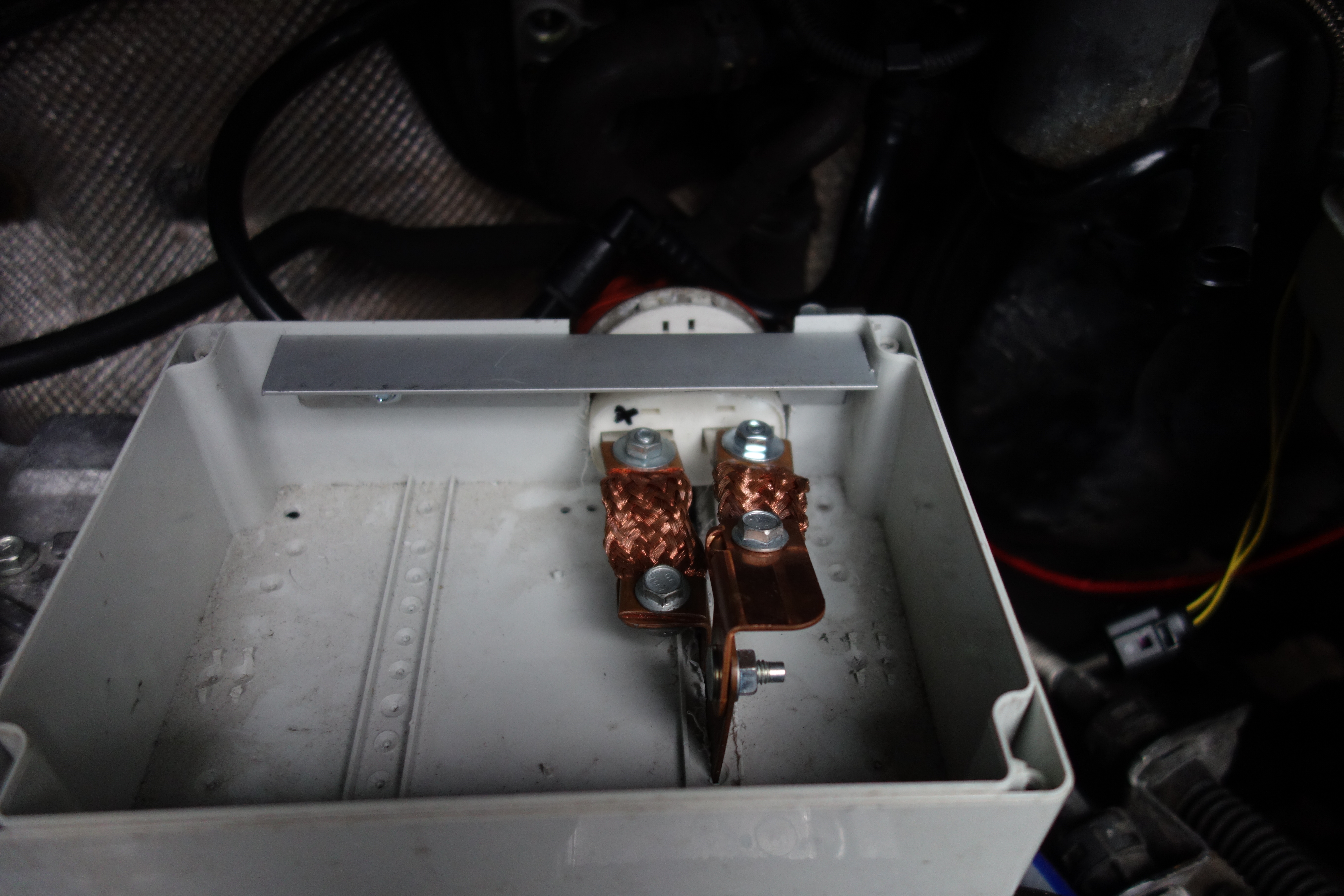

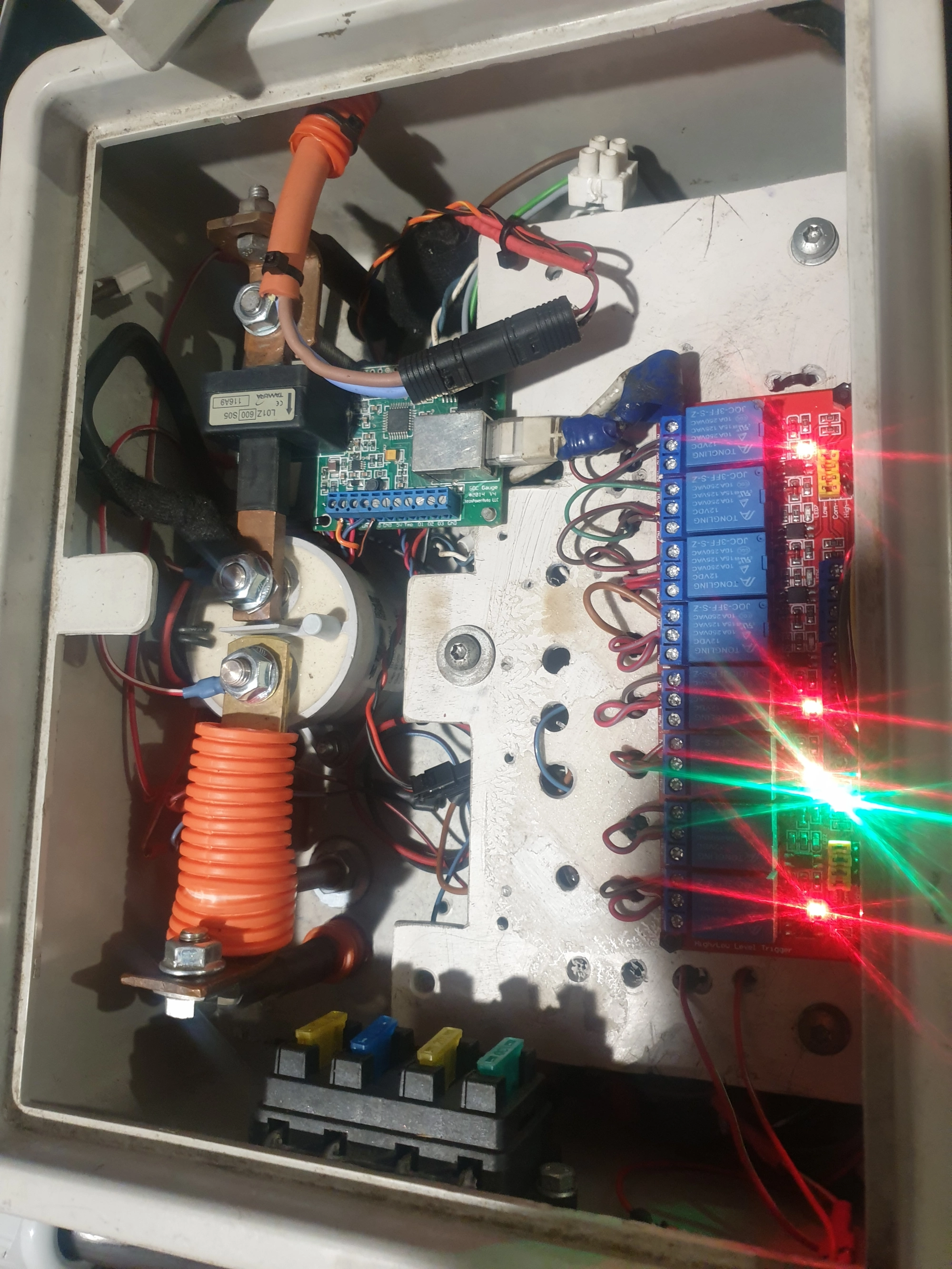

The "new" HV / relay box in Mazda MX-3 redesign
Be advised some of the OPs here advised me to redesign the threaded studs that support the copper bars because they protrude out under the box. I tend to agree with them as in the prospect of accident you could end up with HV+ on the car chassis.
Should be redesigned using those rubber sealant blocks with M8 studs.
https://mazdamx3ev.wordpress.com/2024/0 ... ntact-box/

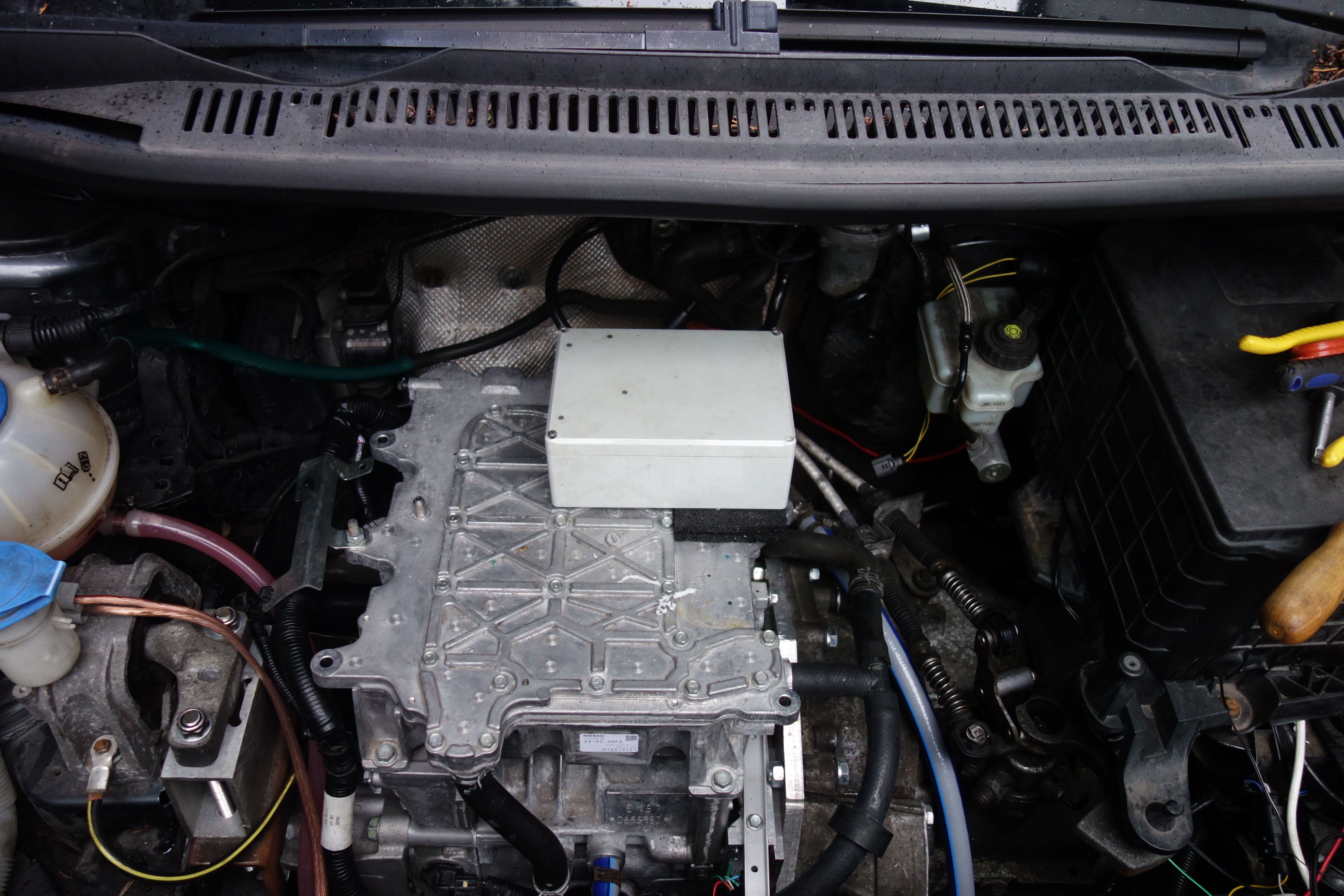

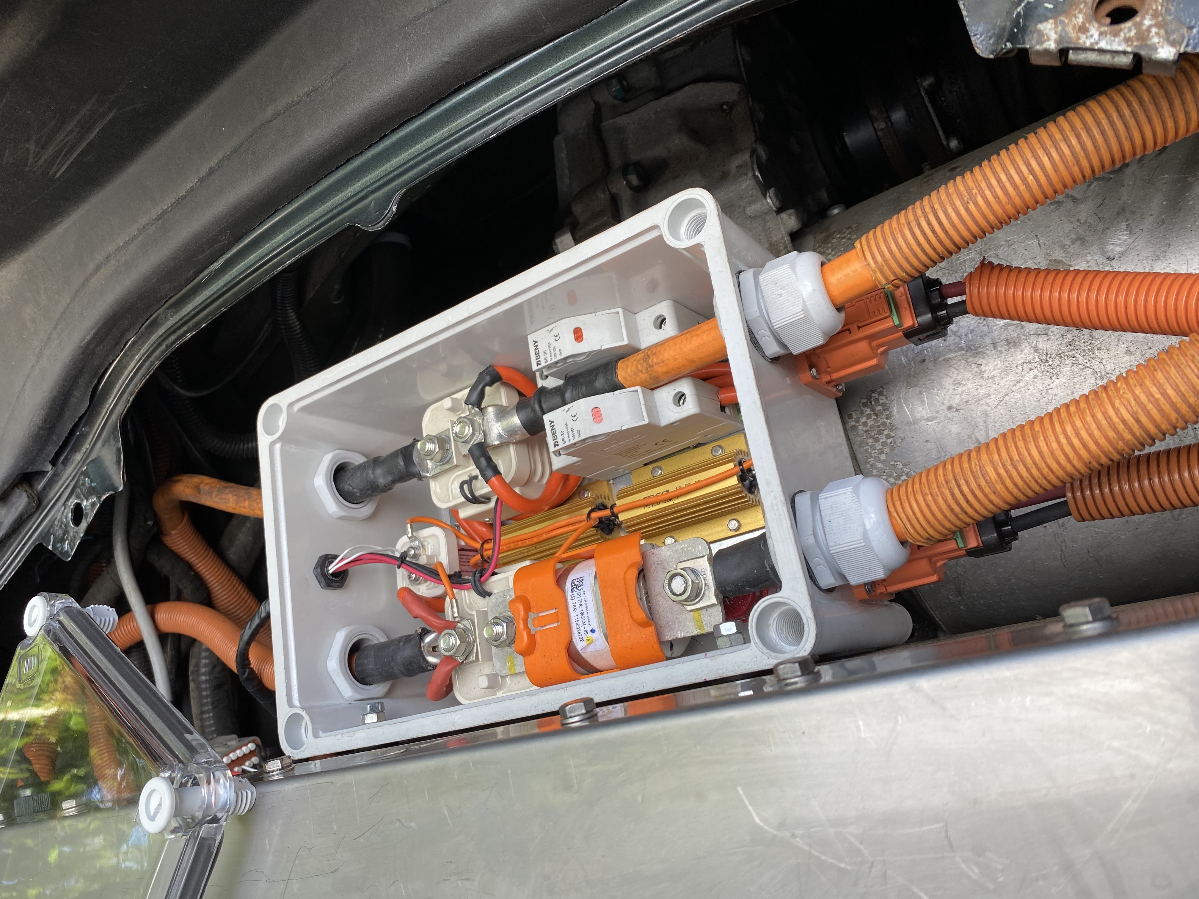

Then there is the Pug...
About the same HV / Relay box.
However i managed to get the brass rails fitted without those threaded rods sticking out of the box.
I use color coded or numbered 0.5mm2 cables. Without a sketch i would totally forget where wiring goes in a week.
https://leafdriveblog.wordpress.com/tag/contact-box/

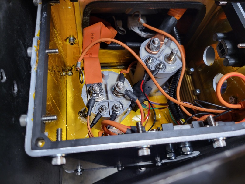

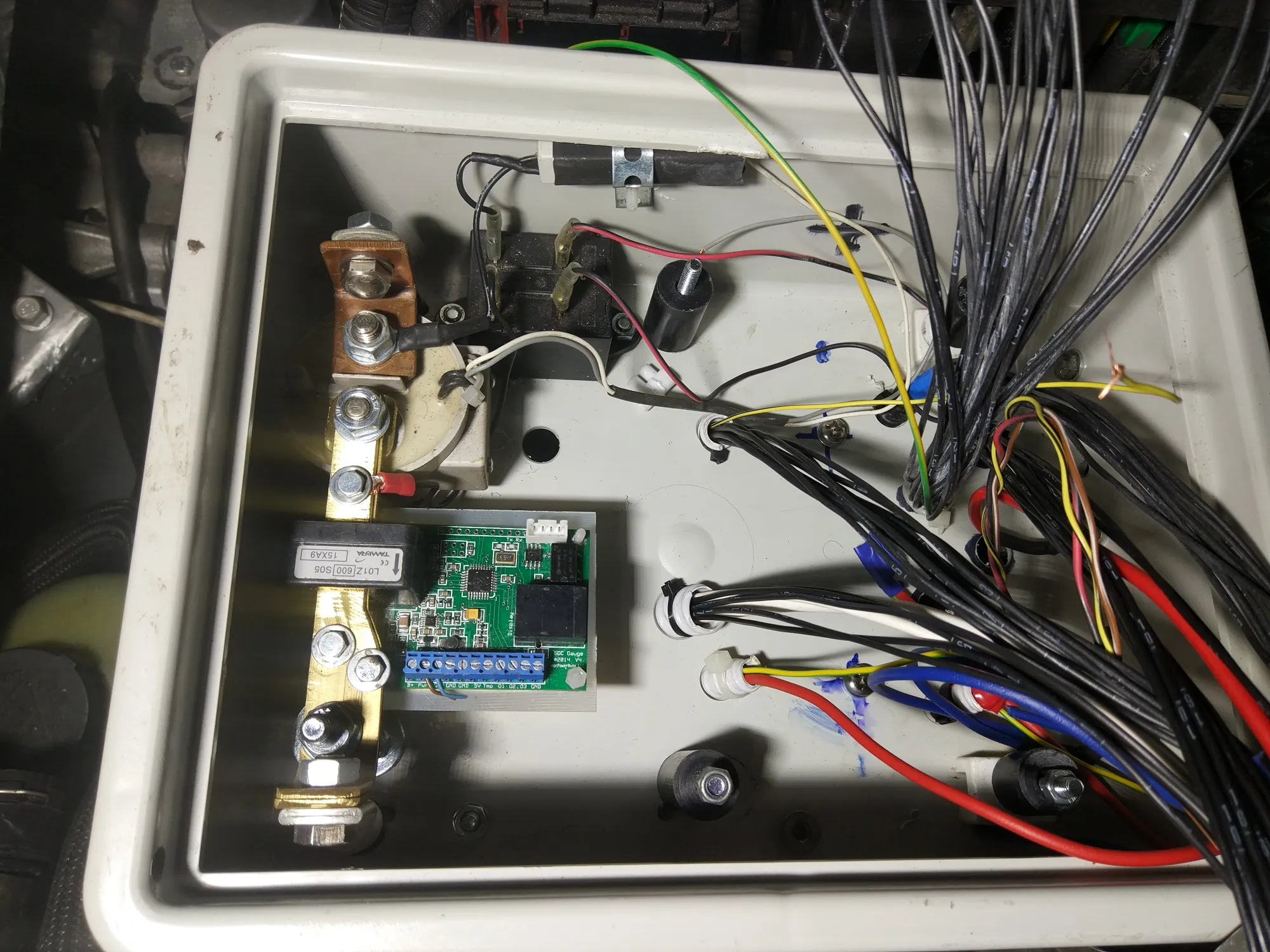

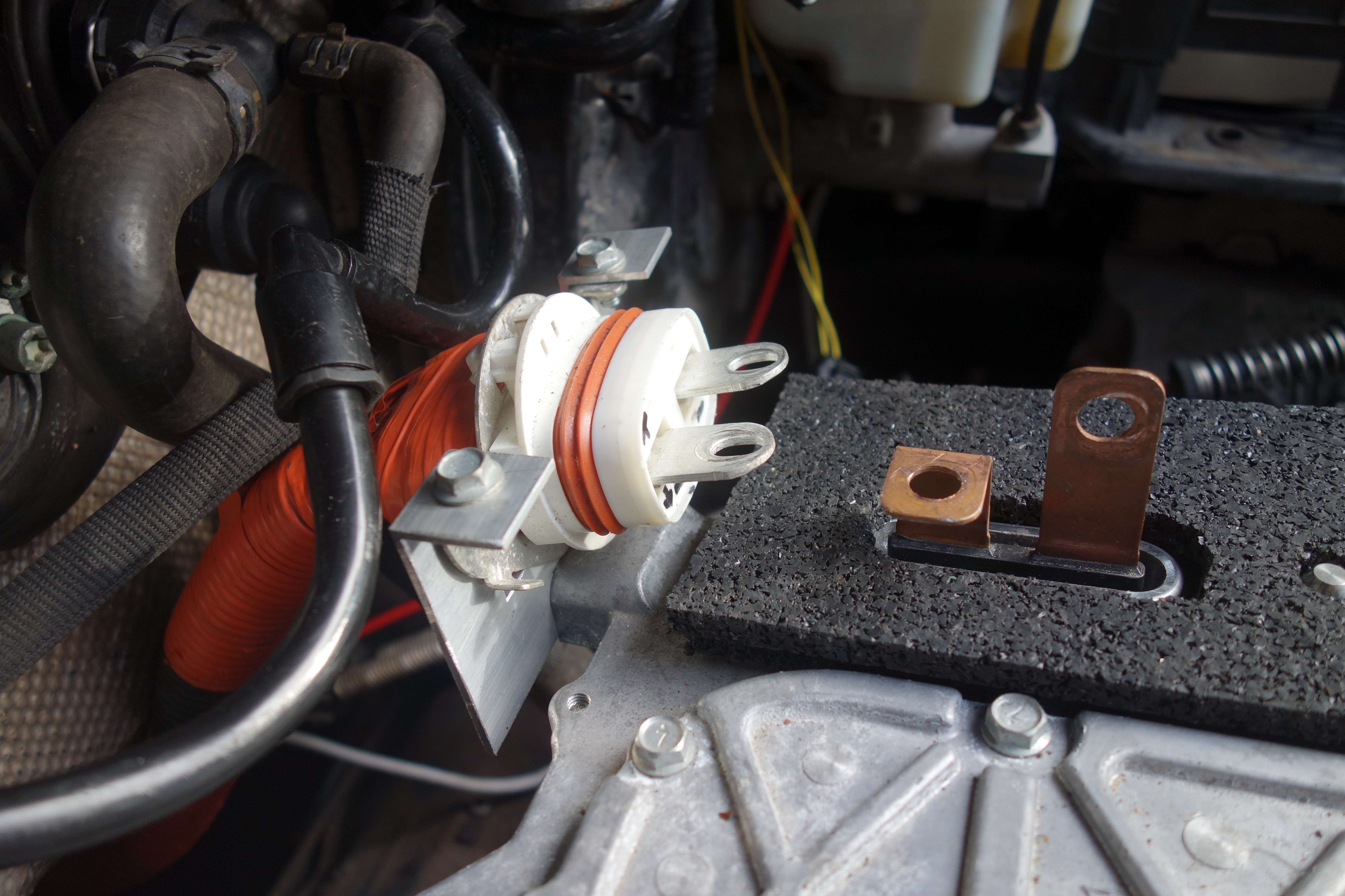

As always to be taken with a grain of salt... It's "flappin around in the breeze". But ensures isolation and strain relief.
Re: Pics of your HV junction contactor box
Wow, I love the idea of using the bottom PDM shell. Looks like it would add 100mm to the height of the stack. Still too much for my car, unfortunately.

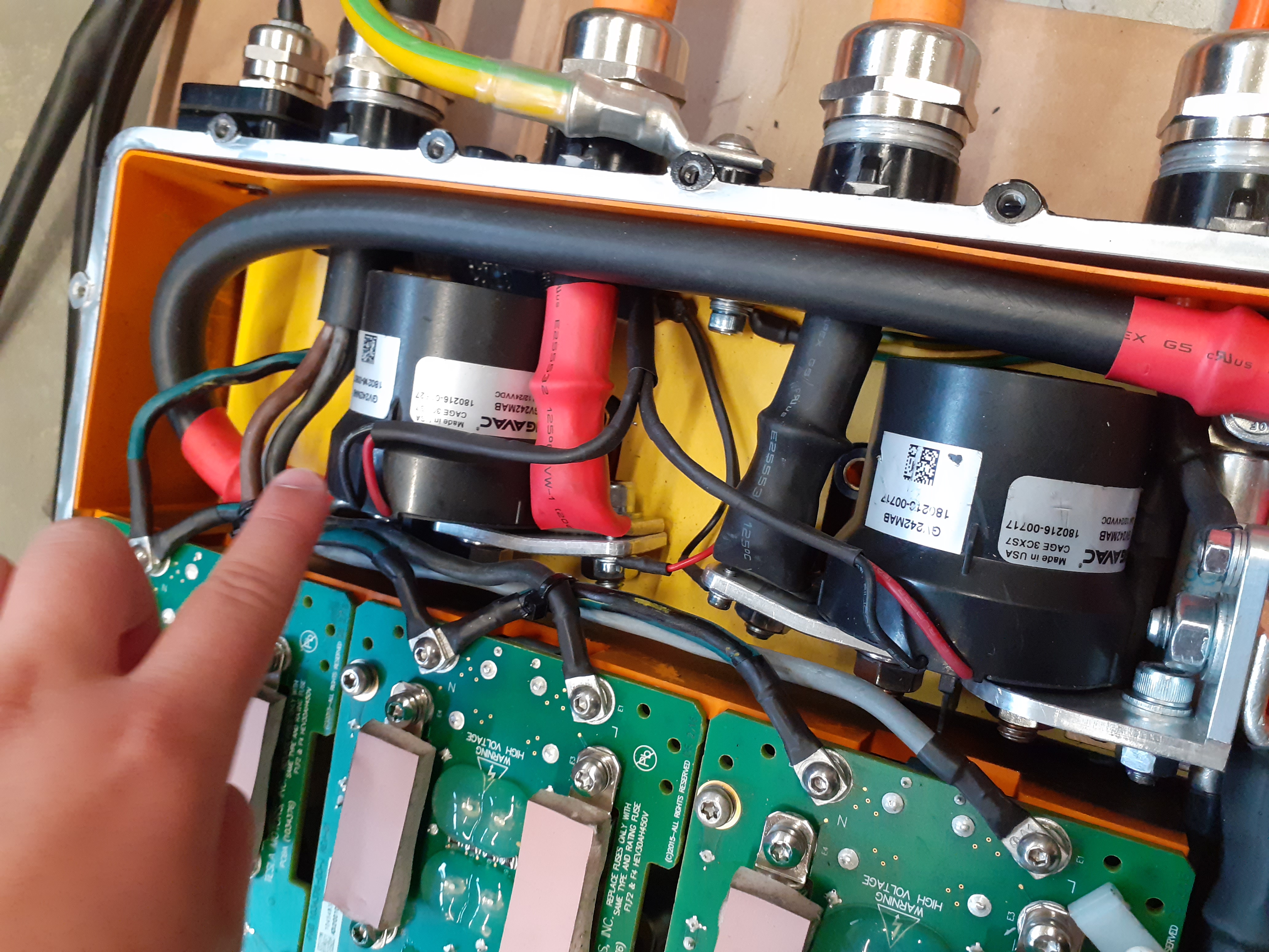

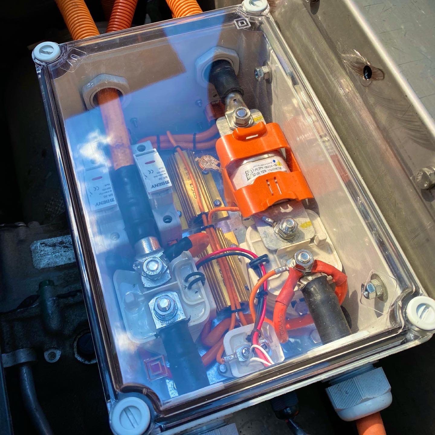

This is mine, during installation. It was necessarily pretty compact. No shunt (current sensor elsewhere in the pack). Precharge resistor is on the right hand side, precharge relay is on the bottom plane between contactors. Fuses for the charger and DCDC are on the inside wall at the bottom of the photo. Economizer PCB is on the bottom plane between the contactor and the wall, under the fuse block.

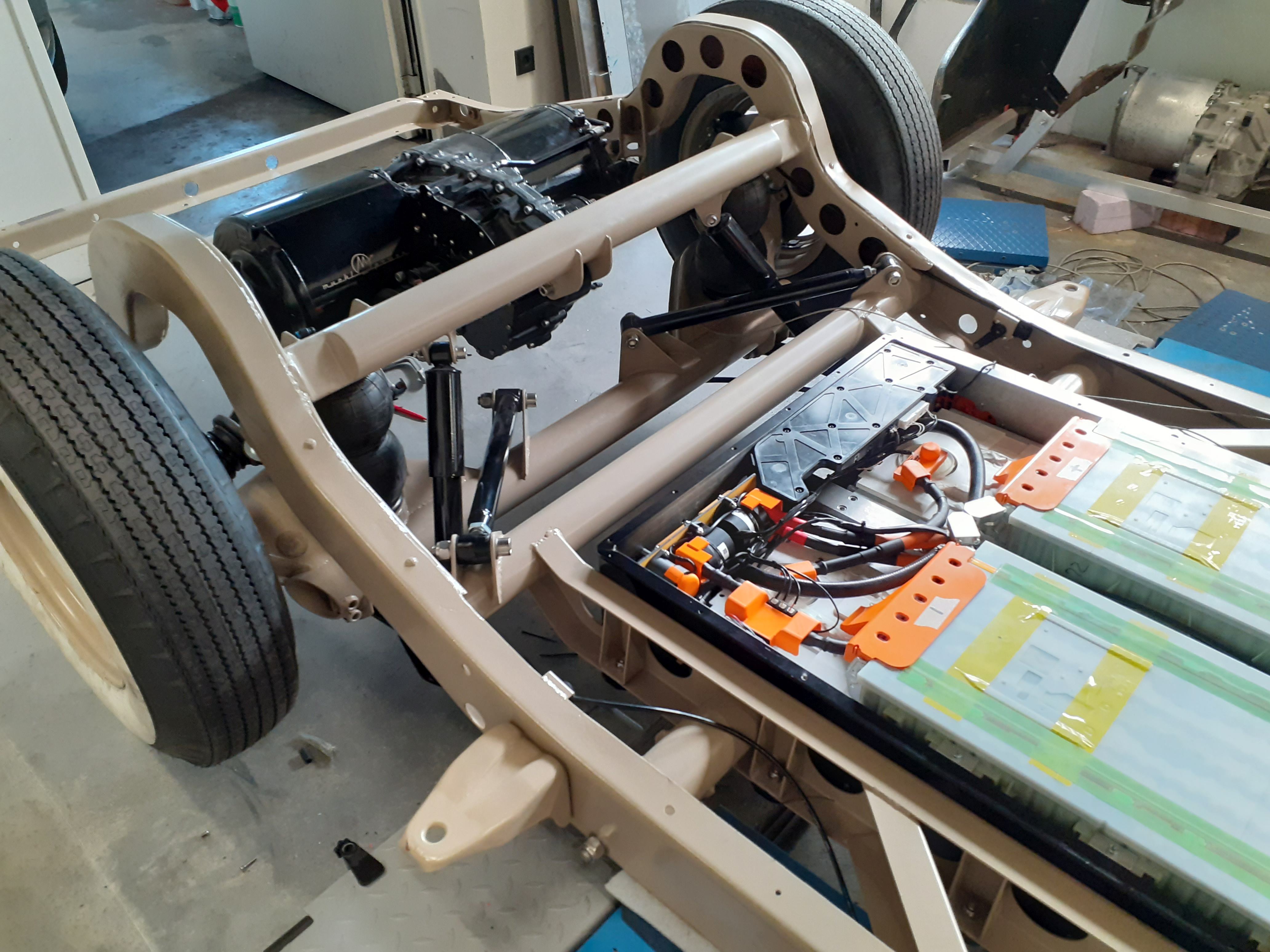

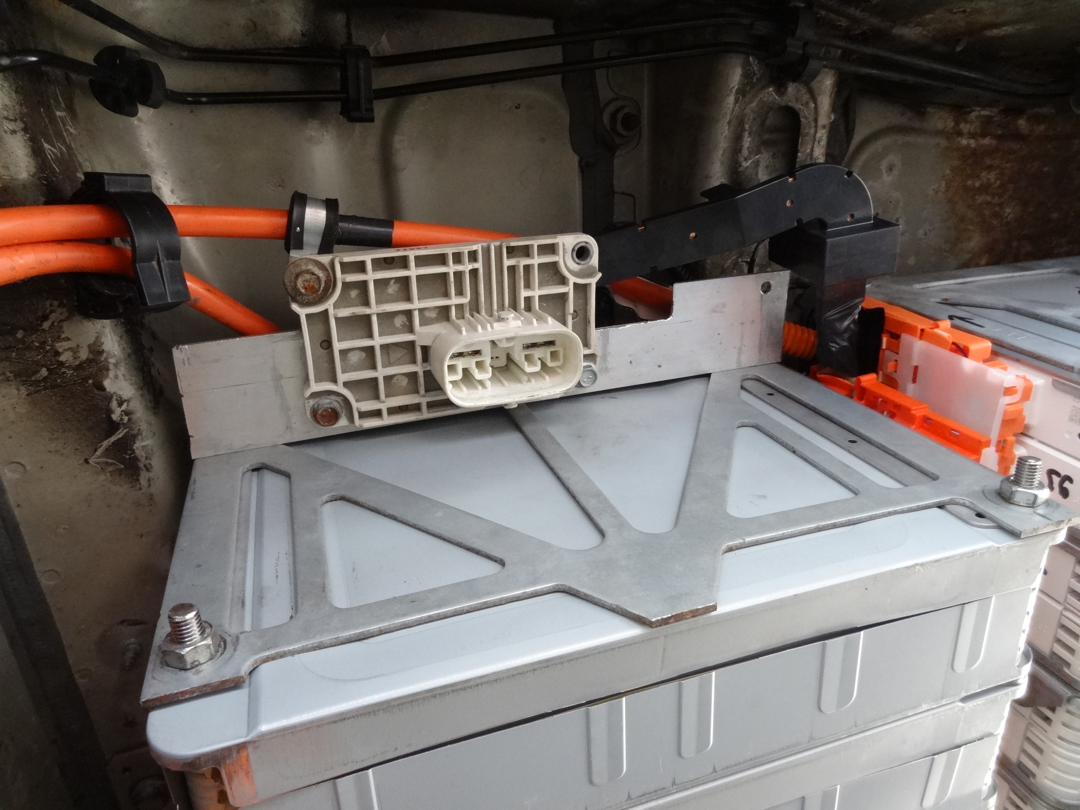

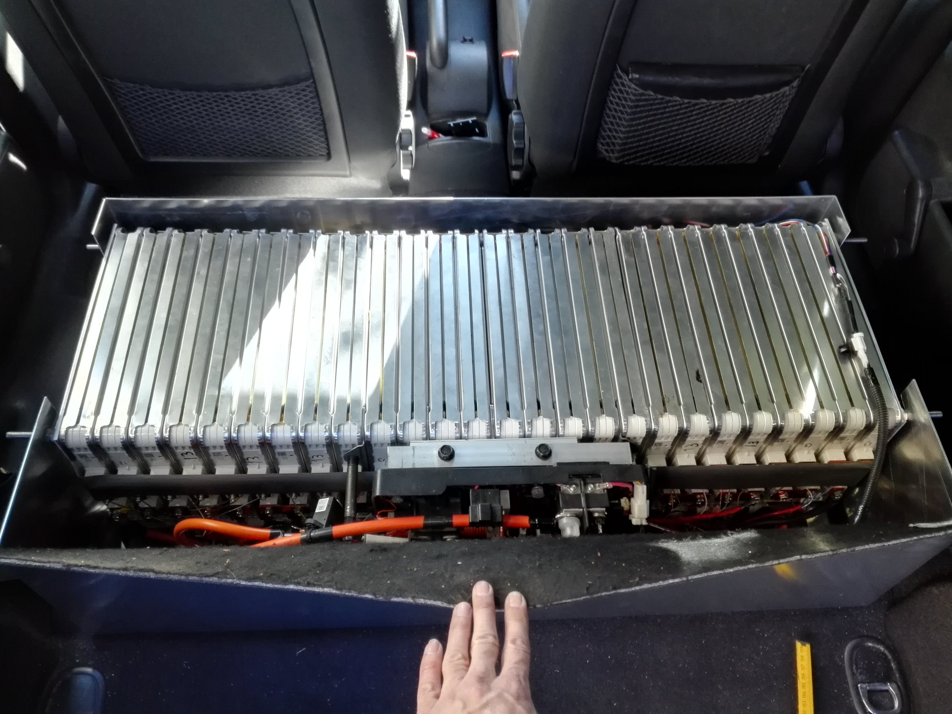

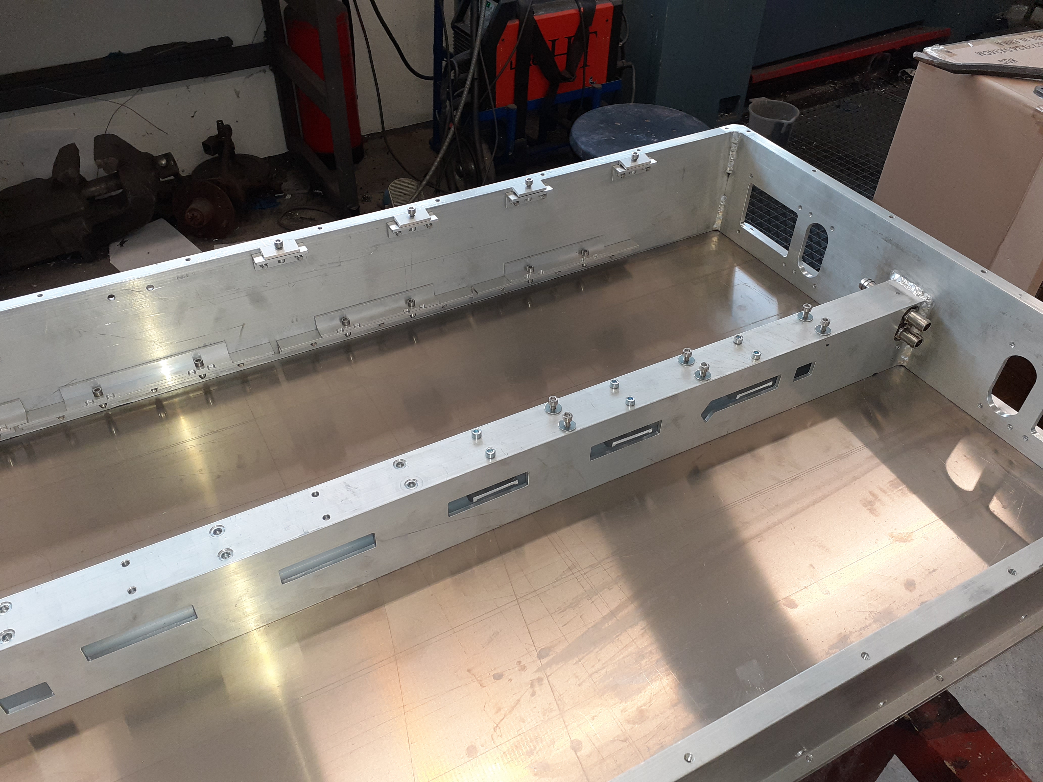

Closest I could get to those ideals was this (removing the shunt splits pack in half)
In Audi I managed to fit them into the battery box:
And this with the Nissan pack
Why? Because there is simply no room for contactors in the box. At least they follow soon after in the exhaust tunnel. And if you want to work on them you have a possibility to cut pack voltage before them.In Audi I managed to fit them into the battery box:

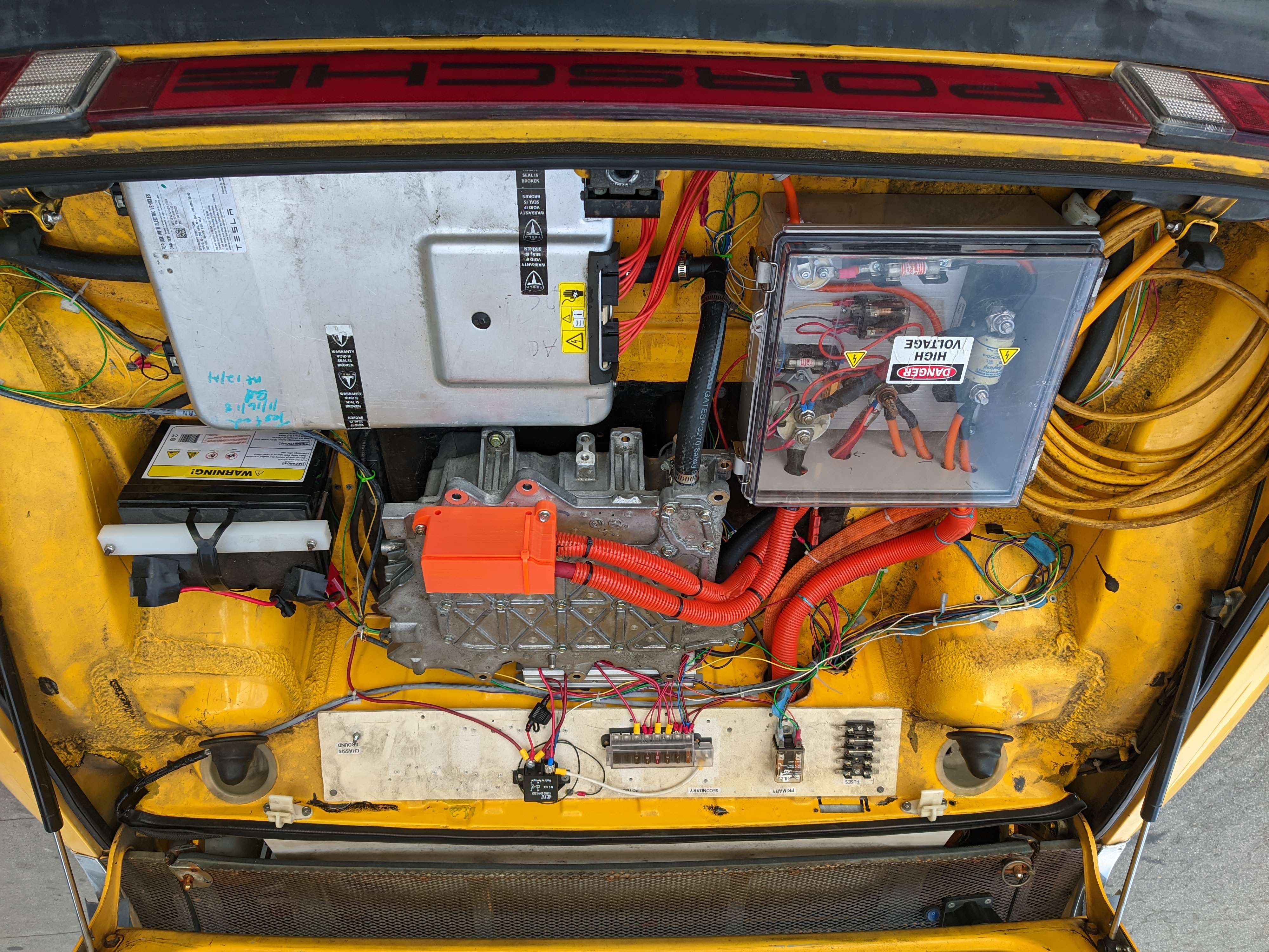

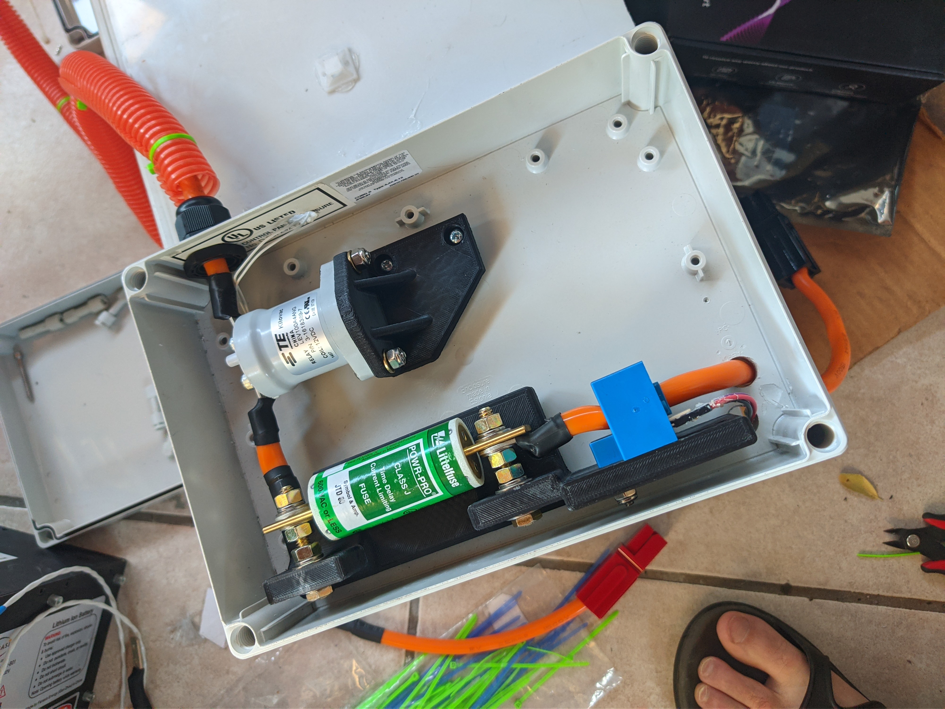

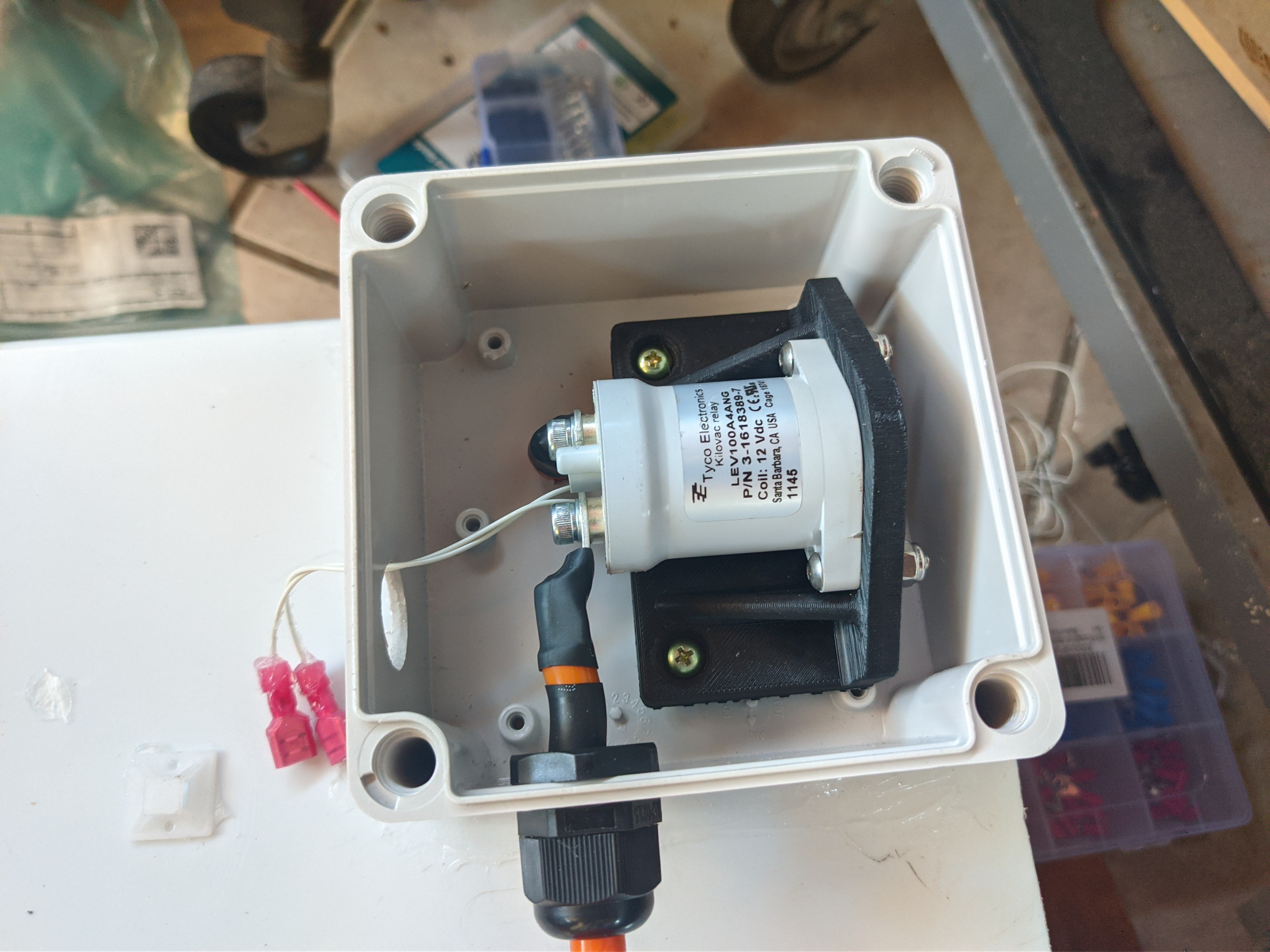

In my 914 I have 2 separate battery packs and each has their own set of fuse and contactors to protect the separate packs and keep HV within the enclosure when the car is off, no mid pack disconnects though. Then, in a third box I have the main fuse, precharge relays and resistor (separate contactor controlled by the inverter to complete precharge with), DCDC fuse, and charger fuse/contactor. The main project thread has some background.

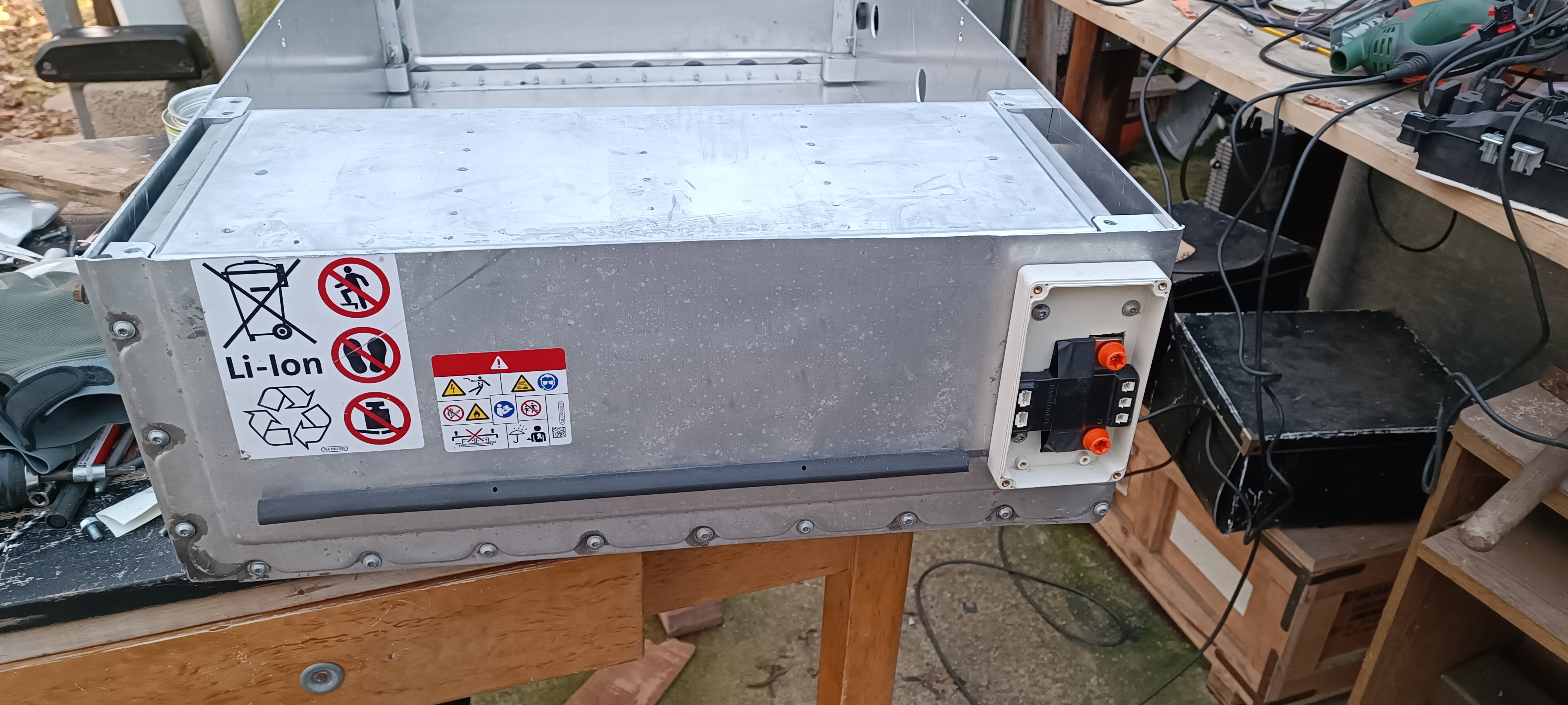

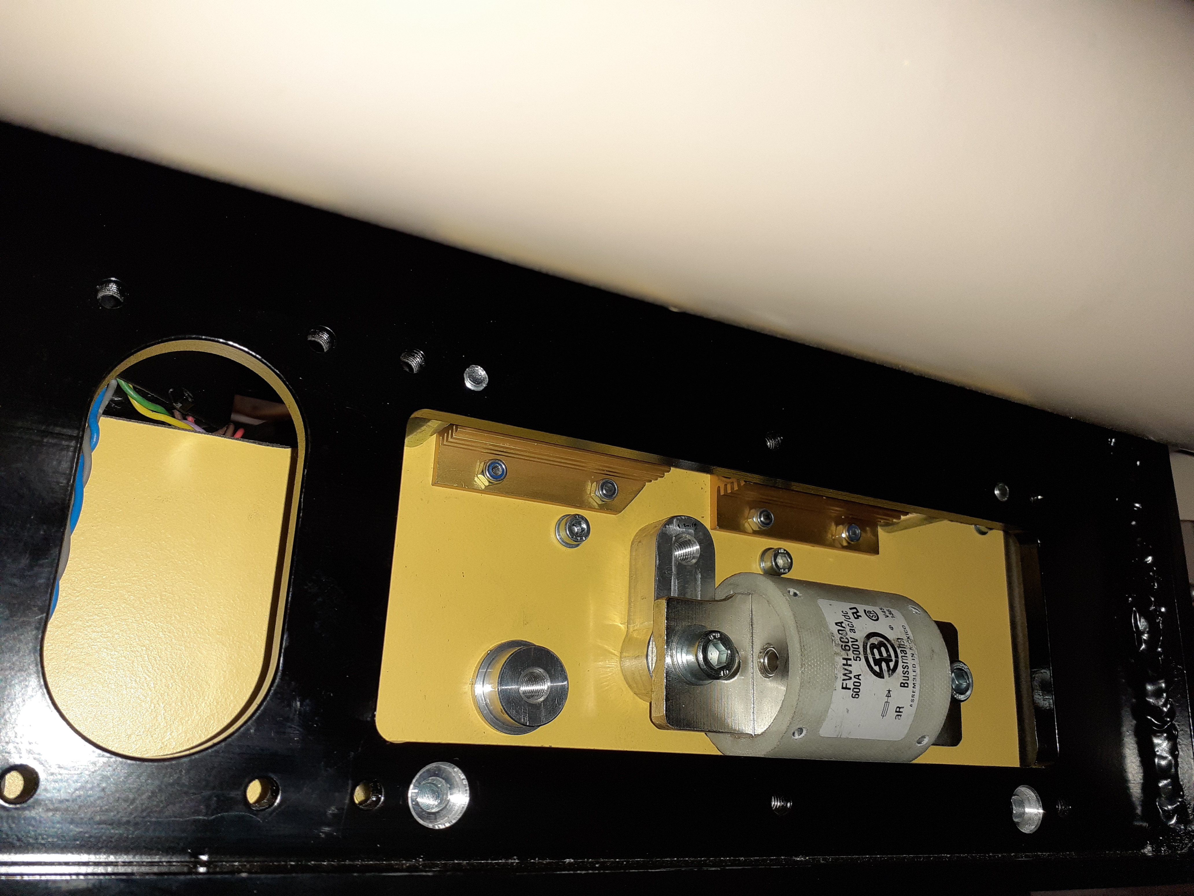

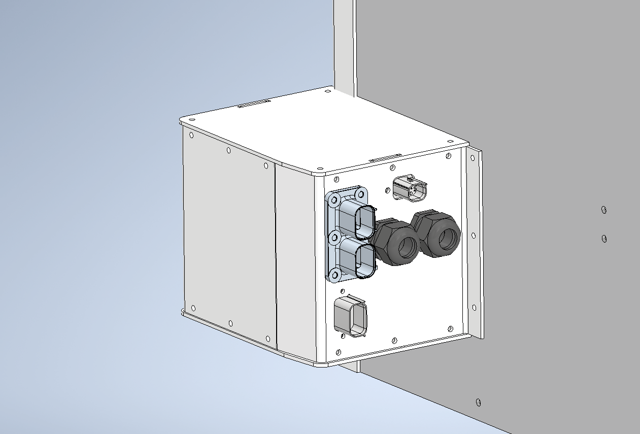

This corresponds to my design. I have three contactors in the battery box, the BMS, the main fuse and an ISA current sensor, nothing else. Plastic inside, aluminum outside. The low-voltage connections for CAN and the contactors go outside via a molex connector. When the Molex is removed, no high voltage can come out of the box. The main fuse has its own small cover, just like the terminals of the HV cables. The contactors for fast charging are housed in the Tesla GEN3 charger. Additional HV fuses are in the housing of the DC-DC converter. Both only have power when the main contactors are closed.
