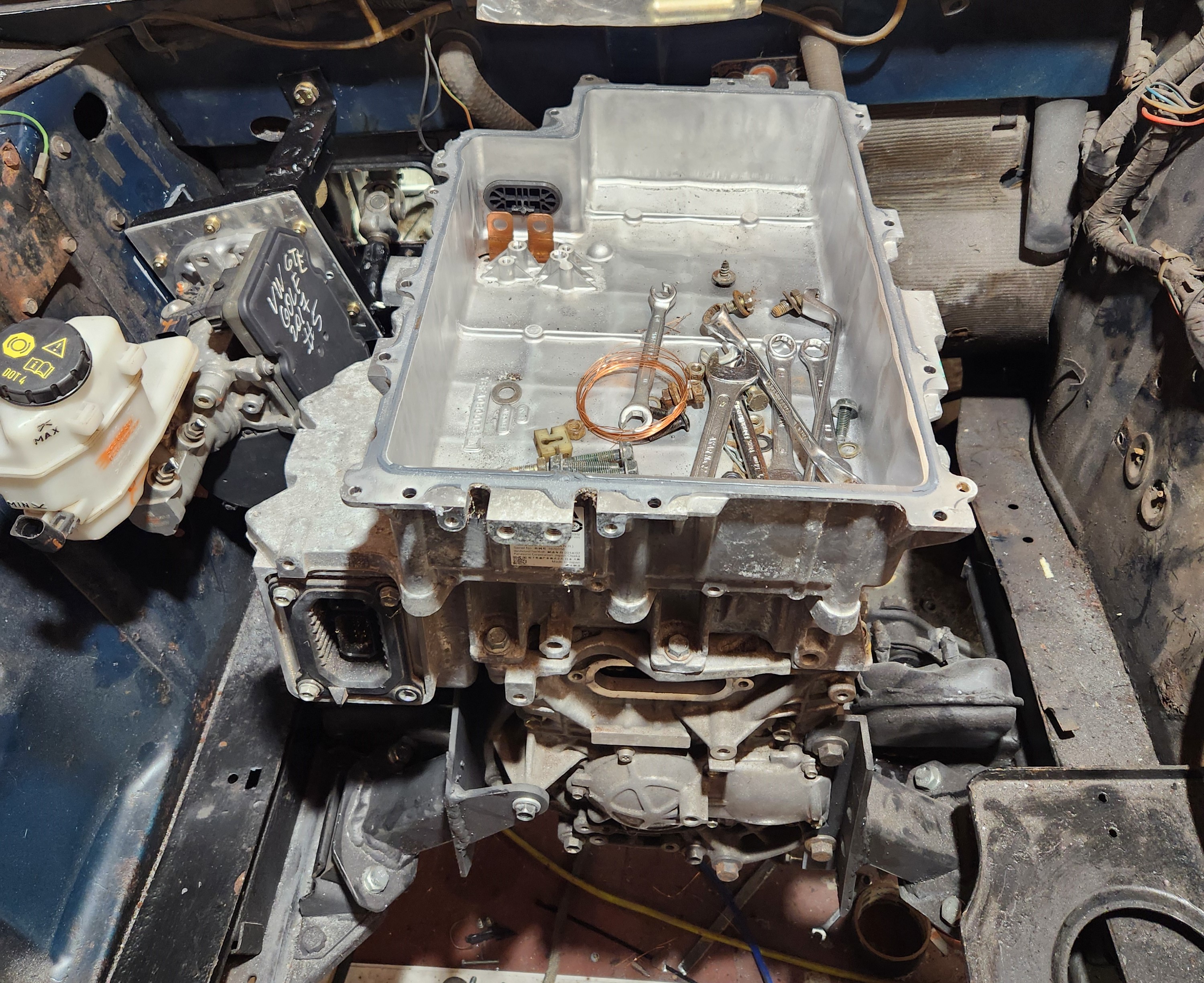

So I at a point where I would like to start on the HV junction contactor box.
I have tried looking through the posts for layout ideas, not having much luck.
Can you post a pic of your HV junction contactor box in your build.
I have a blank canvas now so want to get it right .
My setup is/will be a Leaf EM57 with invertor.
Leaf contactor box
Zombie
ISA shunt
Outlander charger ( position not decided yet , may go under back seat or boot area)
still have to make battery boxes
I bought a Industrial connection box, But it too big
I also have the base (has been stripped apart) of the leaf PDM , though have to make a Perspex/Ali lid for it.

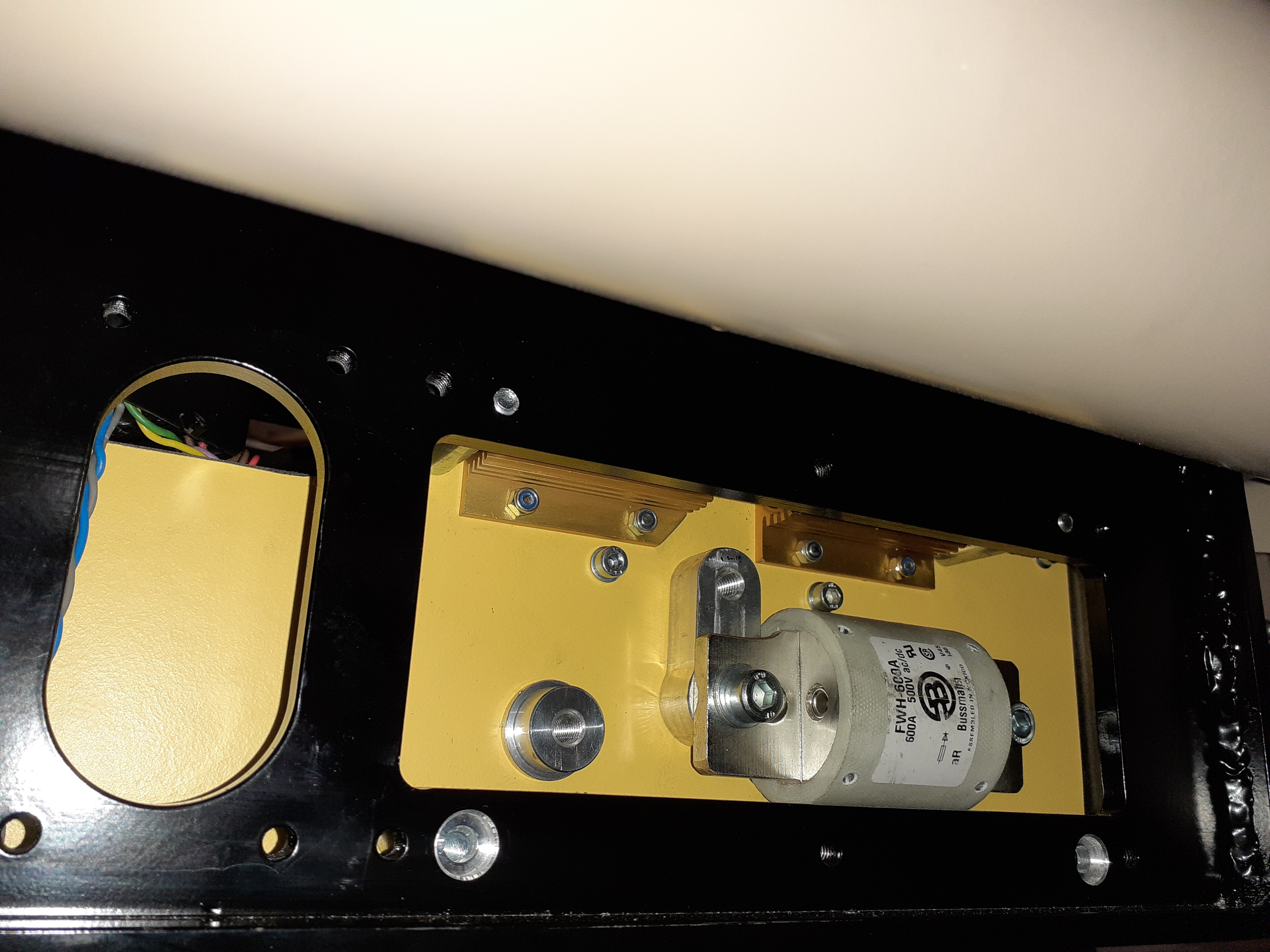

The "new" HV / relay box in Mazda MX-3 redesign
Be advised some of the OPs here advised me to redesign the threaded studs that support the copper bars because they protrude out under the box. I tend to agree with them as in the prospect of accident you could end up with HV+ on the car chassis.
Should be redesigned using those rubber sealant blocks with M8 studs.
https://mazdamx3ev.wordpress.com/2024/0 ... ntact-box/

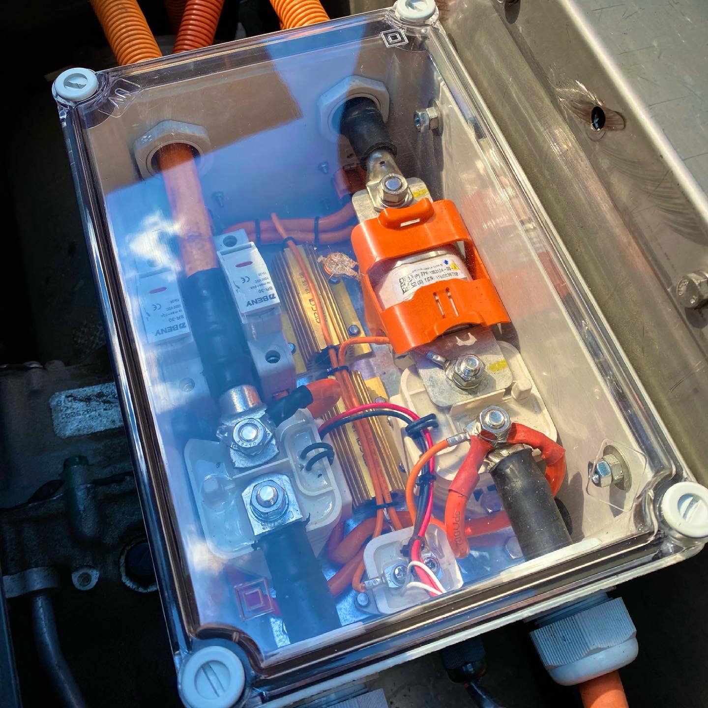

As always to be taken with a grain of salt... It's "flappin around in the breeze". But ensures isolation and strain relief.

Wow, I love the idea of using the bottom PDM shell. Looks like it would add 100mm to the height of the stack. Still too much for my car, unfortunately.
This is mine, during installation. It was necessarily pretty compact. No shunt (current sensor elsewhere in the pack). Precharge resistor is on the right hand side, precharge relay is on the bottom plane between contactors. Fuses for the charger and DCDC are on the inside wall at the bottom of the photo. Economizer PCB is on the bottom plane between the contactor and the wall, under the fuse block.
