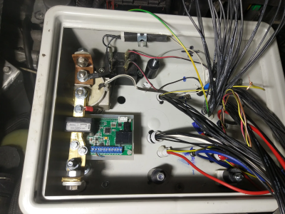

This is mine, during installation. It was necessarily pretty compact. No shunt (current sensor elsewhere in the pack). Precharge resistor is on the right hand side, precharge relay is on the bottom plane between contactors. Fuses for the charger and DCDC are on the inside wall at the bottom of the photo. Economizer PCB is on the bottom plane between the contactor and the wall, under the fuse block.

I won't assume anything on OP:s special skills, so just commenting on a general level. As this is probably a thread that future builders stumble upon, I don't recommend to use most of these setups above as more than a warning example.
Probably most of these guys know better and that's why there are corners cut (If this hurt, you must know that I'm on to something)
I don't know what's the flair for other guys, but if you don't have a packaging issue, I'd recommend to place the contactors inside the battery box to layer up on the inherent safety by design. Meaning you have a full metal enclosure with isolated HV+ and HV - connection points put of it.
I mean just look at how the OEM battery box is made and mimic the design.
There are some really good points in the wiki
A battery box with contactors before output (=HV connection to outside of the box) and a service disconnect to split the pack voltage will increase the probability of ending up with a design that is less likely to kill you or the next guy working on the car.

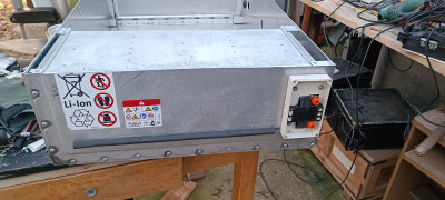

Re: Pics of your HV junction contactor box
This corresponds to my design. I have three contactors in the battery box, the BMS, the main fuse and an ISA current sensor, nothing else. Plastic inside, aluminum outside. The low-voltage connections for CAN and the contactors go outside via a molex connector. When the Molex is removed, no high voltage can come out of the box. The main fuse has its own small cover, just like the terminals of the HV cables. The contactors for fast charging are housed in the Tesla GEN3 charger. Additional HV fuses are in the housing of the DC-DC converter. Both only have power when the main contactors are closed.
