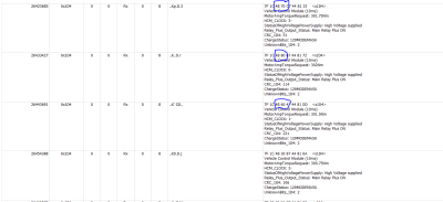

Here is a a log from a 62kwh car
The way the torque gets requested is a bit strange.
So it scales from 0-100 as torque percentage then multiplies by 2047. Given the motor torque is scaled at 0.25 bit/Nm and its a 12bit value.
This would mean 2047*0.25 = 511.75Nm which sounds like quite alot.

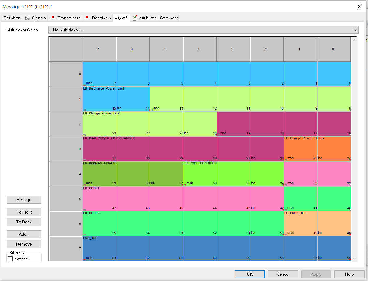

Probally want to update the 0x1DC limits to the ones form a gen 3 log like below.
These values are currently hardcoded in the Zombie code

Re: Zombieverter Nissan Leaf 160kW
"cryptic" because its just copy paste from a log.
Here is the format of the values.
So you the 10bit discharge limit is: 0x1B8 440d. The scaling is 0.25kW per bit, luckily its hex and if you shift it back 2 positions you are dividing by 4.
The discharge limits thus is 0x6E which is 110d kW
So what value do we want to try, lets say 150kW 0x69. Then shift this left 2 you get 0x258 or 600d.
bytes[0]=0x6E;
bytes[1]=0x0A;
Becomes
bytes[0]=0x96;
bytes[1]=0x0A;
ted.walsh

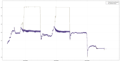

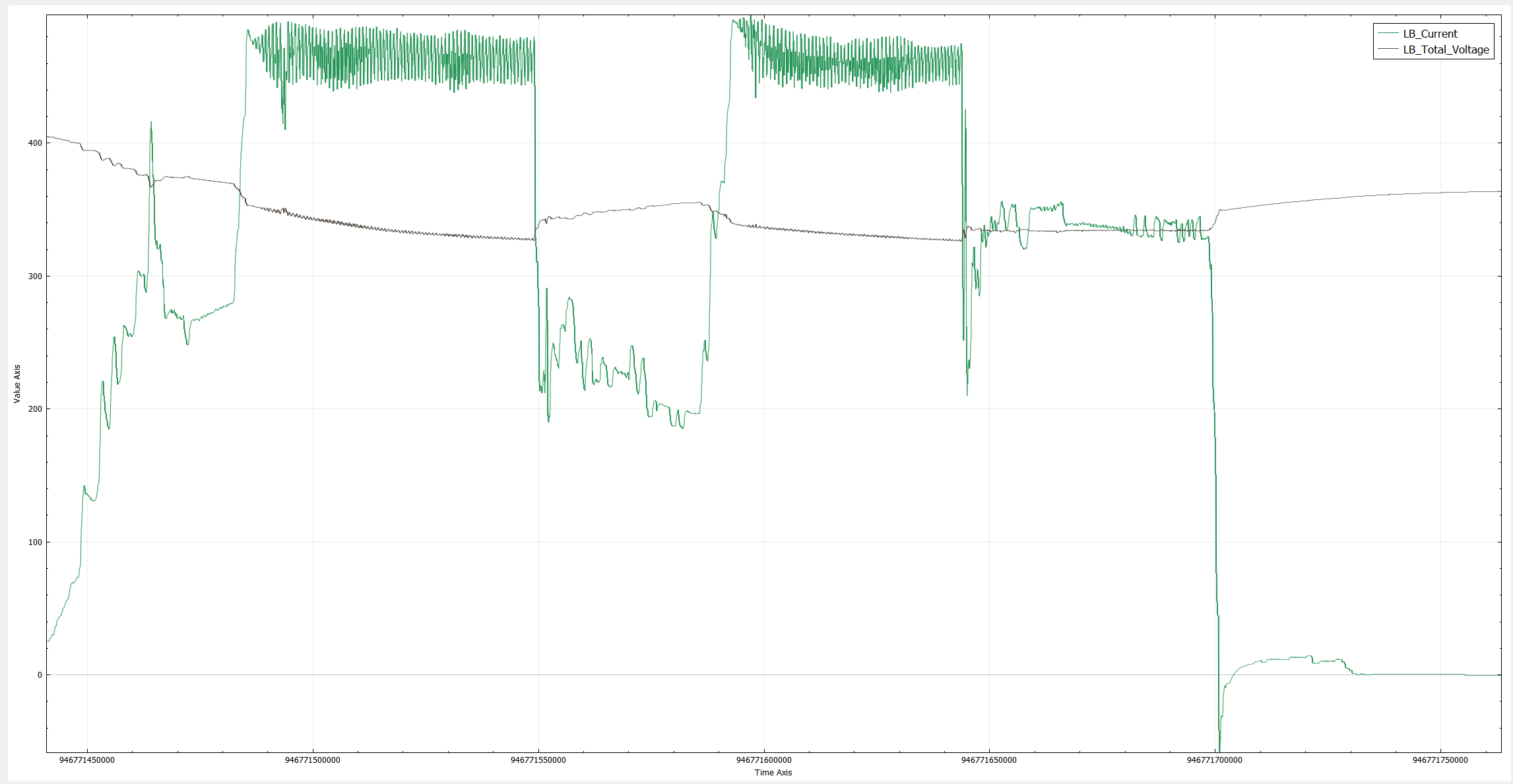

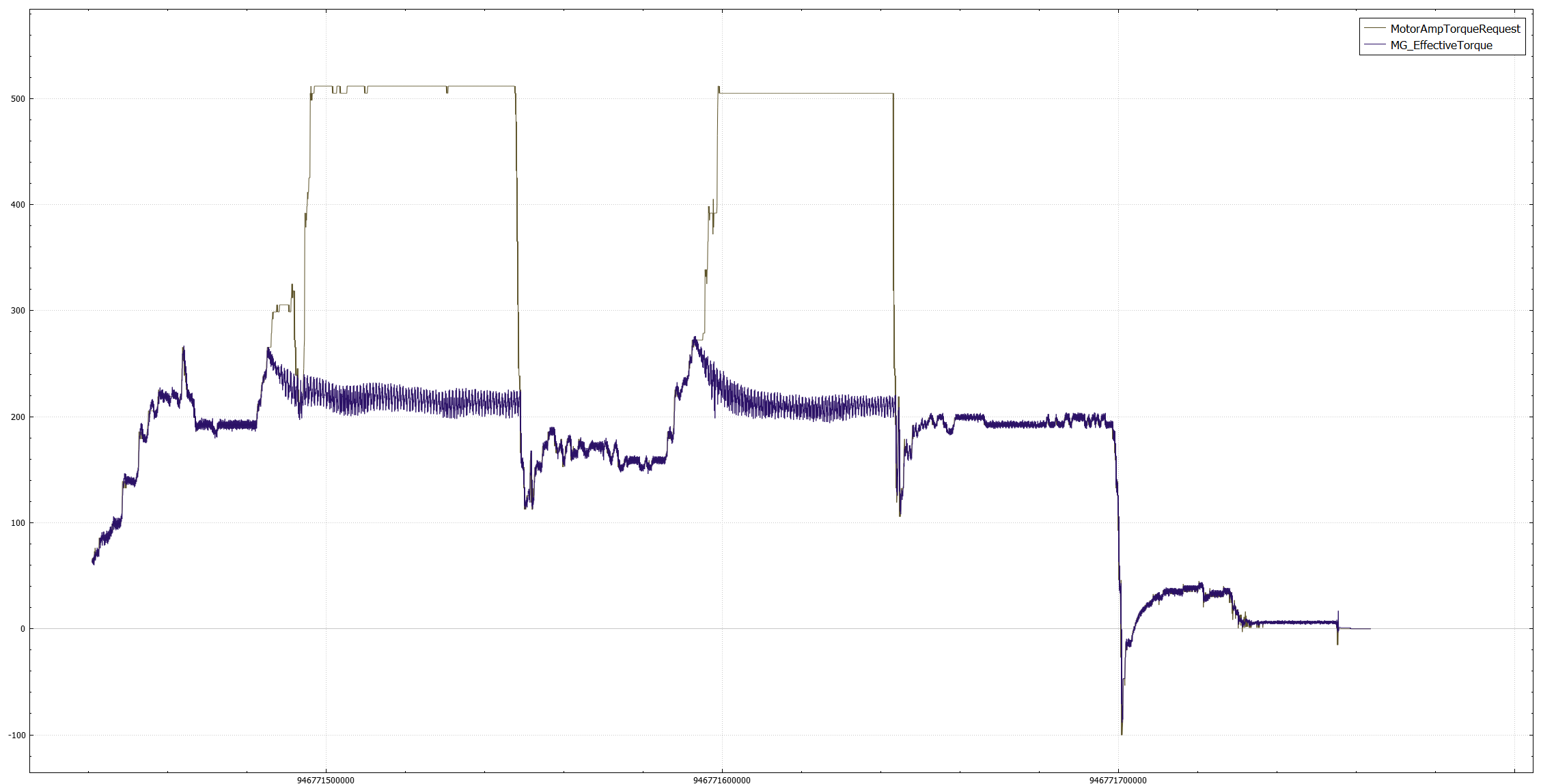

Reveiwing the CAN log with a Leaf ZE1 dbc.
You can see we request more torque yet the inverter refuses to give it to us.
The battery info reported during the run.
As you can see we are just maxing out the inverter. The average power of the two flat bits are 150-160kw give or take
One option to try, increase the power limit in message 0x1DC slightly if you are confident nothing in the battery setup gets hot.
It is possible the inverter will draw more, or it will also have its own internal limit.

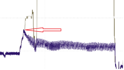

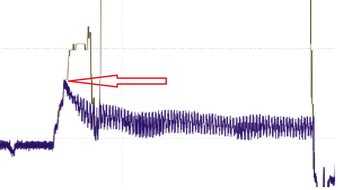

@tom91 thats great, thanks for the feedback - after looking at it Im interested as to what is actually going on here....
The actual and requested follow very nicely until about 260NM when there is a big departure. Is this because we run over the set KW limit or because the requested value at that point departs from an MAX_NM setting? either way Im assuming the resultant 'fuzzing' is some internal management algorithm trying to keep things on the straight and narrow.
as a question for all then, would it be best to keep the requested torque value underneath the 260NM 'limit' in code and get a smoother delivery or increase the KW value to try and raise the point at which the fuzzing comes in?

This is a trio of later logs. I held the total torque request (throtmax) back to 60% in an attempt to get a smoother delivery as I struggled to get the power delivery under control and that was making it difficult to drive. it sorta helped but Id changed the propeller and that didn't.
our best performance incidentally was when I accidentally limited the VCU to 500a (idcmax) and it did not like that one bit, performance was very unpredictable on the throttle as Im guessing there isn't much in the way of request smoothing going on but once the requests started to come within manageable numbers this smoothed out and we got our best run.
Im assuming from the data that the inverter is now the bottle neck and Im not going to get much further with the standard management board as it has a lot of limits and timers programmed into it that will ultimately hold performance back, Here's to hoping Johannes and crew can pull it out of the bag
