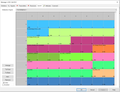

Probally want to update the 0x1DC limits to the ones form a gen 3 log like below.
These values are currently hardcoded in the Zombie code

ted.walsh wrote: Wed May 08, 2024 9:23 am Im Hoping to get some logs this weekend but in the mean time im going to change 0x1dc as suggested- is it just byte [1] I need to change or [1] & [2]? I cannot quite figure out the cryptic message in the .cpp comments
"cryptic" because its just copy paste from a log.
Here is the format of the values.
So you the 10bit discharge limit is: 0x1B8 440d. The scaling is 0.25kW per bit, luckily its hex and if you shift it back 2 positions you are dividing by 4.
The discharge limits thus is 0x6E which is 110d kW
So what value do we want to try, lets say 150kW 0x69. Then shift this left 2 you get 0x258 or 600d.
bytes[0]=0x6E;
bytes[1]=0x0A;
Becomes
bytes[0]=0x96;
bytes[1]=0x0A;

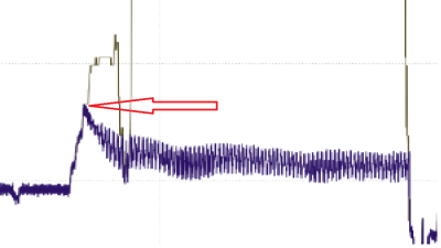

Reveiwing the CAN log with a Leaf ZE1 dbc.
You can see we request more torque yet the inverter refuses to give it to us.
The battery info reported during the run.
As you can see we are just maxing out the inverter. The average power of the two flat bits are 150-160kw give or take
One option to try, increase the power limit in message 0x1DC slightly if you are confident nothing in the battery setup gets hot.
It is possible the inverter will draw more, or it will also have its own internal limit.

@tom91 thats great, thanks for the feedback - after looking at it Im interested as to what is actually going on here....
The actual and requested follow very nicely until about 260NM when there is a big departure. Is this because we run over the set KW limit or because the requested value at that point departs from an MAX_NM setting? either way Im assuming the resultant 'fuzzing' is some internal management algorithm trying to keep things on the straight and narrow.
as a question for all then, would it be best to keep the requested torque value underneath the 260NM 'limit' in code and get a smoother delivery or increase the KW value to try and raise the point at which the fuzzing comes in?
Posts: 2963
Has thanked: 330 times
Been thanked: 848 times
Re: Zombieverter Nissan Leaf 160kW
It is the KW limit which you are seeing.
