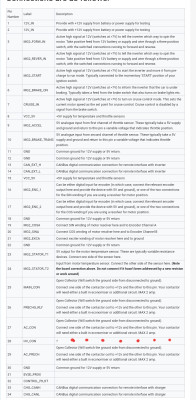

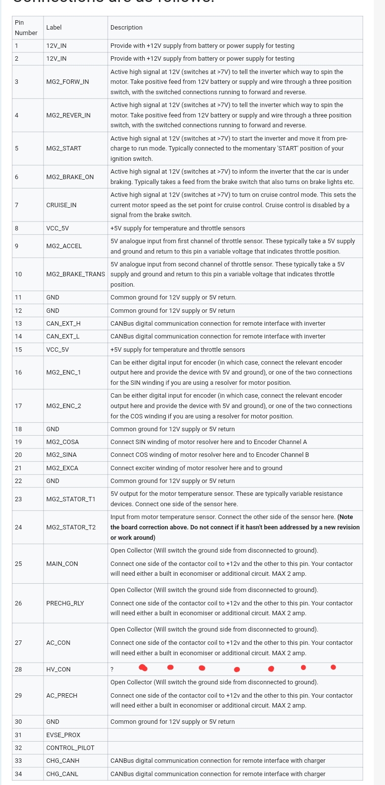

From the wiki, it seems the DC high voltage info is a mystery.FFMan wrote: ↑Sun Nov 05, 2023 12:30 pm On mobile.
Contractors are fine. I’ve measured full hv voltage on them and on the feed into the inverter. Plus the charger is on the same terminal posts and sees full hv. Therefore pretty confident hv is in the inverter just v1c board can’t see it.
Re multiway connector, yeah it’s fiddly but can’t believe hv is present there hence question about how v1c board sees the hv, does Toyota boards tell it, or does it measure it ?

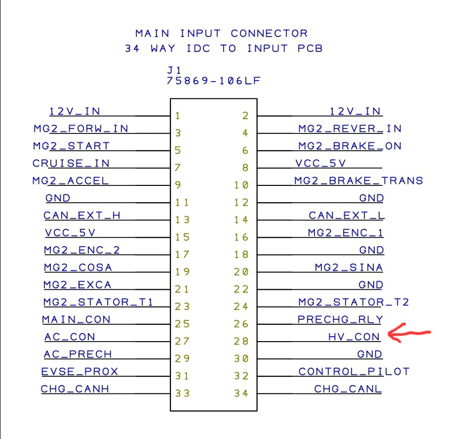

https://openinverter.org/wiki/Toyota_Prius_Gen3_Board
Have to trace it down in the schematic. Unfortunately the schematic is an image, no searchable text.
https://github.com/damienmaguire/Prius- ... ematic.pdf
From there, Verify that connector, wiring, and solder connections are good on your drop in pc controller board. Verify any ground connections on that connector are good as well. Looks like 11, 12, 18, & 22.
If that's all good you'll need to find where that HV_CON connects in the schematic. I looked on mobile for a bit and can't find it. It not being searchable and being huge makes it a challenge. I didn't see a voltage divider on the board for high voltage sensing. I would imagine Toyota kept all the high voltage stuff off the low voltage controller board but I don't know enough about these to say for sure.
Johu's post update, check the connector mentioned above.

Re: Investigating trips
Afaik Hv_con is the for a contactor (controller by the atmega328p) that bypass the buck/boost side of the inverter if you are using the inverter for charging, read further in the link you provided, sorry I'm on the mobile I would've shared screenshots of what I mean.
