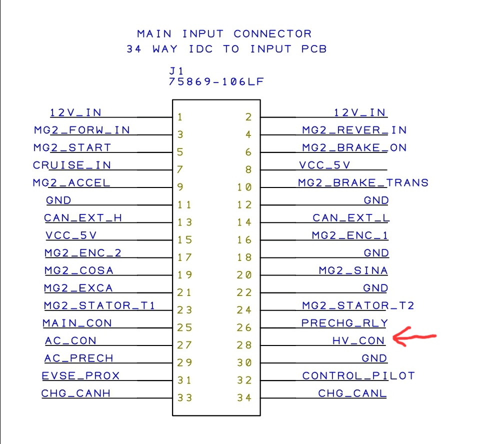

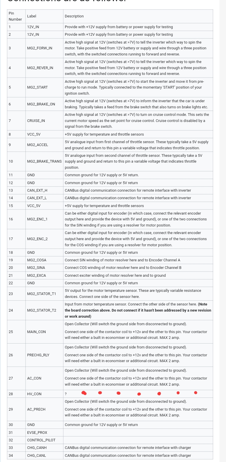

https://openinverter.org/wiki/Toyota_Prius_Gen3_Board
Have to trace it down in the schematic. Unfortunately the schematic is an image, no searchable text.
https://github.com/damienmaguire/Prius- ... ematic.pdf
From there, Verify that connector, wiring, and solder connections are good on your drop in pc controller board. Verify any ground connections on that connector are good as well. Looks like 11, 12, 18, & 22.
If that's all good you'll need to find where that HV_CON connects in the schematic. I looked on mobile for a bit and can't find it. It not being searchable and being huge makes it a challenge. I didn't see a voltage divider on the board for high voltage sensing. I would imagine Toyota kept all the high voltage stuff off the low voltage controller board but I don't know enough about these to say for sure.
Johu's post update, check the connector mentioned above.

Afaik Hv_con is the for a contactor (controller by the atmega328p) that bypass the buck/boost side of the inverter if you are using the inverter for charging, read further in the link you provided, sorry I'm on the mobile I would've shared screenshots of what I mean.

ok that makes sense - i'm not using buck/boost.Mhs wrote: ↑Sun Nov 05, 2023 5:16 pm Afaik Hv_con is the for the a contactor (controller by the atmega328p) that bypass the buck/boost side of the inverter if you are using the inverter for charging, read further in the link you provided, sorry I'm on the mobile I would've shared screenshots of what I mean.
Still wondering how the inverter sees the HV. I know from checking my logging from before it used to see full pack voltage on udc.
I'll check all the connectors, maybe even reflow them with a soldering iron but likely tomorrow eve now.
