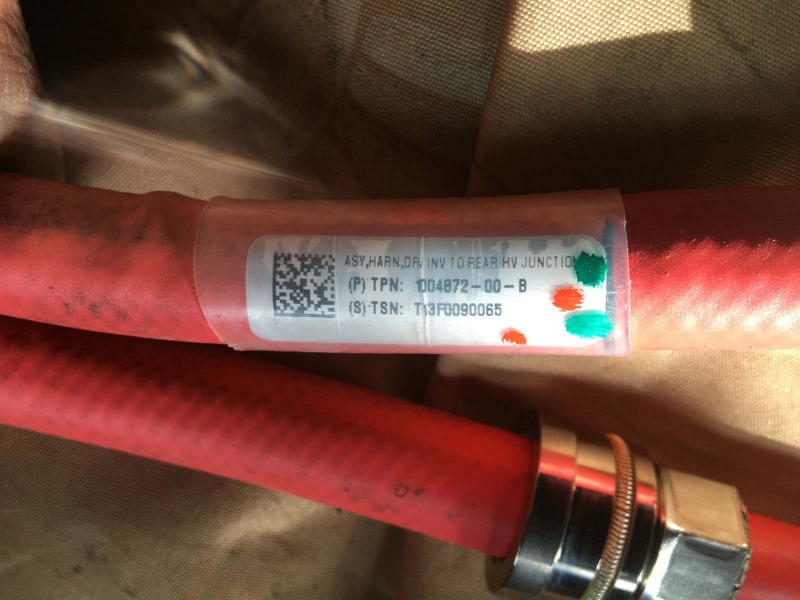

I've got a set of early LDU cables (1004872-00-B) on the way (via eBay), but until they arrive . . .
Do you have an accurate OD of these cables? I'm trying to order EMC shielded cable glands, and I need to verify that the HV cables for the LDU are <18mm OD, or larger than that. 18mm is the typical breakover point, where I order one part No., or another.
[later: I've added a "LDU HV Connectors" section to the LDU Wiki with some dimensions. Summary:
the outer insulation OD is ~17.3mm]

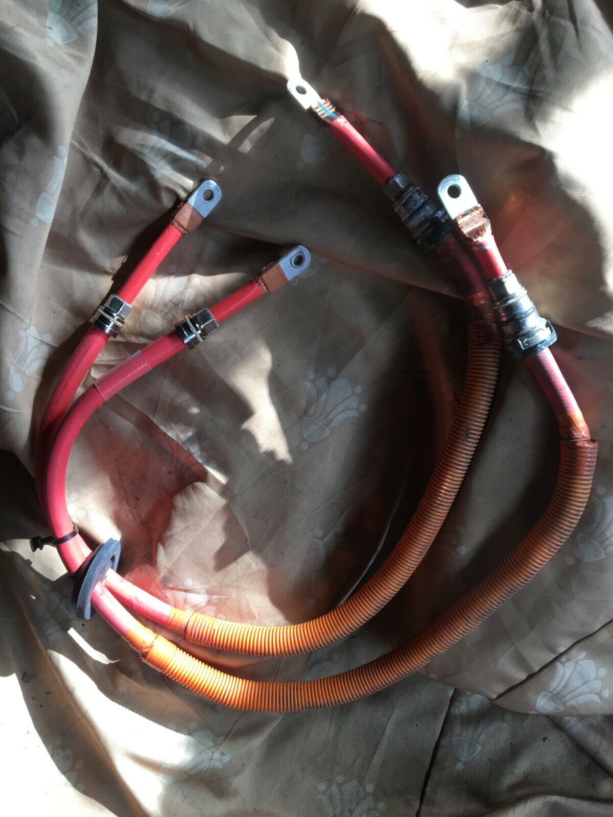

Typical early Model S LDU cables:
(The early Model S LDU HV cables have no bracket on the ends that insert into the GEN1 Rear HVJB, and that is the major distinguishing feature. As the Rear HVJB changed in late 2013 -- requiring a redesign of the HV cable assy -- there are a lot more later Model S HV cables available than early ones. I could have used either in my case -- I'm cutting off the ends that mate to the OEM HVJB -- but the best price available I found was for an early set.)

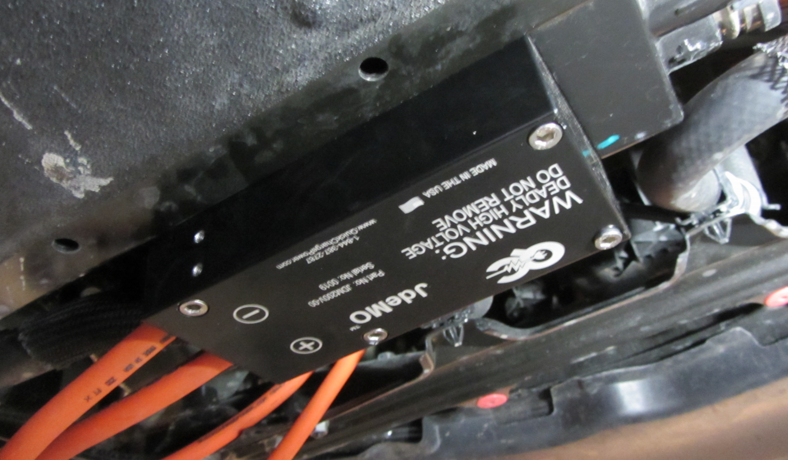

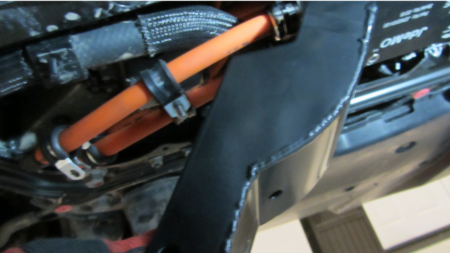

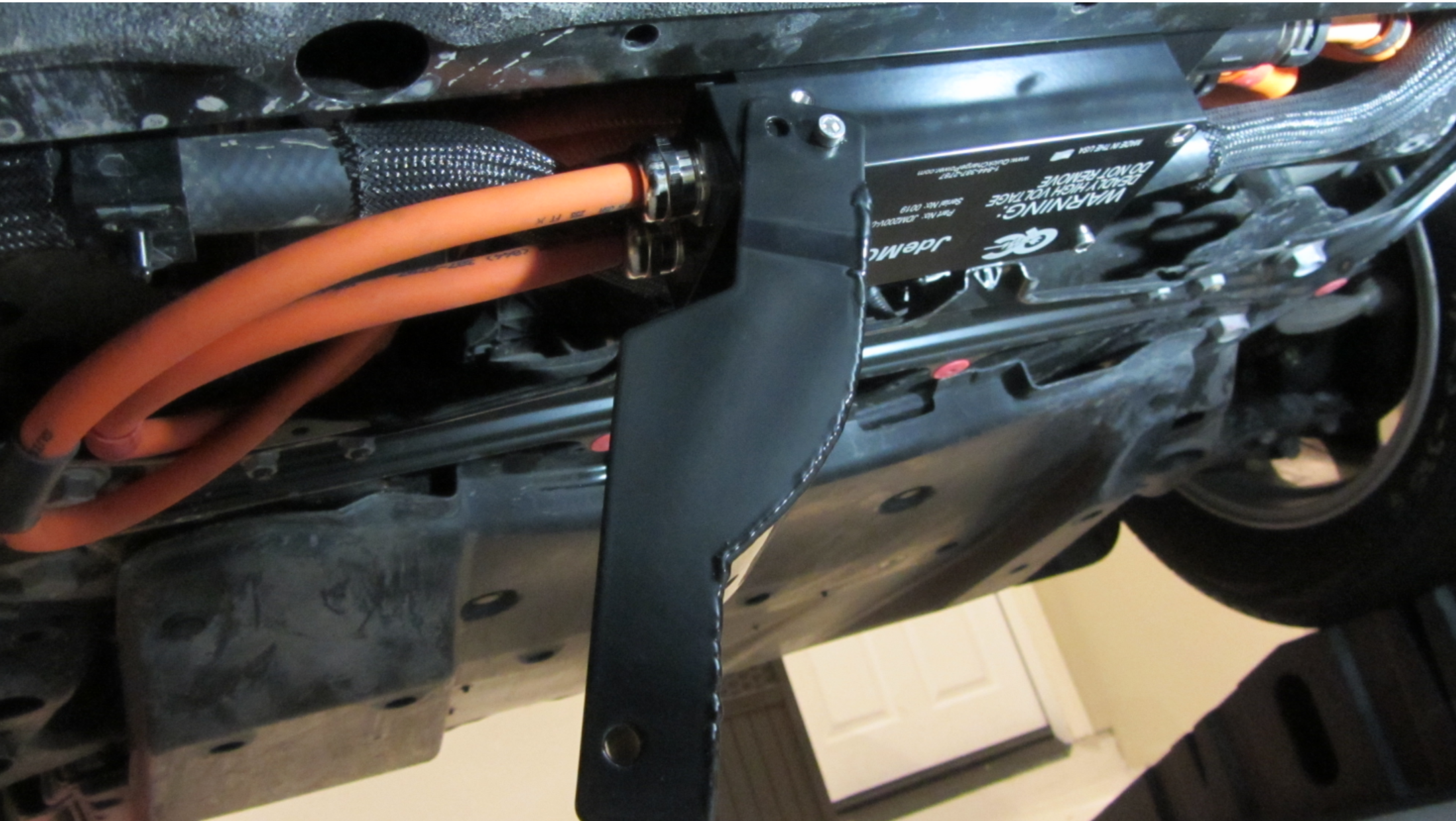

(for those who aren't familiar with it: QCP's JDemo kit adds CHAdeMO DCFC capability to 2012-14 RAV4 EV and MB B250e, and it taps the traction battery pack by adding a "bathtub" to replace a cover that's on the OEM pack, then replaces cable bolts with studs to allow mounting extra cables to where the LDU cables would normally bolt to the HV pack. It's a bolt-on solution that doesn't cut anything except the plastic underbody cover (though it does defeat the HVIL switch on the OEM's cover, which is not replaced) and as a warranty-saving DCFC kit, it was a good balance of compromises. The RAV4 EVs are all long out of warranty now, though . . . )
Reasons NOT to use a QC Power JDemo-style "bathtub" on the front of the RAV4 EV traction battery:
* The JDemo method is clunky. It hangs low enough to require that awful bathtub/cable guard arrangement.
* Fashioning/fabricating a "bathtub" cover that is IP67 is not trivial; QCP's bathtub appears well done, but duplicating it wouldn't be a snap, and testing it for IP67 is not easy without having a spare pack with which to spray it with water at pressure. It's located just above the pavement and at the front of the pack (and the opposite end of where it's located on a Model S!) so testing for water ingress is required. IOW, fab'ing it is expensive in terms of time/labor.
* A new HVJB is required for the DCFC contactors anyway, regardless of how you tap the pack. (JDemo puts the contactors up on top of the stack.)
For those reasons, the cost of a set of used Model S LDU cables is minor, and it's much simpler to connect to the existing (cut) LDU leads than to fab and test my own "bathtub" adapter.
Now, if you happen to already own a JDemo "bathtub", then perhaps reusing those taps makes sense. QCP doesn't sell the "bathtub" separately from the (USD$3,000) kit, so unless you have a JDemo installation you have to start from scratch. Adapting off-the-shelf Model S LDU cables + die-cast contactors enclosure is a lot simpler (and cleaner I'd argue) than the "bathtub" adapter + extension studs route.
Here's a few pics of the "bathtub" installation (taken from the JDemo installation manual PDF):

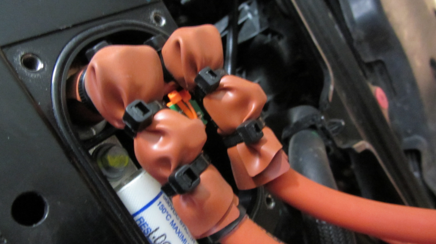

The CCS inlet port I have is from a BMW i3, and just holding it up in the fuel filler port area, it looks to be a tight-but-doable fit. The flap latch mechanism will likely have to go away, as I'll probably need that space. It will not surprise me to find I'll have to remove some of the sheet metal surrounding the current round gasket, squaring it up and removing the flap latch.
If you have a solution for mounting a CCS inlet -- ANYBODY'S -- to that space, I'm extremely interested. I wouldn't mind buying a different CCS1 inlet, if it fit the space better.

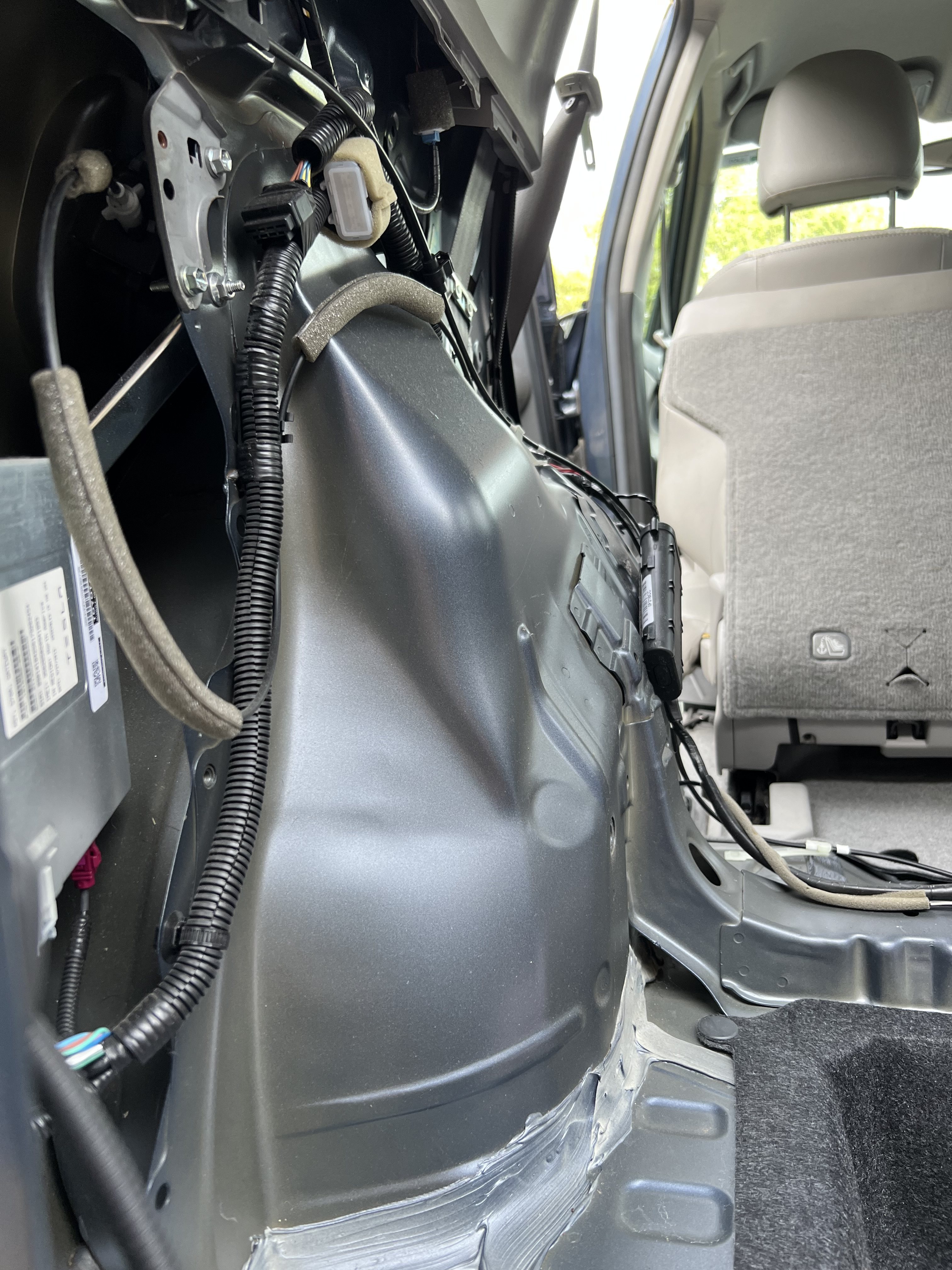

The cabling all runs down the front of the wheelwheel, outside the passenger compartment, and the new cabling should fit there nicely as well. I have not removed the inlet enough to take good measurements, but from a rough view there appears to be (possibly) enough room in the existing space to accommodate the CCS inlet.
If it occurs that a CCS inlet can't fit due to lack of depth, there's plenty of room inside to carve out an oblong hole, and from my cursory measurement it doesn't appear that this would entail modifying the plastic interior trim -- there is a little space (not much) between the side plastic panel and the metal behind it. The CCS' lock motor on the BMW part does not appear to fit well. How much metal will need to be removed will need investigation, and I've been sidelined by adding A/C to my residence :(

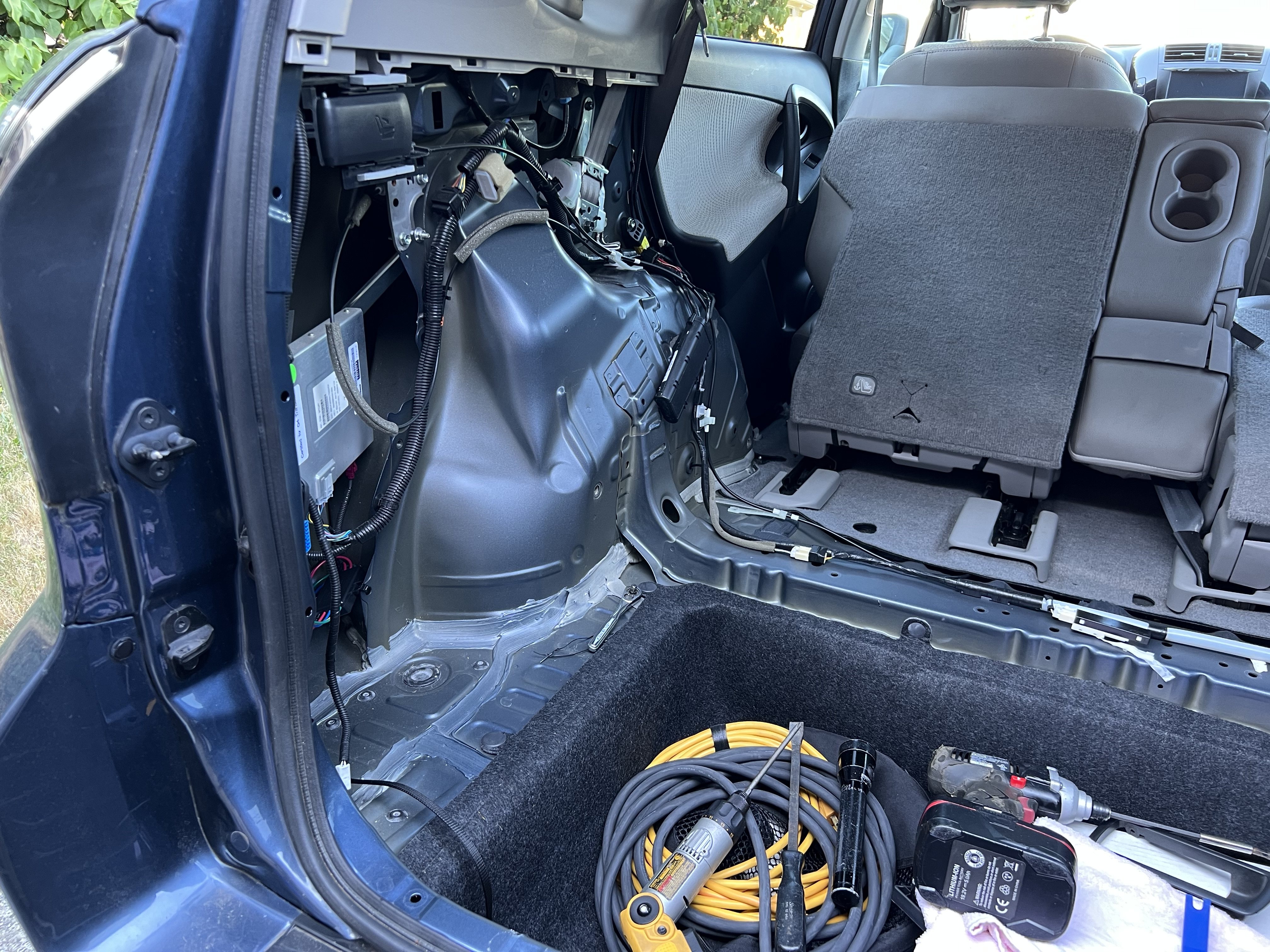

The following pics are with the interior side panel removed, when I added trailer/tow wiring and signal converter a couple of weeks ago:

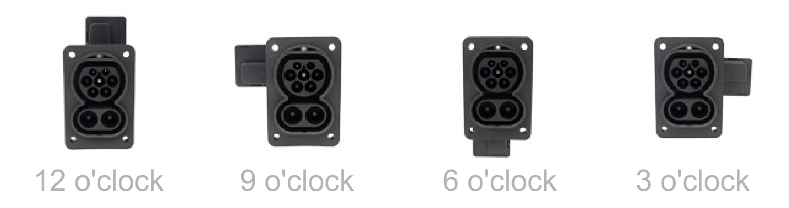

It appears they have 3 different after market versions of this connector, all with different mounting bolt locations.

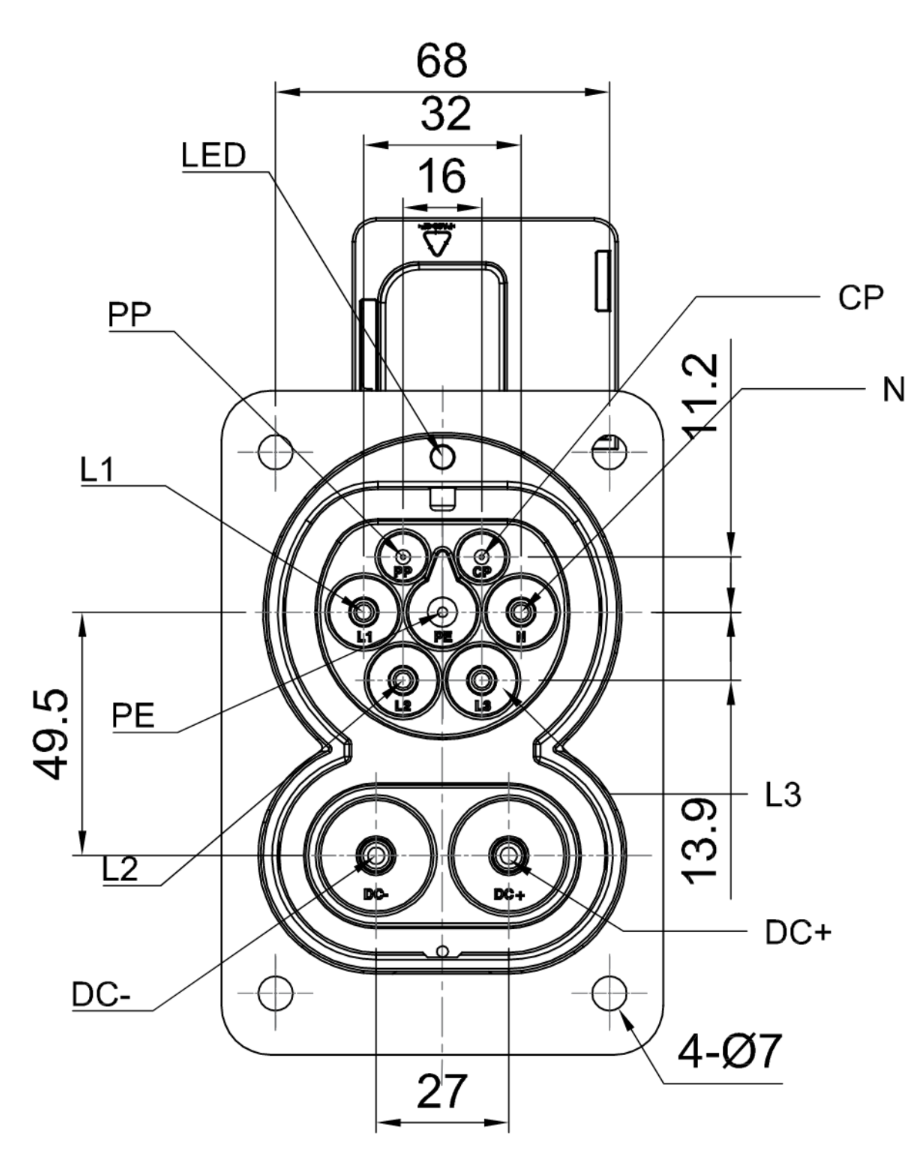

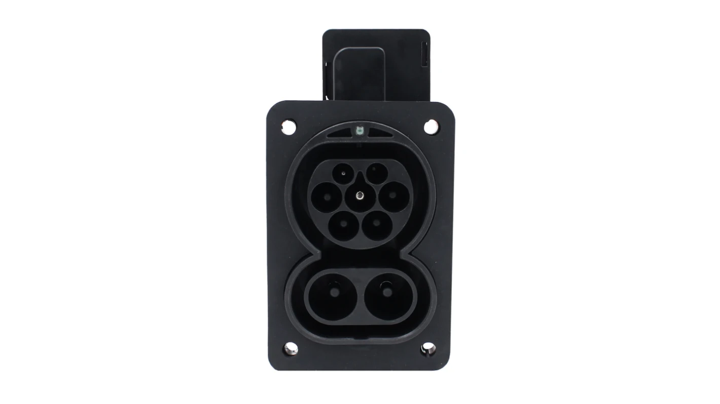

Attached is screenshot of a aftermarket connector I considered, if we still want to replace the J1772 connector.
This connector may be better than the one for the BMW i3, because it sticks out forward more.

Shockazulu1 wrote: Tue Jul 18, 2023 10:58 am Attached is screenshot of a aftermarket connector I considered, if we still want to replace the J1772 connector.

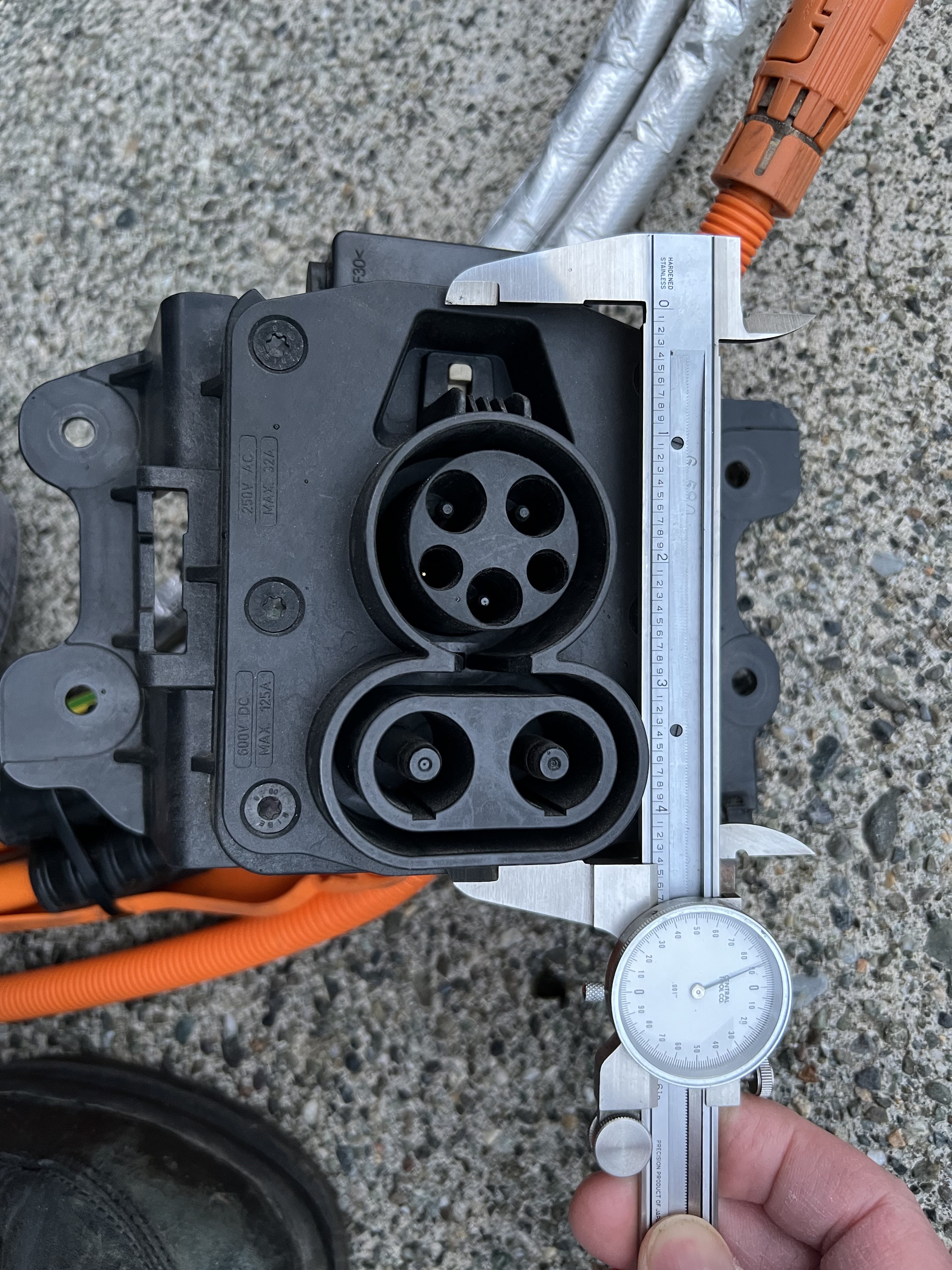

BMW i3:
Is there an advantage to having the port project forward more? ATM, I don't know what space is available, and there's always going to be a trade-off: a port that projects forward still has to fit behind the fuel flap door, so it just moves the mounting flange back further. Put another way, the total distance front to back is likely to be the same.

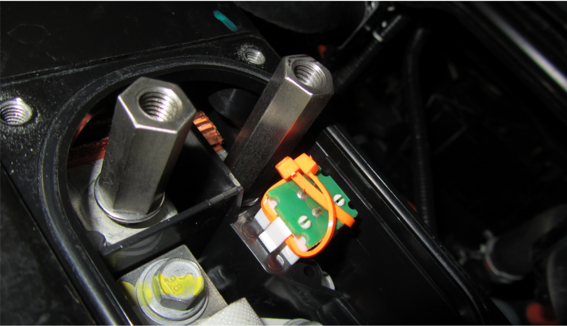

If you remove the J1772 port on your RAV4, behind that is a bracket.
I intend to make a new bracket to replace that one.
I will 3d print the bracket with ABS plastic.

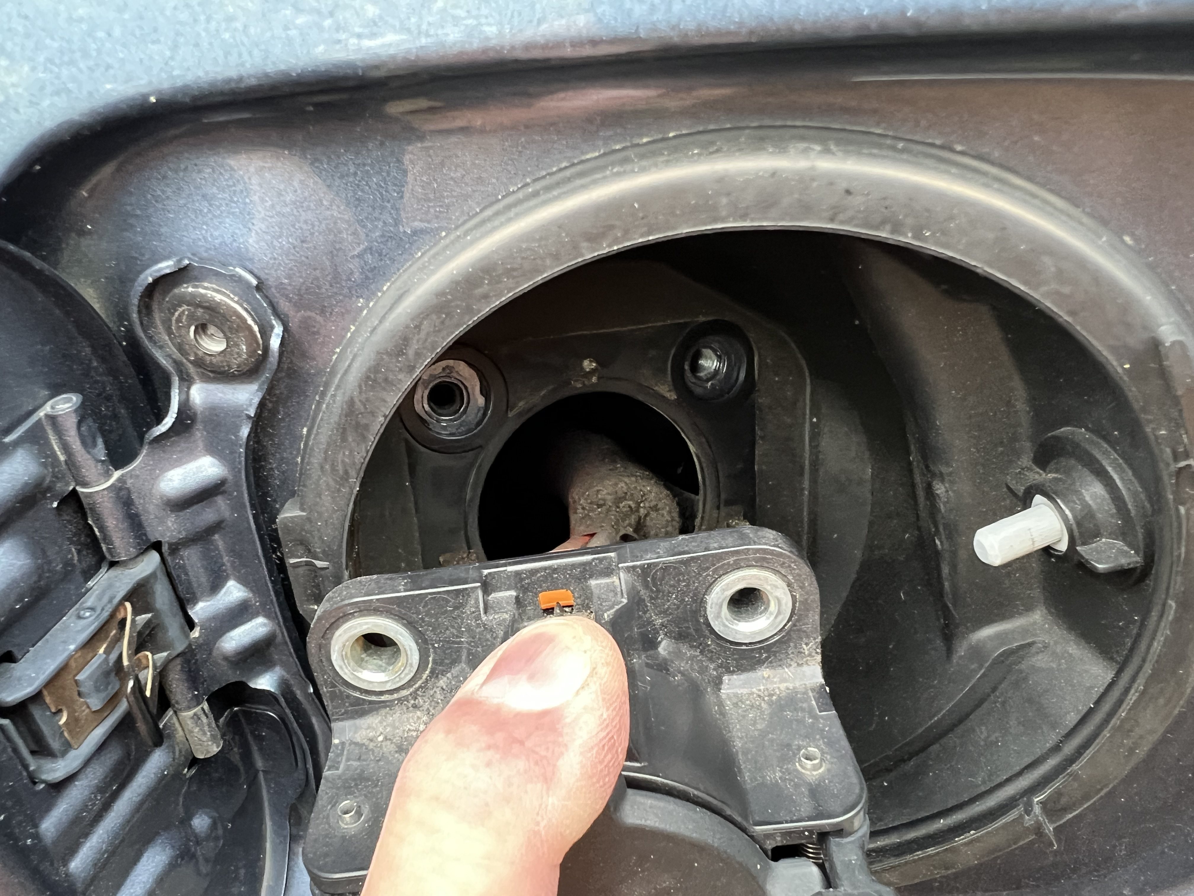

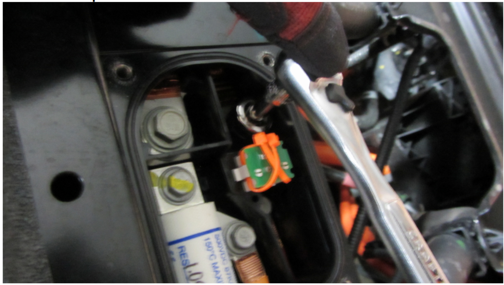

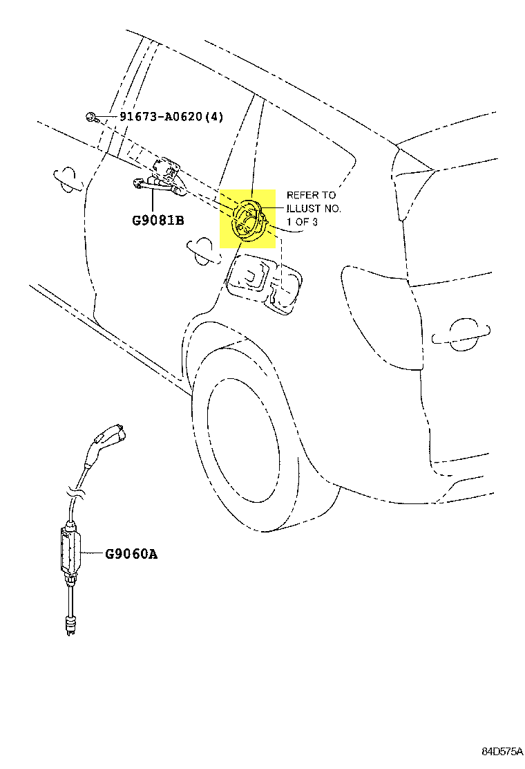

This?

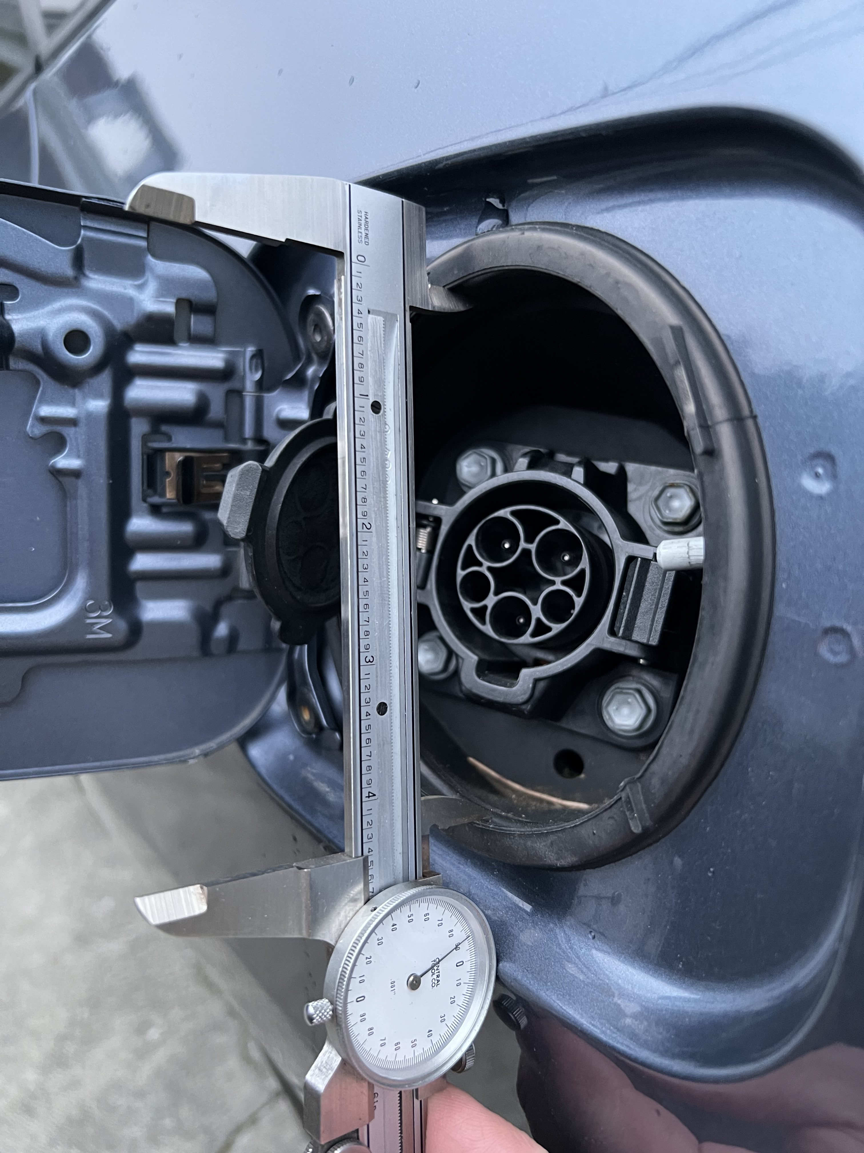

The inlet socket and some leads, G9081-0R01x (three different part Nos., because the 2012 at least didn't have a connector nearby and you had to drop the battery pack to replace a melted J1772 socket -- Thanks, Blink!) bolts to what appears to be a free-floating bit of plastic with molded flexible rubber around it, 58446-0R010, retained to the round hole in the fuel filler area by a circular metal retainer 77391-0R010.
I must be misunderstanding what your ABS bracket will attach to. The circular opening where that thing I will call a "grommet" attaches is too small to accommodate my CCS1's face. Some metal will need to be removed, I'm pretty sure.
Some of the metal bits back there:
These diagrams are maddeningly difficult to get; Toyota is putting completely unrelated diagrams next to correct part Nos., and even diagrams from completely different vehicles :( Third-party sites do much better, but watermark their work.

I'm reasonably certain that a CCS inlet will not fit within the current circular location. The bottom of the CCS connector is flat. Maybe modifying the top of the CCS port, eliminating the lock? Not recommended, but . . . what's your risk tolerance?
If you're not amenable to cutting metal at the fuel filler area, then you might look at installing at the grille area. Or try to figure out how to use NACS.
Looking at the view of the charger socket area, it looks like everything is almost welded together.
May be difficult to create any space inside for the larger connector.
I'll make a attempt to take it apart when I get home from work today.

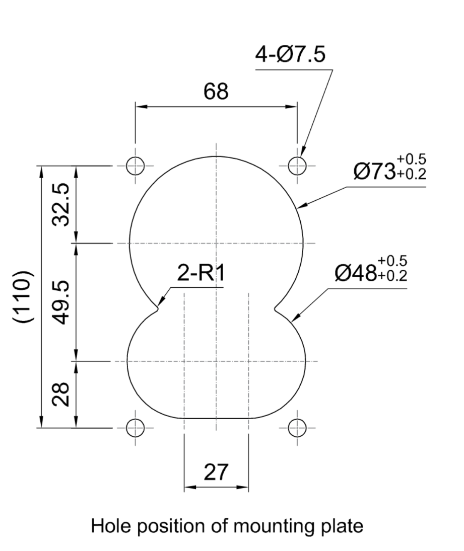

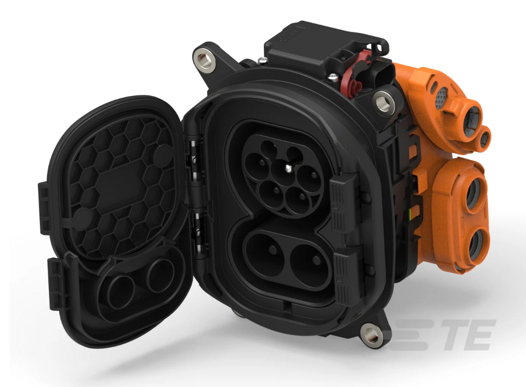

Well, the metal parts are spot welded and seam sealed: typical construction. There are two fitment issues:
* Is there enough depth? Can the cables make the 90° turn forward? There exist CCS ports where the leads exit to the side; they can be ordered "leads left" or "leads right", but I've only seen them for commercial vehicles, and it doesn't appear to reduce the depth requirement.
TE Connectivity:
https://ie.rs-online.com/web/p/ev-charg ... 83524?gb=b
Something I've just come across that might fit better is something akin to the Amphenol HVCO series of CCS inlets, in which the lock motor location can be selected from various options:
https://ie.rs-online.com/web/p/ev-charg ... 41919?gb=b
Datasheet: https://docs.rs-online.com/6228/0900766b81638f58.pdf
One issue I see -- which is also an issue with other CCS inlet ports -- is that the rated current for the AC pins is only 32A; as you know, we can draw up to almost 40A. Surely a reason to go with a separate CCS port somewhere else, leaving the OEM one in place. In that case, you'd install a DC-only CCS port, which is an available option:
I don't have time to look for a comparable CCS1 version of this today.
A 1-ph (CCS1) version is https://www.amphenolpcd.com.cn/products ... i-791.html, with 7 pins rather than 9.

There is space in this bumper location for me to design a solid mount.
There is one metal strap/bar for a base. But I'll need to make metal bracing to stuffin up the strap/bar.
Once solid I'll add the 3d printed mounting block/plate for our connector to bolt onto. Gonna be sold enough to hold the charge cable firm even under all the weight of the heavy cord.

I'm now thinking, going the NACS Tesla connector route will just add more complications.
We are gonna have to put the CCS1 port directly on the front, and we will make a nice looking door to cover it up.
I'm thinking of mounting sideways with the bottom pointing twards the passenger side, so the cord will come from the same area where they charge Tesla (sort of). A Tesla charging port is on the rear driver's side and they back into the charging stations. We will pull straight in and use a charger on the front right.
Using this front location we can take care of this installation last.
We can do all our wiring, electronics and testing first before permanently mounting the connector to the front.
It's gonna take a bit of wire but not to much, to go around the cooling system that's mounted behind the bumper.
During our initial testing we will be able to temporarily mount the connector under the hood, and do the dreaded open the hood to plug in the charger.
