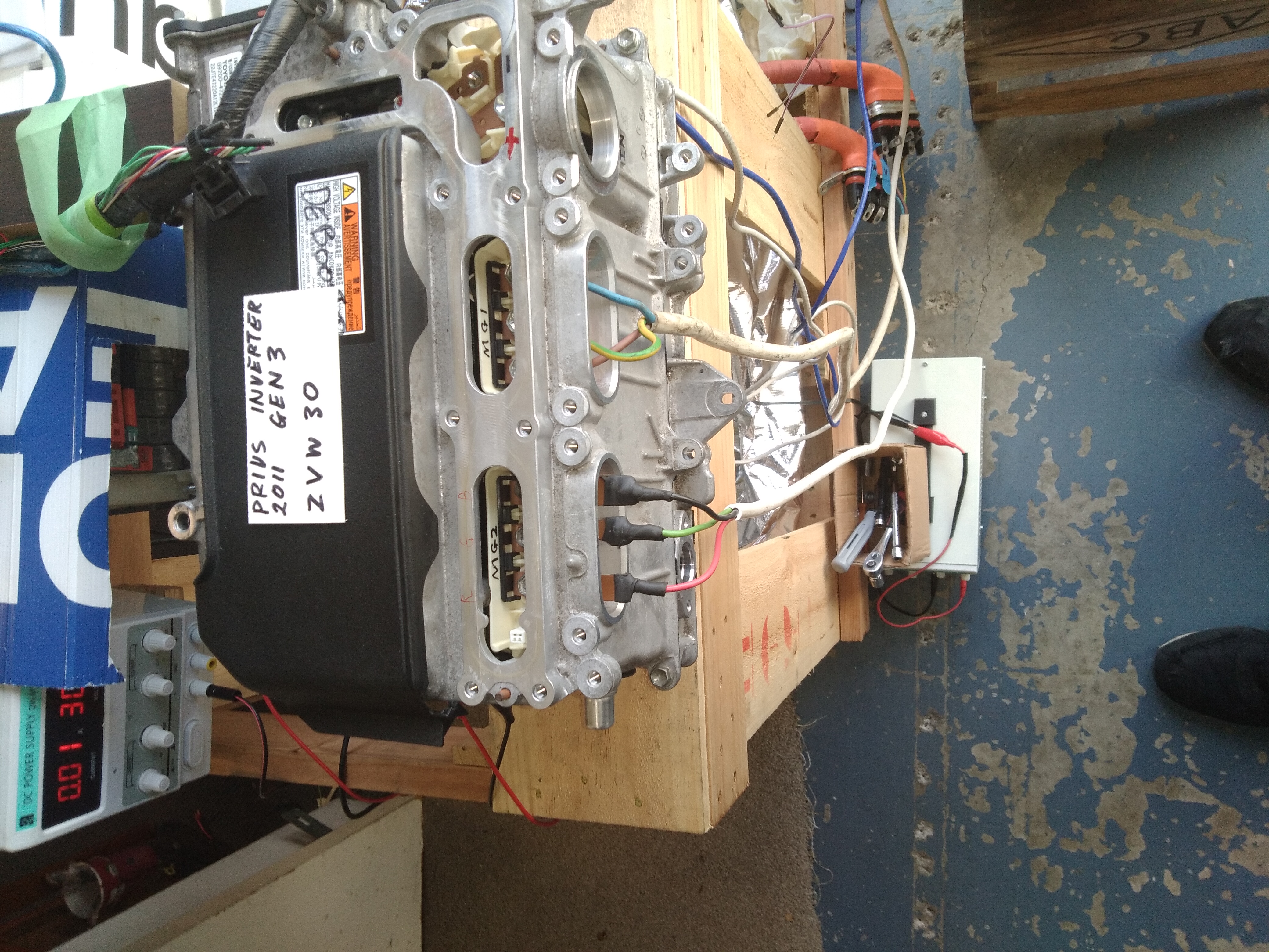

: Some work progressing on ZVW30 inverter,
or Gen3 Prius Inverter.
An attempt to re use ones that have damaged Boost components and have little scrap value at present,
This post in Hyper car hybrid Thread,
But I feel is relevant here.

Prius gen 3 ZVW30 inverter
Highlander MGR
and Lexus gs300h, L210 trans
Controlled by sync serial MTH, HTM, REQ, CLK

A Summary of last weeks progress
Gen3 inverter , with defunct Boost converter removed
A Good one works also.

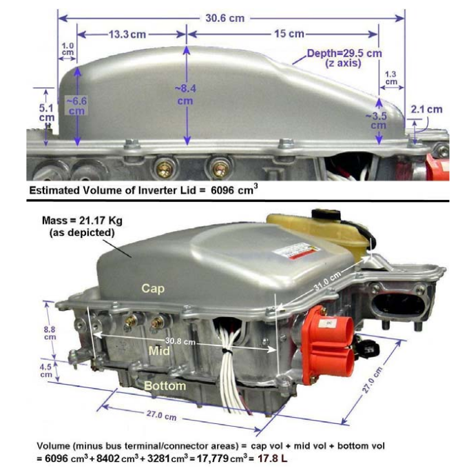

Please could someone post the external dimensions from gen2 and gen3 inverters?
(ideally with a photo, in the same way as it is in the yaris inverter wiki)
thanks
EDIT: I found this image for gen2.
thanks

Ahem. Add to wiki please.
