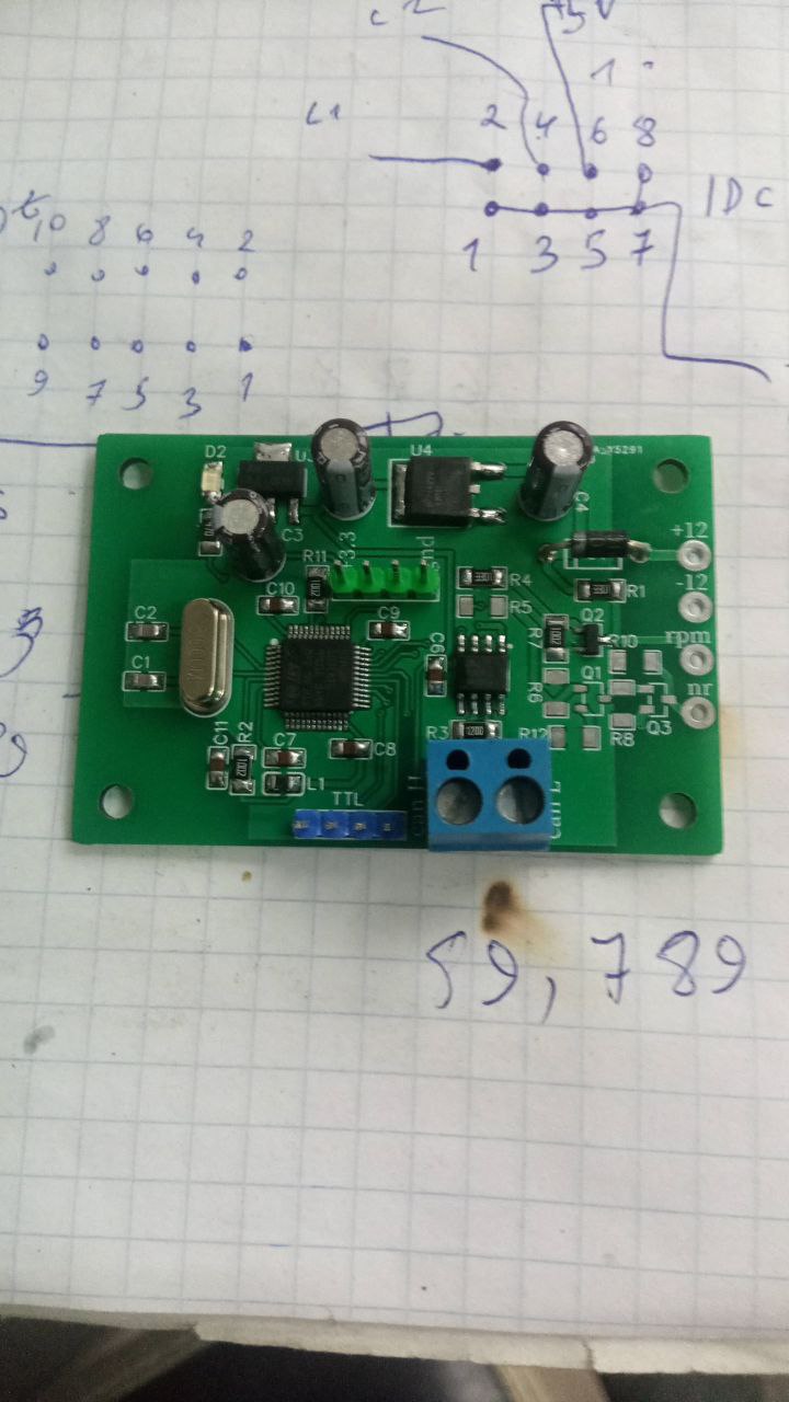

hi. I also ran into such a problem on my Audi a4, I put together a device that listens to can and translates into a meander with a frequency that varies depending on the RPM
yaroslav
Posts: 176
Joined: Tue Aug 13, 2019 4:32 pm
Location: Russia, Stavropol
Has thanked: 14 times
Re: PWM OUT! the output for the tachometer, how to set it up correctly? Is it possible?
Post by yaroslav »
I made the first device on arduino, I can put all the material on it here, the minus is that it does not always read can, I am currently developing the second device on stm32
yaroslav
Posts: 176
Post by yaroslav »
Here is the code for arduino
freq.ino
(1.9 KiB) Downloaded 480 times
yaroslav
Posts: 176
Post by yaroslav »
you will also need the mc2515 modules
https://aliexpress.ru/item/32817132818. ... 85d1blr7QV
and arduino nano
yaroslav
Posts: 176
Post by yaroslav »
and here is the second device on stm32, I almost wrote the program code, it remains to debug a little, the problem is that the tachometer sometimes jumps, I'll deal with it later

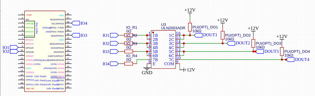

rstevens81
Posts: 386
Location: Bristol, UK
Has thanked: 29 times
Been thanked: 114 times
Post by rstevens81 »
it needs to be done in software as the hardware timers do not work at low frequencies...the problem i found i hadwas it went in steps for the esp32 using hardware timers...(which used in the clip)... i will update with some arduino code for a nano shortly...
edit:
I believe this is code that can be adapted from a nano to generate a suitable tach signal:
https://github.com/chippernut/RPM-Signa ... erator.ino
(the esp32 does not have the tone command so it all gets more difficult)

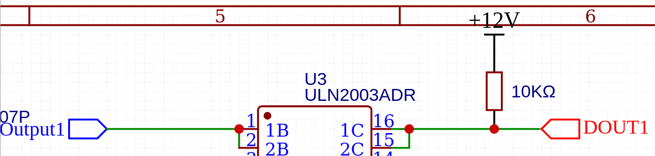

I believe this will generate the signal if connected to an uln on the output and a resistor to create a +12v signal (reversed duty of course) ... or better yet a fan3112tmx (what i was using)
https://github.com/vdeschwb/esp32-signal-generator
to be of use for us you would need to unpick the code...i have been busy on the practical car stuff whilst it not been raining so haven't had a change to dig deeply.
rstevens81
Posts: 386
OK i'm an idiot!!! (Occam's razor)
The simplest way is the right way !!
This is basically a rehash of Blinkwithoutdelay (https://assiss.github.io/arduino-zhcn/c ... Delay.html)
as we a not dealing with super fast frequencies just using the raw rower of the esp32 is enough to create a smooth rpm sweep, my intentions is to create a function that deals with the timings on the second core ... but for now this is what works.
Also this works if you use a uln2003 and a resistor to +12v (pullup)

rstevens81 wrote: Wed Oct 11, 2023 8:08 pm OK i'm an idiot!!! (Occam's razor)

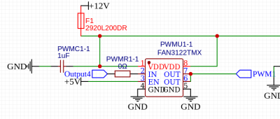

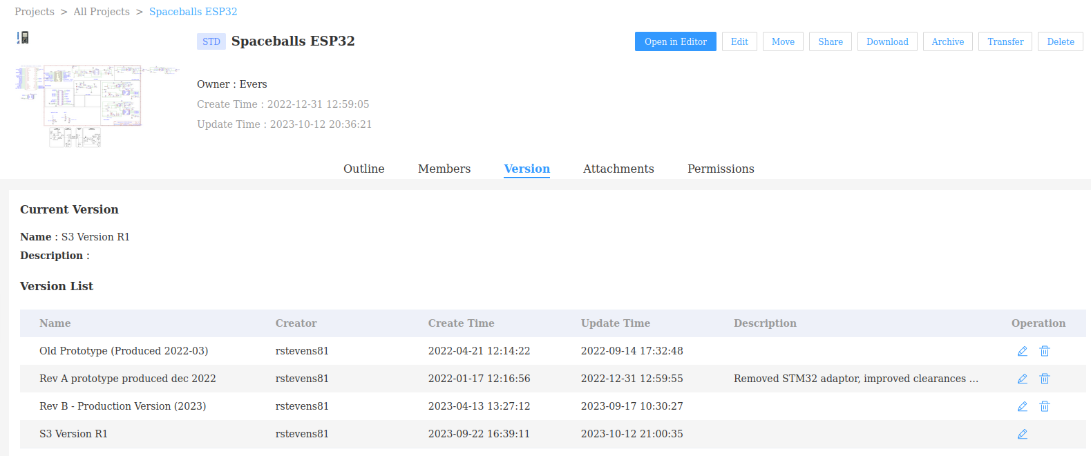

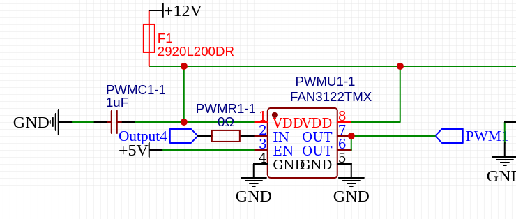

I'm using my spaceballs board ..... https://oshwlab.com/EV-Team/spaceballs ...just because i have them to hand :) if your interested make sure you use the RevB as that's the most complete 4 layer board (the S3 version is WIP and based on using a XIAO ESP32S3 and is intended to be DIYable board with Through hole design). But there is no ne3ed for anything that elaborate as proto board with an aliexpress bits will work :)
If you need to generate a +12v signal then the arrangement below worked really well...
if you omit the pull up resistor you can do negative switched pwm, which worked well to drive my fuel gauge :)
I like the ULN2003 as its cheap and comes in though hole for breadboarding or proto boarding :)
if you want switched or (Powerfull PWM e.g. small fan) +12v then your going to need to use something like FAN3122TMX this is a smd but damian uses it on his zombie.
For really easy PCB design i would recommend easyeda for beginners as its quite easy to pick up :) .. just make sure you check for DRC errors before manufacture :)
The actual coding is quite simple it loops round and we set an interval between the change of state from high to low once that time has been exceeded it switches.... the second timer is just used to increase and decrease that time to simulate increase and decrease in rpm.
Moving forward I Will be putting mycode in github (with much more explanation) which will take can messages from the car & BMS and convert them into signals (most of them PWM) once i have made some progress ill post in my build thread and post a link here :)
