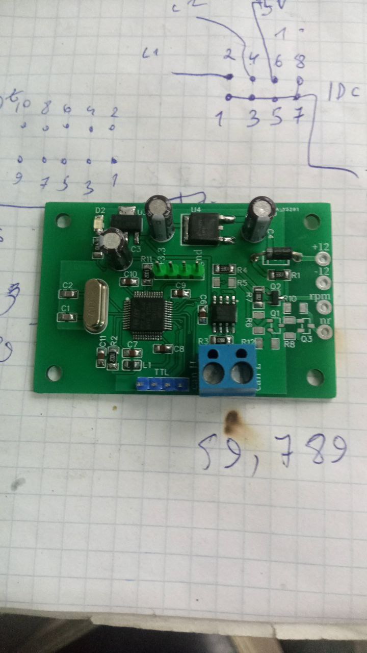

hi. I also ran into such a problem on my Audi a4, I put together a device that listens to can and translates into a meander with a frequency that varies depending on the RPM
yaroslav
- Posts: 176
- Joined: Tue Aug 13, 2019 4:32 pm
- Location: Russia, Stavropol
- Has thanked: 14 times
- Been thanked: 5 times
Re: PWM OUT! the output for the tachometer, how to set it up correctly? Is it possible?
I made the first device on arduino, I can put all the material on it here, the minus is that it does not always read can, I am currently developing the second device on stm32

and here is the second device on stm32, I almost wrote the program code, it remains to debug a little, the problem is that the tachometer sometimes jumps, I'll deal with it later

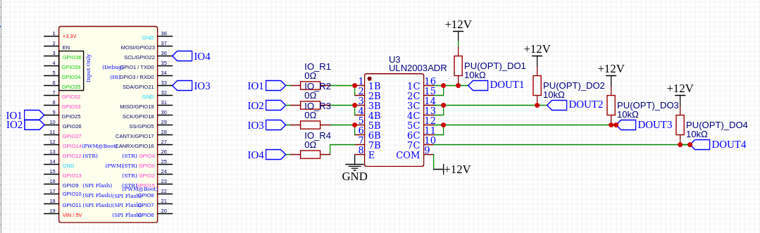

In my EV conversion I expected to use pin18 of my O.I.v2 so that my tachometer would work but I was disappointed when reading this thread that this just not work. Believer in the KISS philosophy and without wanting to start learning how to program Arduino, I would like to know if someone has implemented a simple way to make the tachometer work, and the solution that Romale mentioned with ss411a comes to mind.Romale wrote: ↑Sat Apr 08, 2023 8:11 pm Ill. if it is not possible to get an out from the PWM, in general, do not invent anything and do not glue magnets. you can simply open the cover of the Nissan leaf motor and paste one ss411a hall between the grooves of the motor hide. this will give a very high-quality 4 pulses per revolution.
Yeah I'm also intrigued by that!
- rstevens81
- Posts: 381
- Location: Bristol, UK
- Has thanked: 29 times
- Been thanked: 114 times
it needs to be done in software as the hardware timers do not work at low frequencies...the problem i found i hadwas it went in steps for the esp32 using hardware timers...(which used in the clip)... i will update with some arduino code for a nano shortly...
edit:
I believe this is code that can be adapted from a nano to generate a suitable tach signal:
https://github.com/chippernut/RPM-Signa ... erator.ino
(the esp32 does not have the tone command so it all gets more difficult)
I believe this will generate the signal if connected to an uln on the output and a resistor to create a +12v signal (reversed duty of course) ... or better yet a fan3112tmx (what i was using)
https://github.com/vdeschwb/esp32-signal-generator
to be of use for us you would need to unpick the code...i have been busy on the practical car stuff whilst it not been raining so haven't had a change to dig deeply.
edit:
- rstevens81
- Posts: 381

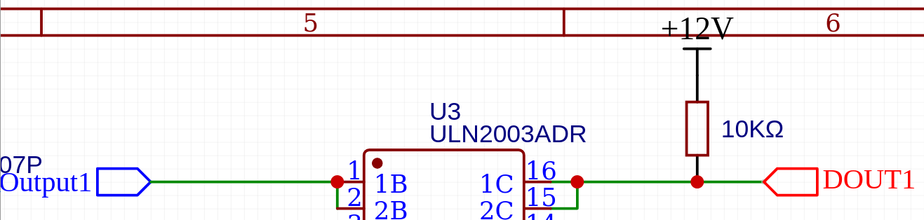

OK i'm an idiot!!! (Occam's razor)
The simplest way is the right way !!
This is basically a rehash of Blinkwithoutdelay (https://assiss.github.io/arduino-zhcn/c ... Delay.html)
as we a not dealing with super fast frequencies just using the raw rower of the esp32 is enough to create a smooth rpm sweep, my intentions is to create a function that deals with the timings on the second core ... but for now this is what works.
Also this works if you use a uln2003 and a resistor to +12v (pullup)

rstevens81 wrote: ↑Wed Oct 11, 2023 8:08 pm OK i'm an idiot!!! (Occam's razor)
const int ledPin = 26; // the number of the LED pin // Variables will change: int ledState = LOW; // ledState used to set the LED long previousMicros = 0; // will store last time LED was updated long previousMillis = 0; // will store last time LED was // the follow variables is a long because the time, measured in miliseconds, // will quickly become a bigger number than can be stored in an int. long interval = 1000000; // interval at which to blink (milliseconds) long update_interval = 50; // interval at which toupdate/print float myrpm =500; int dirn =1; void setup() { // set the digital pin as output: pinMode(ledPin, OUTPUT); Serial.begin(115200); } void loop() { // here is where you'd put code that needs to be running all the time. // check to see if it's time to blink the LED; that is, if the // difference between the current time and last time you blinked // the LED is bigger than the interval at which you want to // blink the LED. unsigned long currentMicros = micros(); if(currentMicros - previousMicros > interval) { // save the last time you blinked the LED previousMicros = currentMicros; // if the LED is off turn it on and vice-versa: if (ledState == LOW) ledState = HIGH; else ledState = LOW; // set the LED with the ledState of the variable: digitalWrite(ledPin, ledState); } unsigned long currentMillis = millis(); if(currentMillis - previousMillis > update_interval) { // save the last time you blinked the LED previousMillis = currentMillis; interval = 15000000/myrpm; // RPM to Time Serial.print (myrpm); Serial.print ("/min "); Serial.print (interval); Serial.println (" microseconds"); if (dirn==1) { myrpm=myrpm+100;} if (dirn==0) { myrpm=myrpm-100;} if (myrpm >7500) {dirn=0;} if (myrpm <500) {dirn=1;} } }
It is very cool! just what you need. could you give more information for people far from programming? for example, a photo of the device, a connection diagram, etc. thank you!

- rstevens81
- Posts: 381

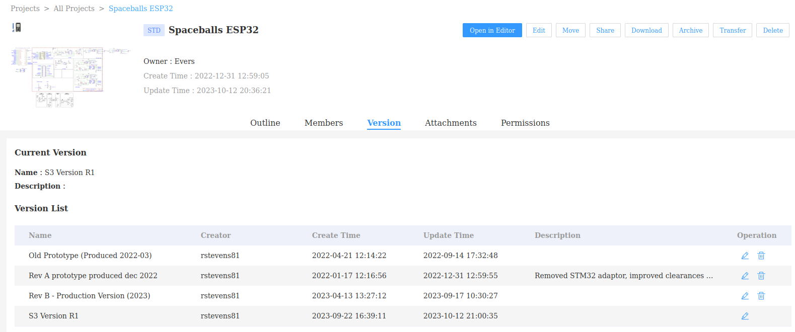

I'm using my spaceballs board ..... https://oshwlab.com/EV-Team/spaceballs ...just because i have them to hand
if your interested make sure you use the RevB as that's the most complete 4 layer board (the S3 version is WIP and based on using a XIAO ESP32S3 and is intended to be DIYable board with Through hole design). But there is no ne3ed for anything that elaborate as proto board with an aliexpress bits will work

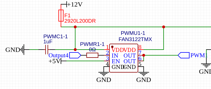

If you need to generate a +12v signal then the arrangement below worked really well...
if you omit the pull up resistor you can do negative switched pwm, which worked well to drive my fuel gauge
I like the ULN2003 as its cheap and comes in though hole for breadboarding or proto boarding
if you want switched or (Powerfull PWM e.g. small fan) +12v then your going to need to use something like FAN3122TMX this is a smd but damian uses it on his zombie.
