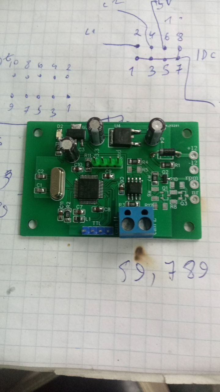

Re: PWM OUT! the output for the tachometer, how to set it up correctly? Is it possible?
hi. I also ran into such a problem on my Audi a4, I put together a device that listens to can and translates into a meander with a frequency that varies depending on the RPM
I made the first device on arduino, I can put all the material on it here, the minus is that it does not always read can, I am currently developing the second device on stm32
and here is the second device on stm32, I almost wrote the program code, it remains to debug a little, the problem is that the tachometer sometimes jumps, I'll deal with it later

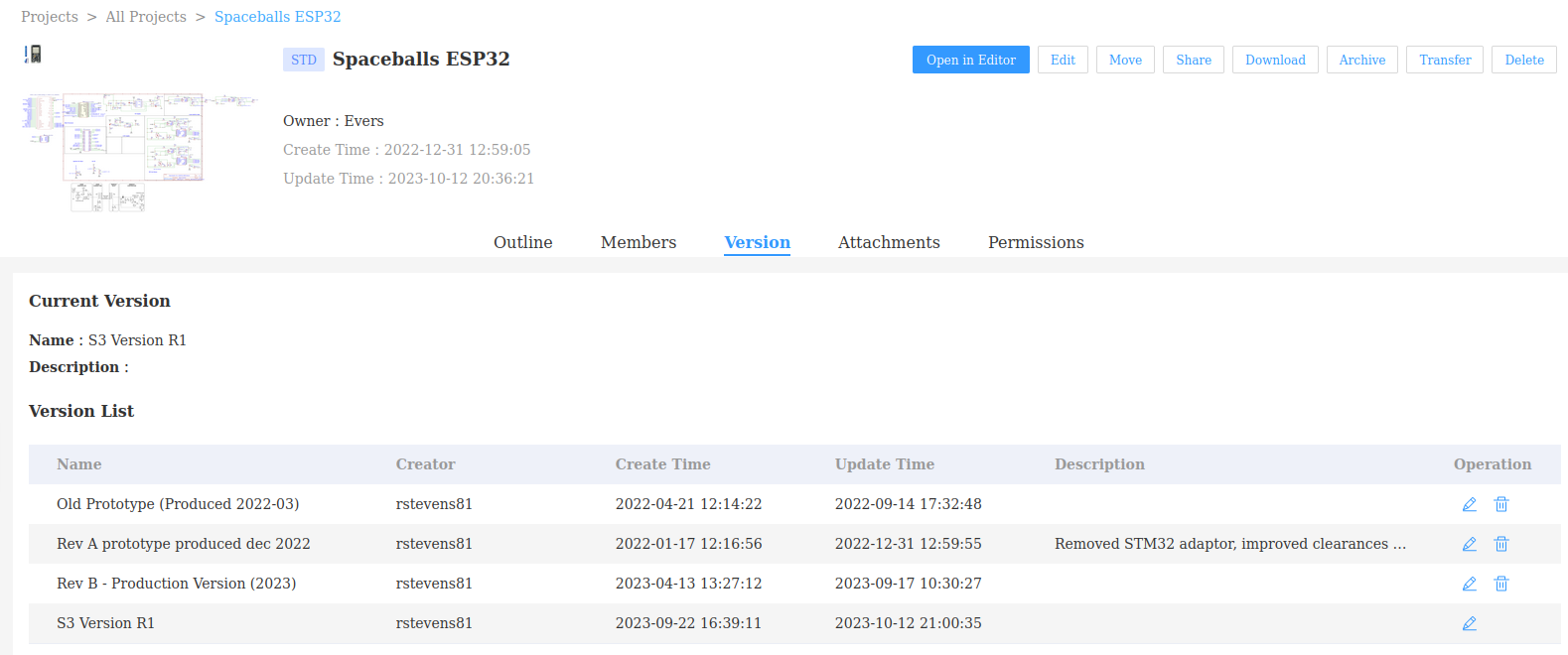

I'm using my spaceballs board ..... https://oshwlab.com/EV-Team/spaceballs ...just because i have them to hand
if your interested make sure you use the RevB as that's the most complete 4 layer board (the S3 version is WIP and based on using a XIAO ESP32S3 and is intended to be DIYable board with Through hole design). But there is no ne3ed for anything that elaborate as proto board with an aliexpress bits will work

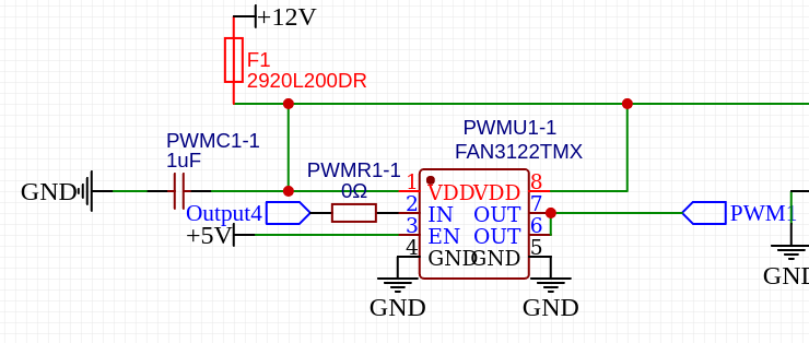

If you need to generate a +12v signal then the arrangement below worked really well...
if you omit the pull up resistor you can do negative switched pwm, which worked well to drive my fuel gauge
I like the ULN2003 as its cheap and comes in though hole for breadboarding or proto boarding
if you want switched or (Powerfull PWM e.g. small fan) +12v then your going to need to use something like FAN3122TMX this is a smd but damian uses it on his zombie.
