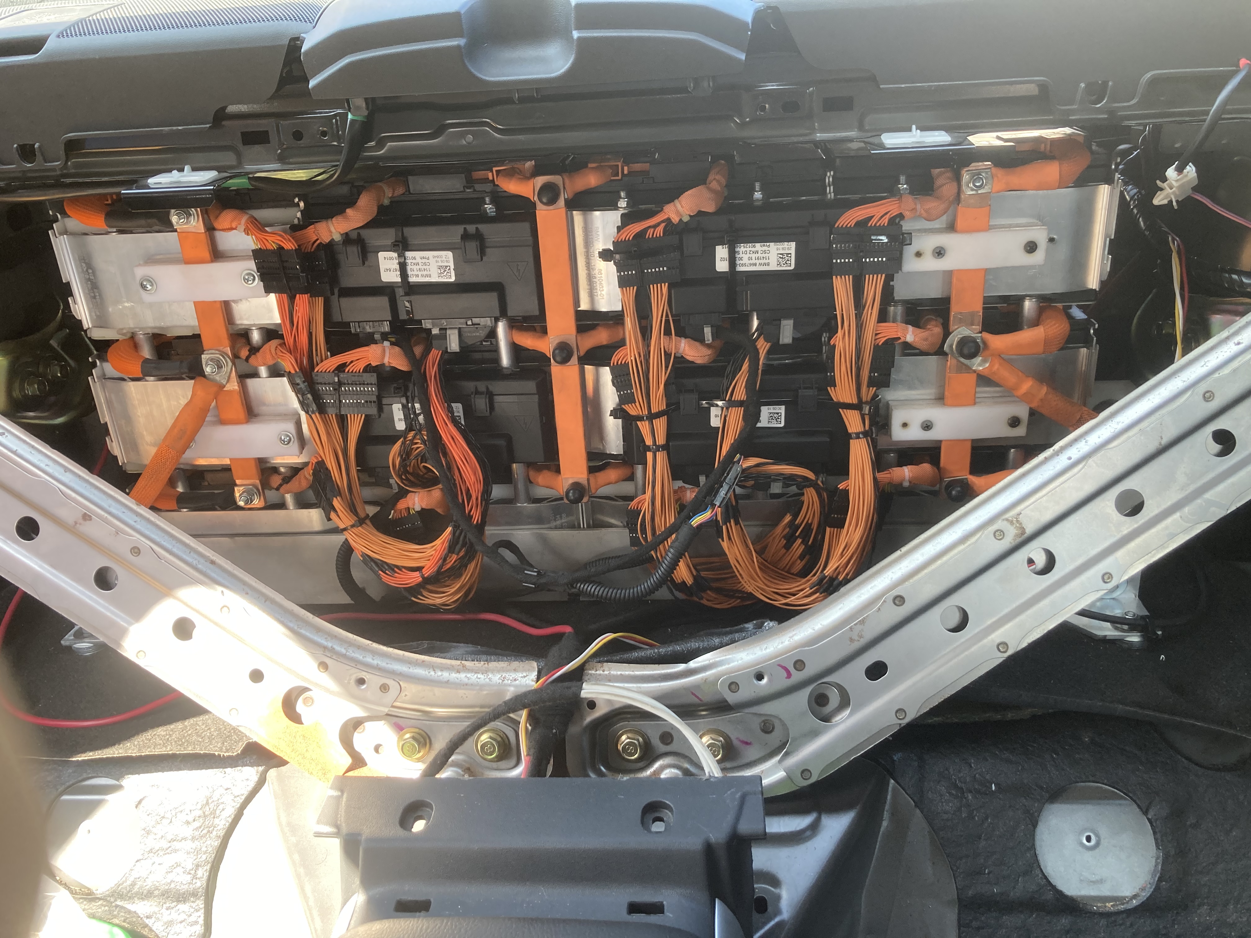

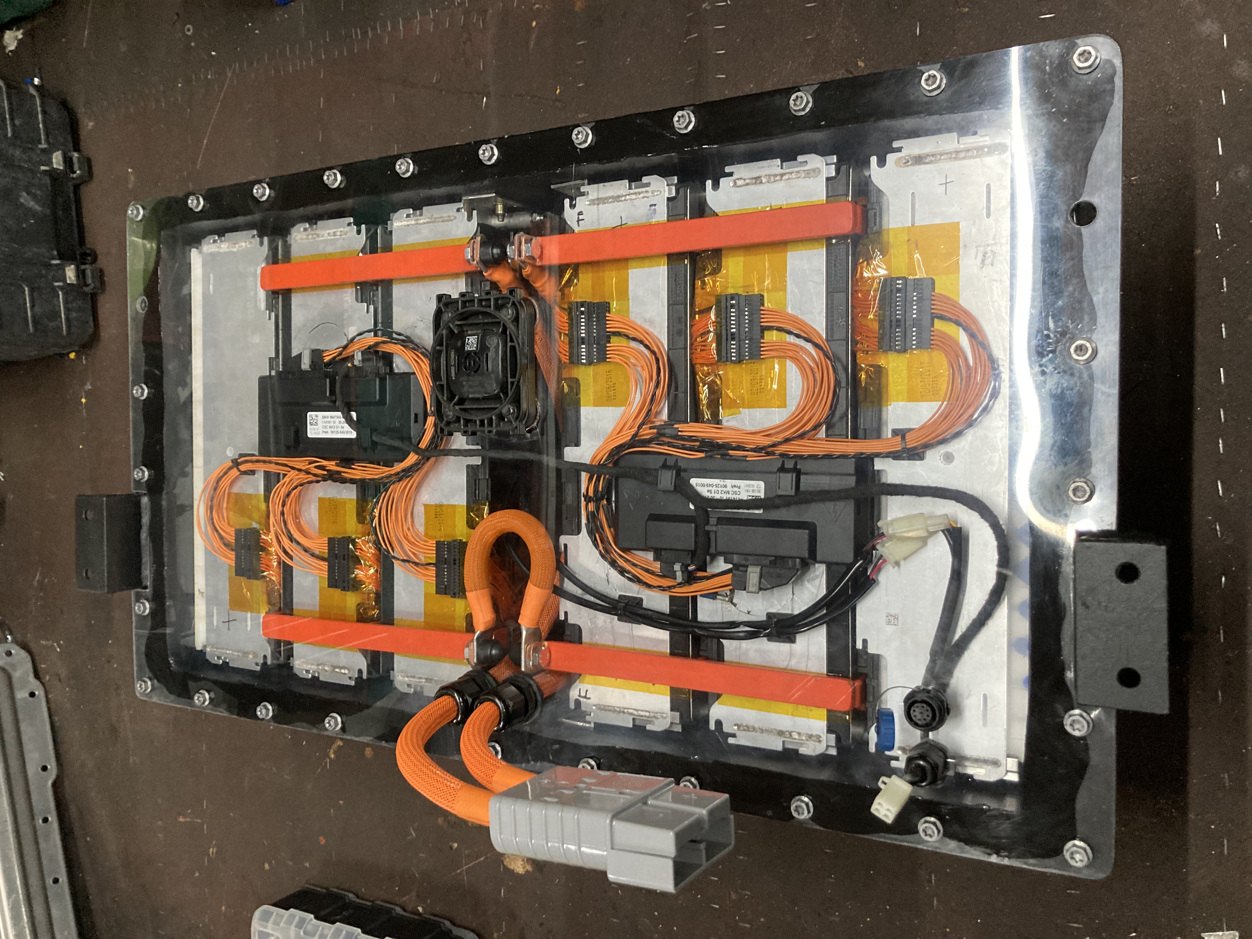

Posts: 835
Has thanked: 44 times
Been thanked: 173 times
Re: Dual BMW Hybrid packs?
Post by Ev8 »
I currently am running 18 modules 6s3p paralleled at the cell level via cell taps and module level, each parallel set of 3 modules share 1 bms, currently working on designing some simple plugin pcbs with fuseable links, but I’ve run without them for 2 years, probably time to do something about that right….
When I built this I was completely reliant on existing code, I would probably follow a different route now…
