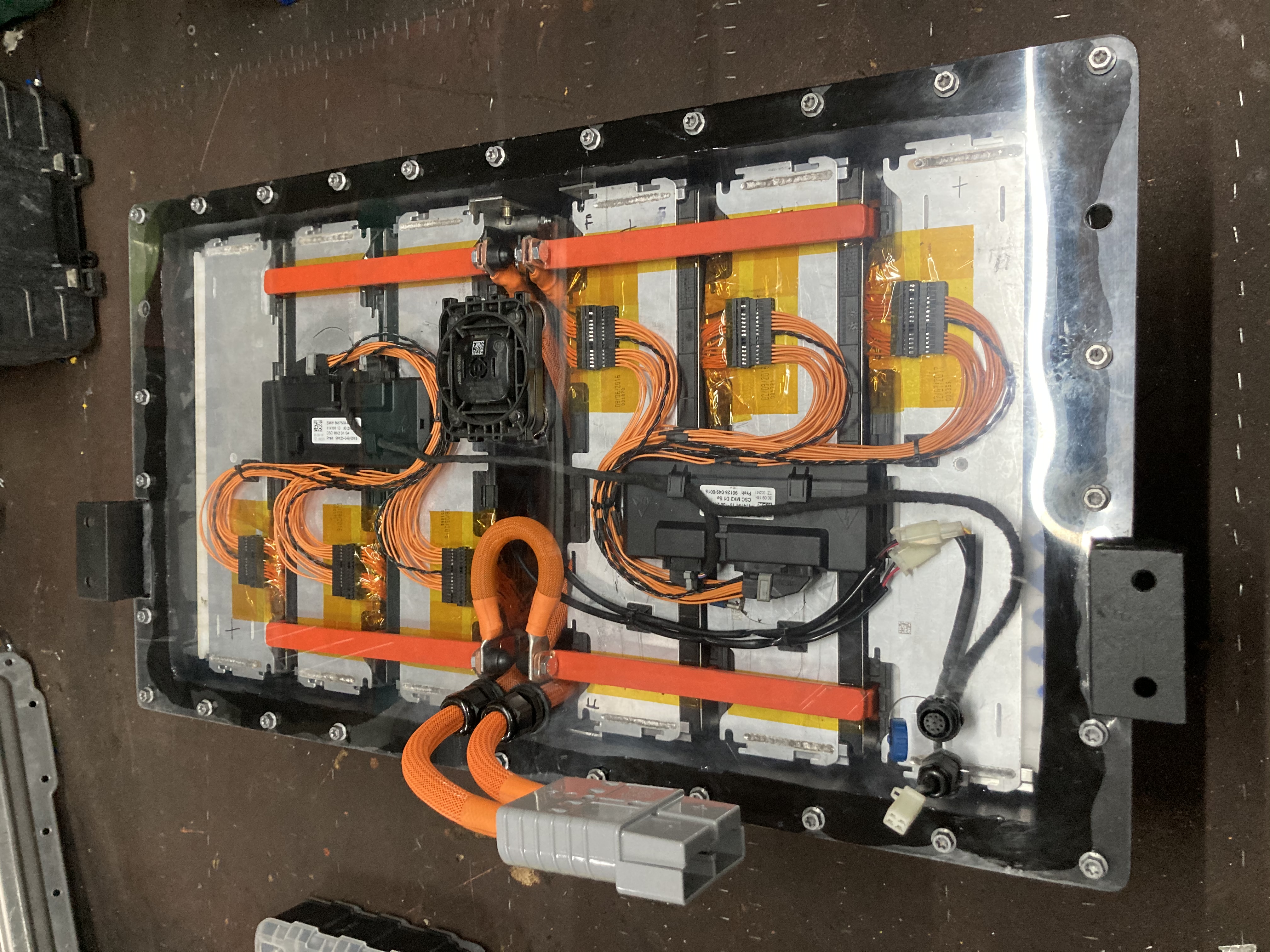

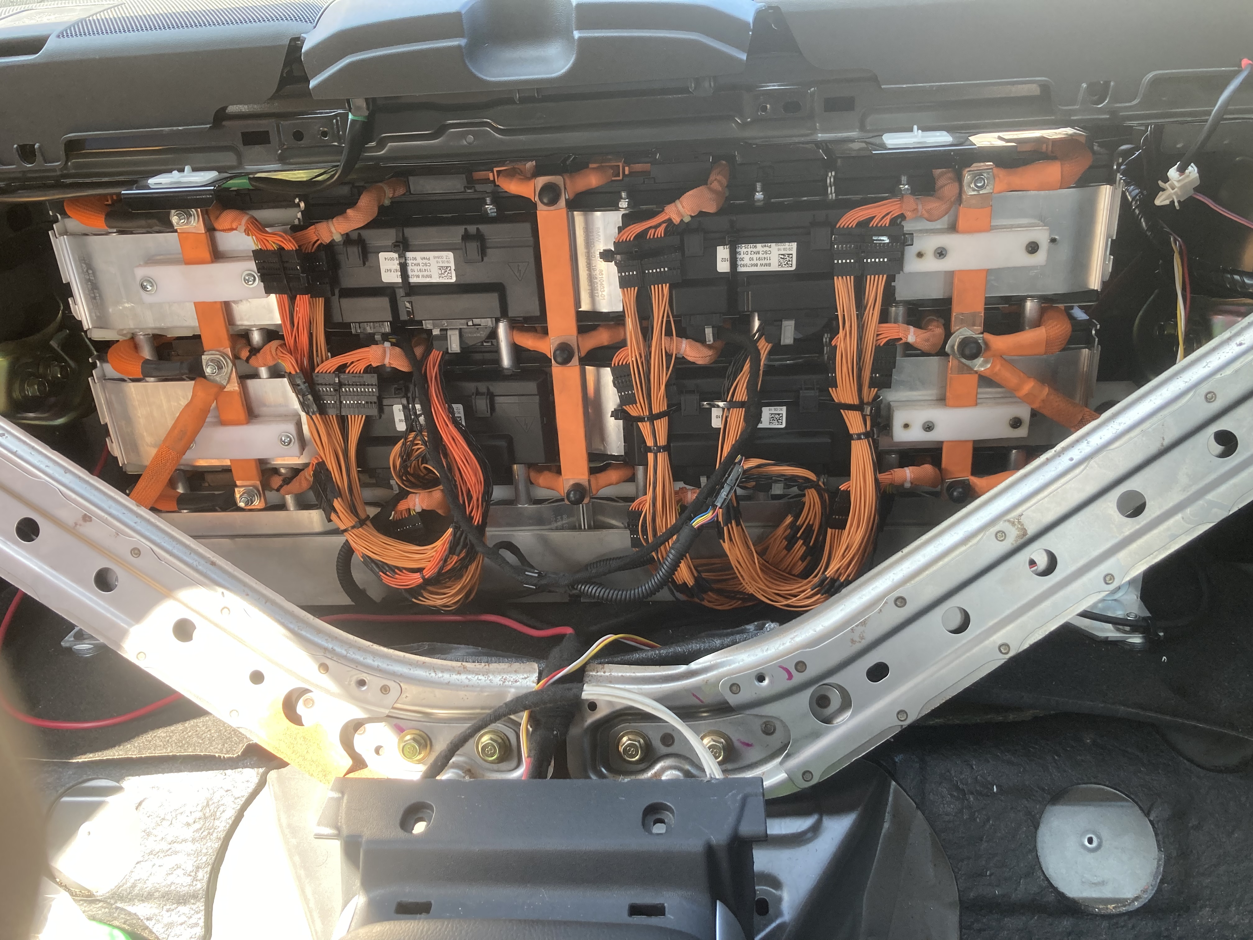

Posts: 818
Has thanked: 43 times
Been thanked: 163 times
Re: Dual BMW Hybrid packs?
Post by Ev8 »
I currently am running 18 modules 6s3p paralleled at the cell level via cell taps and module level, each parallel set of 3 modules share 1 bms, currently working on designing some simple plugin pcbs with fuseable links, but I’ve run without them for 2 years, probably time to do something about that right….
When I built this I was completely reliant on existing code, I would probably follow a different route now…
