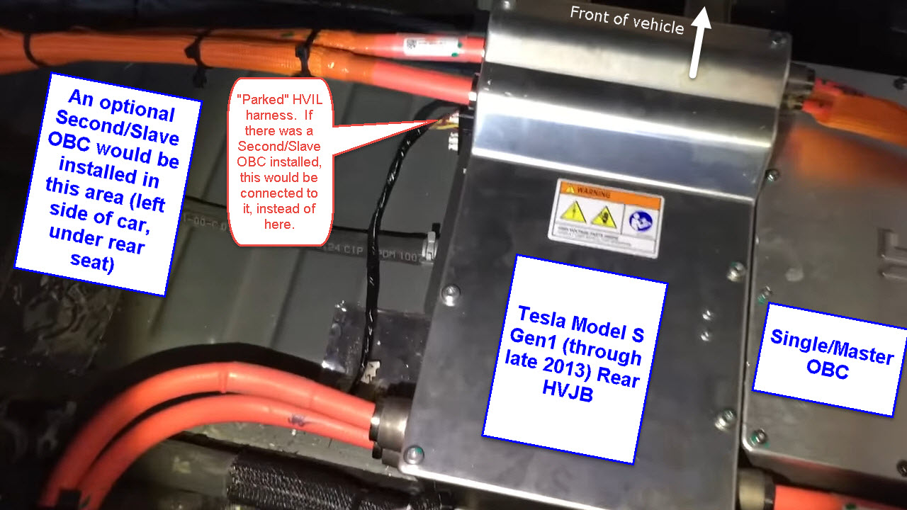

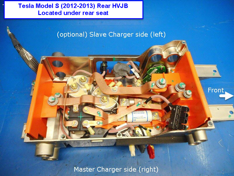

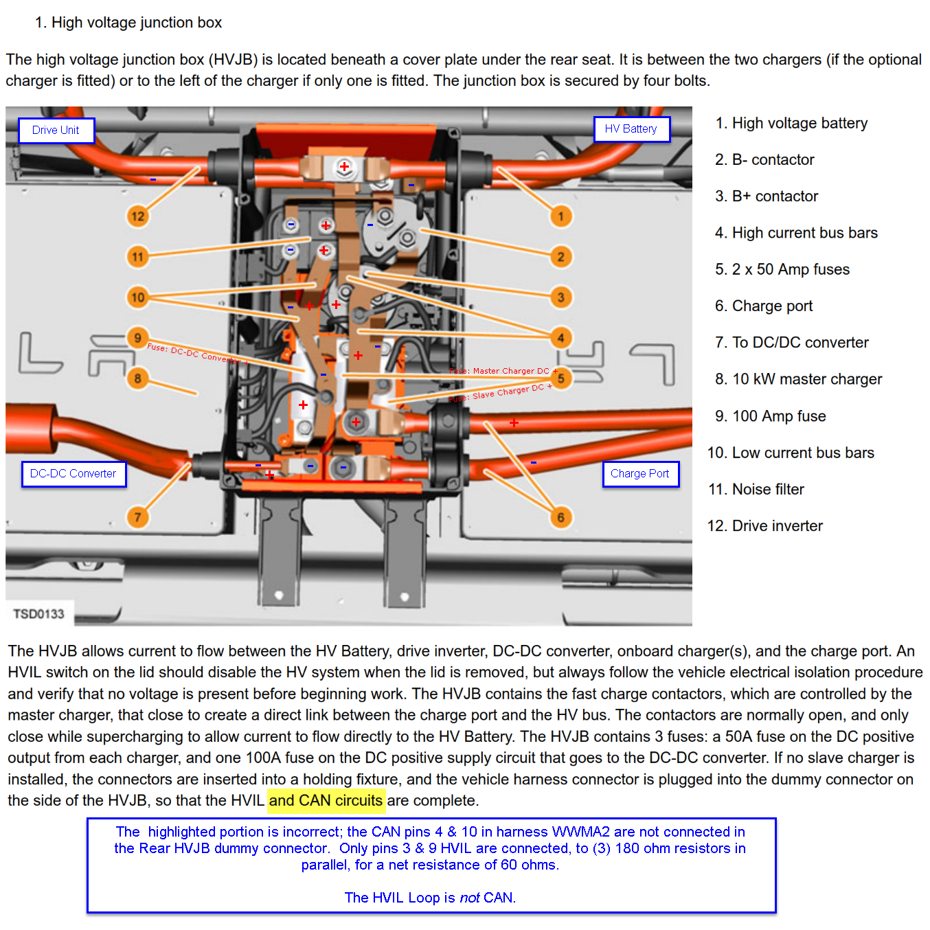

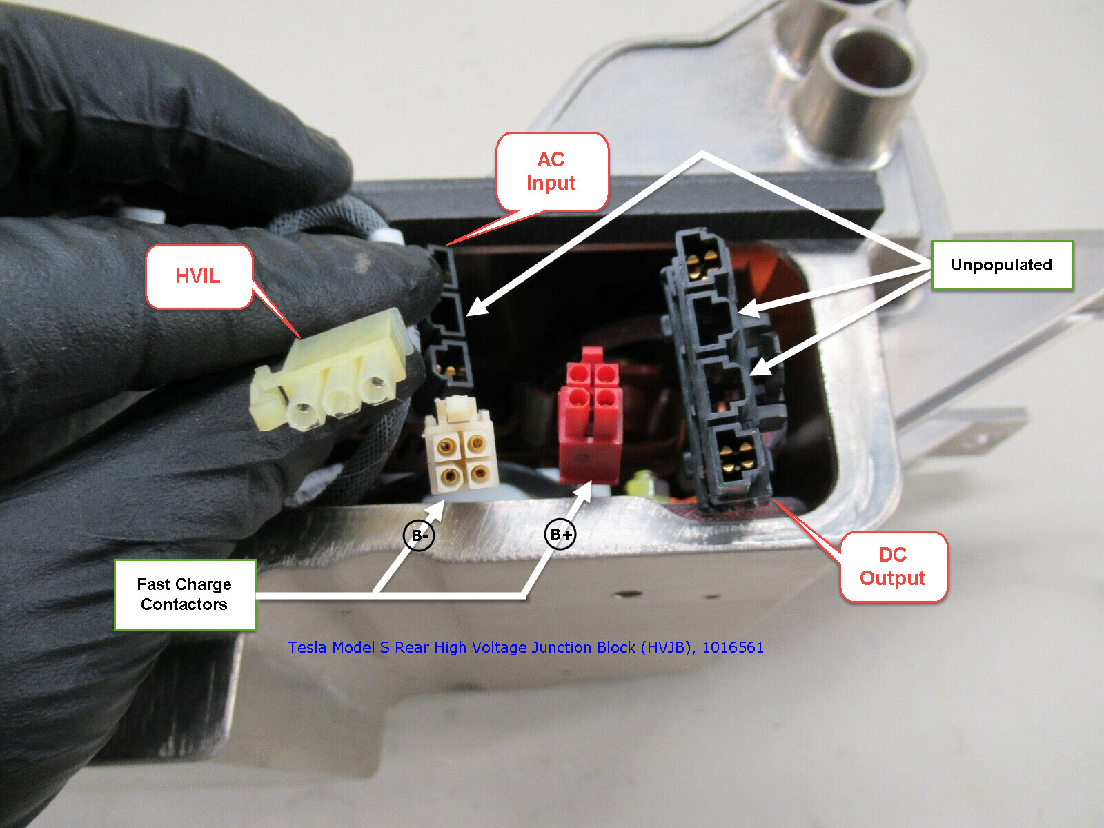

Now also a Wiki entry for Tesla Model S GEN1 Rear HVJB: https://openinverter.org/wiki/Tesla_Model_S_GEN1_Rear_HVJB
At this point, I can talk GEN1 Model S HVIL in my sleep.
- Simotronic
- Posts: 4
- Joined: Sat Jan 14, 2023 3:34 am
- Location: Illinois
Re: 1st gen Tesla S OBC charger hacking ?
That's very interesting and helpful. I too have a 2014 Toyota RAV4 EV and I also have a spare OBC, programmed for the RAV (Firmware as far as I know).
I was contemplating if adding the HVJB would be beneficial in addition to adding the Tesla Charge port so that DC fast charging could be accomplished... Of course the car would need to be fully adopted by the Tesla mothership and I suspect some software would be needed to allow the onboard charger and HVJB to properly switch the main charge port conductors.
I'm investigating the CANBus and gathering some adapters so that I can use cab-utils etc.
I was also curious about the Charge Port CANBus X044 - Which connector on the Charge port is that? One of them must be for the motorized door flap?
asavage wrote: ↑Mon Mar 27, 2023 3:53 am Now also a Tesla Model S GEN1 Rear HVJB: https://openinverter.org/wiki/Tesla_Model_S_GEN1_Rear_HVJB
Simo, if you haven't already, read this post of mine where I summarize the decision points on modding my OEM EV. The MB B250e has the same infrastructure as our RAV4s.
Currently, I'm about USD $800 into adding CCS to my GEN2 RAV4 EV (I track expense and shipments with a spreadsheet per project) . . . thinking to:
[if the AR7420-based CCS EVCC becomes more mature reasonably quickly, I may ditch the LIM and its voltage-sense board (and maybe its contactors), and the ZV, and go with that cleaner-sheet controller, but the LIM path is well-trod and repeatable.]
That, plus a bunch of HV wire, is the hardware end of things. Currently, I'm planning to tap the battery pack the same way that the CHAdeMO add-on kit does: at the front of the pack, install extension studs where the drive unit inverter cables connect to the pack. The easy-looking way to push CCS DC would be to connect to the existing OBC's output lines in the small HVJB that's bolted on the right side (left, as you look under the hood) of the OBC, but for 125A/50kw we require 2 AWG wires to the pack, minimum, and the existing wiring will not suffice, nor can where they connect to the pack be gracefully uprated for 125A. So, separate DCFC wiring and therefore its own HVJB. That HVJB would ideally be underhood or very close, but there's not a lot of room under there. The CHAdeMO got around that by fabricating a fairly elaborate support in place of the plastic "engine cover", quite a nice bit of work. I'm not above stealing a good idea, but I haven't decided on the HVJB location yet.
The CHAdeMO kit requires you put the car in "Ready" mode first, which has the HV rail hot -- the drive unit's inverter leads hot -- and then their box pushes current to the pack. I intend to try to do that a bit more elegantly -- that's the goal, anyway. But I do want to allow the Tesla bits to continue to run the BMS and AC charging show, which means I don't want to go full clean-sheet and take over control of everything, and thereby lose the Toyota integration features.
That's why I bought a spare OBC (and, later, a HVJB so I could confirm where some of the OBC's unused-in-the-RAV4 connections connected, and what they did, and it was cheap to buy and fun to trace) and just today got my second order of X042 (LV & Signals) harness parts from Mouser: I can now build the plug-in breakout harness for X042, and begin data collecting. Other people have this information already, but they're not sharing it publicly, so I'll do it the hard way. So . . . I created a Wiki article for each, and Johannes let me, even though it's unlikely that EV folk are going to repurpose these GEN1 Tesla parts, when the GEN2 & 3 are so much better.
Which leads me -- finally -- to this:
I really think that making or buying a different box would be better than trying to rework this one. There's a lot going on in that space, Tesla did a masterful packaging job, but it doesn't adapt well. Maybe repurpose a GEN2 Front HVJB . . . I'll probably just roll my own.
I'm not interested in trying to make a Tesla charge port work. Supercharger stations are going public for all in the US (CCS adapters are built-in to the VC SCs) so I'm going CCS. The nozzle locking will work with the BMW i3 LIM and BMW charge port (or other CCS1 charge ports) and that's enough for me.

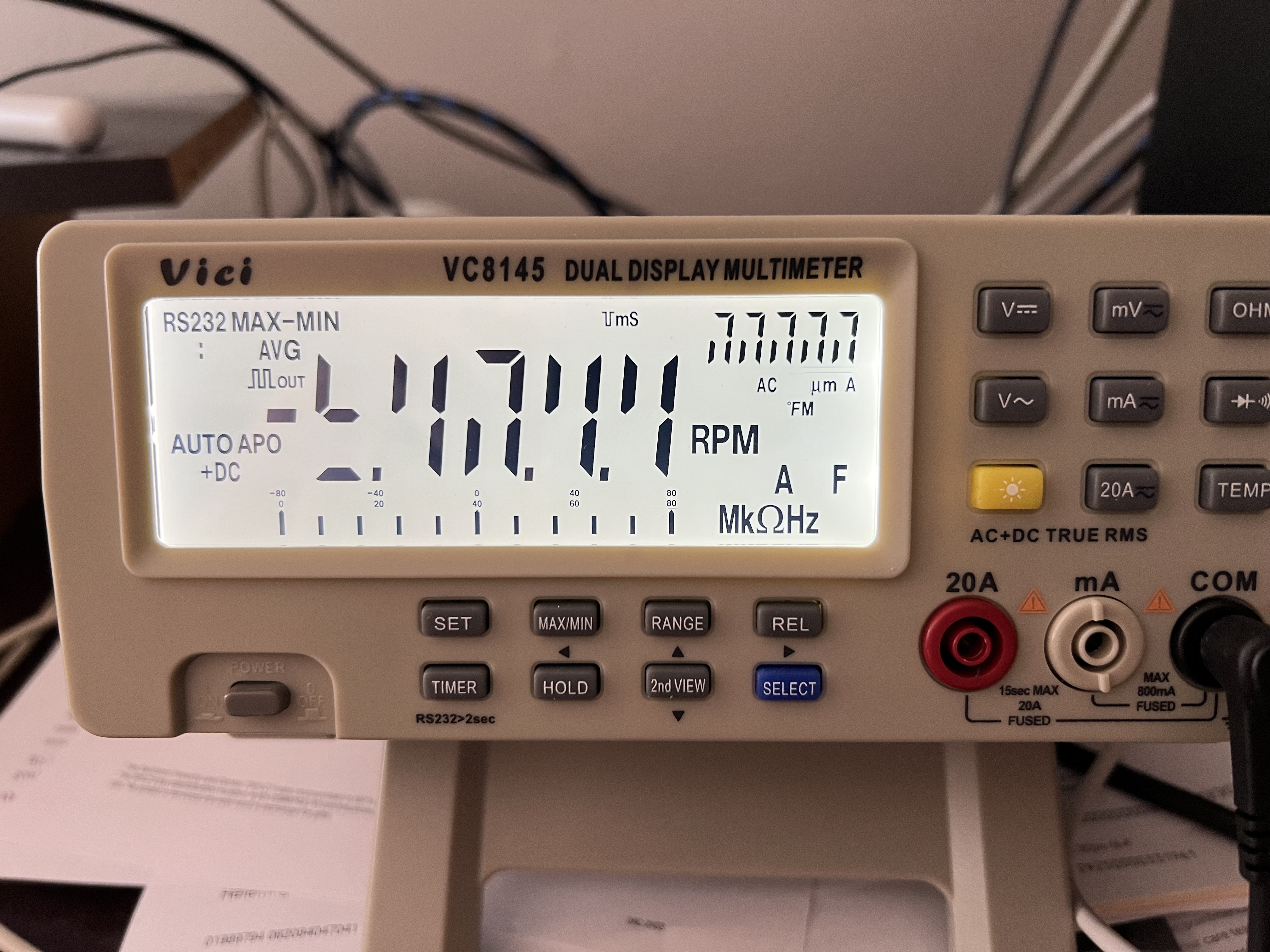

Sidebar: I've got a completely separate project on which I need to do week-long monitoring of DC low current using a clamp transducer -- datalogging. The Good Stuff is like Fluke 289, but we're talking well above USD$500, it'll only do ~900 events in memory, and requires another $200 for an IR<->USB cable and software to do data transfer and/or continuous logging to a PC using their software. Oh, and the clamp transducer. Ridiculous money for a one-time datalogging project.
I figured to cheap-out and tackle it piecemeal. I bought a VC8145 for $200 after tax, via Amazon. It's a cheap bench DMM but also 4.5 digits, 82000 count, and the supposed ability to datalog to a PC via an RS-232 interface.
Picked up a cheap low-current DC ma to mv transducer, too.
The VC8145 has been around for years and is a known animal. I thought I knew what I was buying. It showed up on my doorstep today, and within four hours, I packed it up and am mailing it back.
1) The RS-232 interface is opto-isolated (good!) which means it requires power from the RS-232 host (um . . . ) but most "serial hosts" these days are USB<->RS-232 dongles, and most of them also can't provide enough power to fire up the VC8145's client interface circuit. I tried three dongles I have around, ONE of them supplied enough current.
2) It has no internal storage, so all logging has to happen on the PC. OK, I knew that. But! you're supposed to use the included software, which is supplied on a mini-CD (remember those?) and which also is Rev. 1 and won't run on anything newer than WinXP. Ahhhh . . . OK . . . I have a WinXP VM handy, so I install the software . . . and . . . the display slowly, over the space of a minute, starts twitching, with various segments turning off & on, eventually culminating in the unit locking up.
3) The WinXP software limitation is also well-known, so I tried two other apps that do work with the VC8145 (I liked "Test Controller", it works with a LOT of different multimeters), and . . . same.
So, I packed it back up in its cute box, printed off the Amazon return QR code, and I'll drop it at the local UPS Store tomorrow.
That was pretty much all day.
Then, I spent a couple hours looking for an alternative . . . and I'm right back to buying a Fluke 289 (or 287, 189, 187, or 87 IV), all of which can stream data to a PC . . . using a $80 IR<->USB cable and the aforementioned "Test Controller" software, bypassing the expensive FlukeView Forms version.
I think I found a local used one, two actually: one for $325 that looks pretty well used, and another that appears new for $400. Plus the IR cable. Ugh.
Still hoping that cheap Chinese low current transducer works . . . when it shows up next week.

The Tesla Model S GEN1 Rear HVJB is just too big. IMO. Yeah, I can cut off the mounting ears but it still is way too large for two contactors, two fuses, the IVT-S shunt and the voltage sense board. Its biggest issue (pun intended) is that it's not rectangular in height, which is a problem if you're trying to fit it under the hood in addition to what's already there.I was contemplating if adding the HVJB would be beneficial in addition to adding the Tesla Charge port . . .

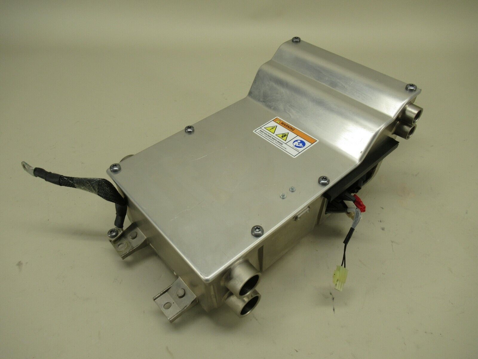

Hi guys, is there a way to run a Tesla OBC gen 1 in an ev conversion?
- asavage
- Posts: 342
- Has thanked: 297 times
- Been thanked: 107 times
Unlike the Tesla OBC GEN2, there's no replacement control PCB for the GEN1. You'd be facing a steep uphill battle, and the path/recipe to use a GEN2 OBC is well-trod.

The HVIL lines can be ignored; the OBC's HVIL circuit resistance is monitored by the Tesla BMS -- to verify that the covers are in place, for example -- but isn't used in the OBC itself.
As for the CAN . . . that's the largely undocumented part -- for now. Put another way, people know the CAN message IDs and some of the data payloads, but they're not sharing, so much is not public at this point.
The few of use who are locked into using the GEN1 OBC -- Toyota RAV4 EV, MB B250e -- have need of that info, but nobody else is really interested anymore, since from-scratch conversions can use the less-trouble-prone and better supported GEN2 OBC instead.
