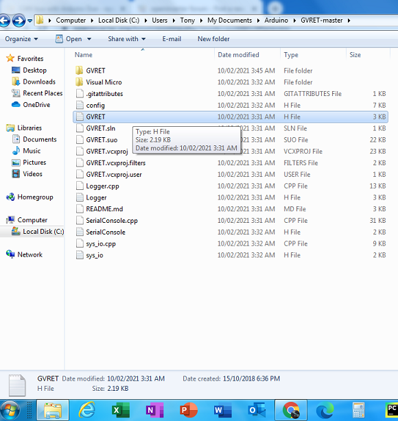

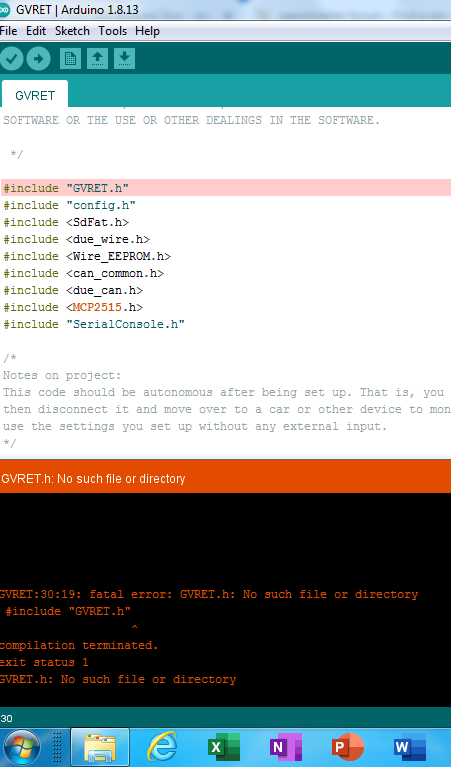

Hi everyone,
I'm about to start my hand at hacking the CanBus,
I'm following Damien's instruction from the Wiki. https://openinverter.org/wiki/CAN_bus_w ... all_GV-RET
Have all the libraries installed,
The last step is download GRVET and compile and upload to the DUE.
But I get grvet.h missing error, but I have that file installed. (came with the gvret download)
I've been at this for the last 8 hours trying to figure it out but just can't.
Any help would be greatly appreciated.

You need to remove all 'Master' from folder names. Also you might need to shift folders around or merge them. That is usual when folders arent't named correctly or in wrong places so arduino cannot find the files.

In fact in your screenshot I can see you have '_master' extension on your GVRET folder name. Collin explicitly states this in his instructions to remove any "_master".

From the wiki page you linked to: "Rename the file to remove "-master" or any other postfixes. This is important!"

Funny thing is that I'm almost positive that I did rename the file after i download it, in the download folder. but after extracting it the Libraries the master part of of the name came back.
OK I'll keep at it. Thanks.

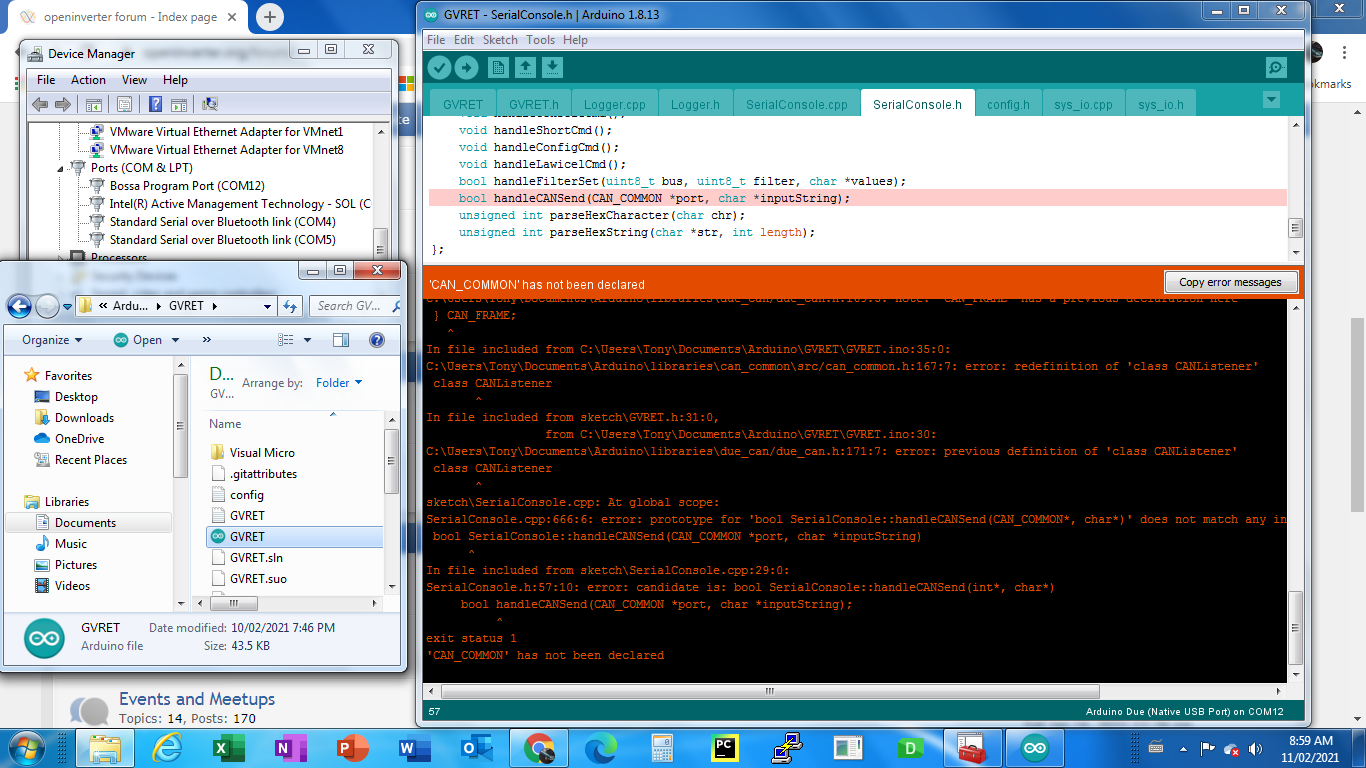

OK. new issue.
I started with a clean install of Arduino IDE
Installed all Libraries, (as per Wiki instruction)
renamed Zip files,
renamed extracted files, (-master reappeared after extracted)
All is good until the last step, uploading GRVET file.
Something about "Can-Common" has not been declared,
Picture below is a screen shot.
Can anyone give me a idea what I'm doing wrong?
thanks.

Why not just use the gvret updater? no compilation required.

Anyway, it's much better if you can build from source because then it's possible to understand how it works
Clean build should work. I'm keen to understand why it's not working for you so I can get the Wiki instructions right.
What files have you got in libraries/can_common ?

PS: if you send me the Arduino build output in a message, I can take a look. It's hard to decipher from a screenshot...
