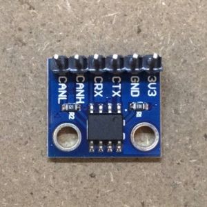

This SN65HVD230 transceiver did not work
Initially, I tried tiny ones that look like this. They were all faulty.

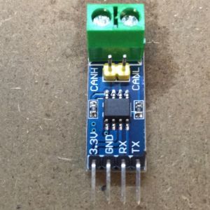

This SN65HVD230 transceiver worked
I tried some bigger ones with screw terminals. These all worked perfectly.

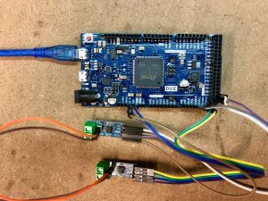

Connect your transceivers to the Due board
The CAN0 interface is on the pins marked CANRX and CANTX
The CAN1 interface is on the pins marked DAC0 (RX) and 53 (TX)
Due CAN loopback test
Connect the CAN bus on the two transceivers together (CANL to CANL, CANH to CANH)

Connect your computer to the the "native" USB port on the Arduino Due board with a USB cable and make sure Tools -> Board: "Arduino Due (Native USB port)" is selected.
File -> Examples -> due_can -> CAN_ExtendedPingPong
Sketch -> Upload
Tools -> Serial Monitor
If your CAN transceivers are working properly, you should be rewarded with incrementing numbers in the serial monitor window.
