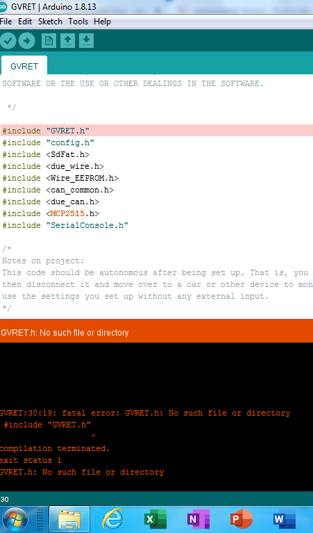

Hi everyone,
I'm about to start my hand at hacking the CanBus,
I'm following Damien's instruction from the Wiki. https://openinverter.org/wiki/CAN_bus_w ... all_GV-RET
Have all the libraries installed,
The last step is download GRVET and compile and upload to the DUE.
But I get grvet.h missing error, but I have that file installed. (came with the gvret download)
I've been at this for the last 8 hours trying to figure it out but just can't.
Any help would be greatly appreciated.

You need to remove all 'Master' from folder names. Also you might need to shift folders around or merge them. That is usual when folders arent't named correctly or in wrong places so arduino cannot find the files.

TonyV wrote: Wed Feb 10, 2021 9:06 am I've been at this for the last 8 hours trying to figure it out but just can't.
In fact in your screenshot I can see you have '_master' extension on your GVRET folder name. Collin explicitly states this in his instructions to remove any "_master".

From the wiki page you linked to: "Rename the file to remove "-master" or any other postfixes. This is important!"

Funny thing is that I'm almost positive that I did rename the file after i download it, in the download folder. but after extracting it the Libraries the master part of of the name came back.
OK I'll keep at it. Thanks.
