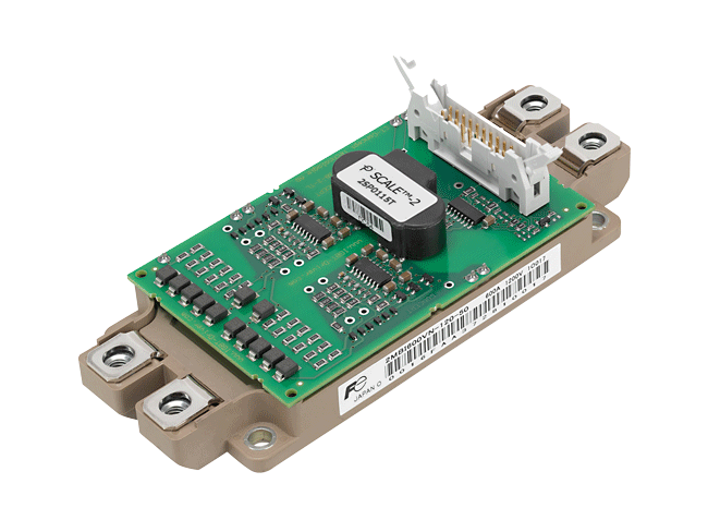

GrapeNuts
Posts: 31
Joined: Sat Jan 05, 2019 2:27 am
Re: Erratic Speed Measurements
Post by GrapeNuts »

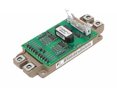

I'm using the gate drivers provided with the kit.
Here is a plot with il1rms. (The il1rms value is hard to read, it is 1A.) This plot captures 3 faults. The inverter seemed to recover from the first fault but shortly after it fails twice more. There is a bus voltage drop at each fault and what looks like a momentary increase in current at index 1775.
The voltage drops are curious, perhaps an IGBT fault? The IGBT module is used industrial surplus from ebay. There is no guarantee it is working properly.
To check the PWM from the gate driver circuit I'll need to do some disassembly. I'll work on that now.

Ok, I think I found the problem. My second phase top output signal is different from the others with high voltage. The signals all look the same when I have 0v or low voltage on the DC bus, but when I have high voltage on the DC bus I see this only on one signal.
Is this a damaged IGBT?
Been thanked: 1913 times
oh thats messy, I think you found the culprit. Now you can swap the gate driver to see if the error comes from the driver or the IGBT.

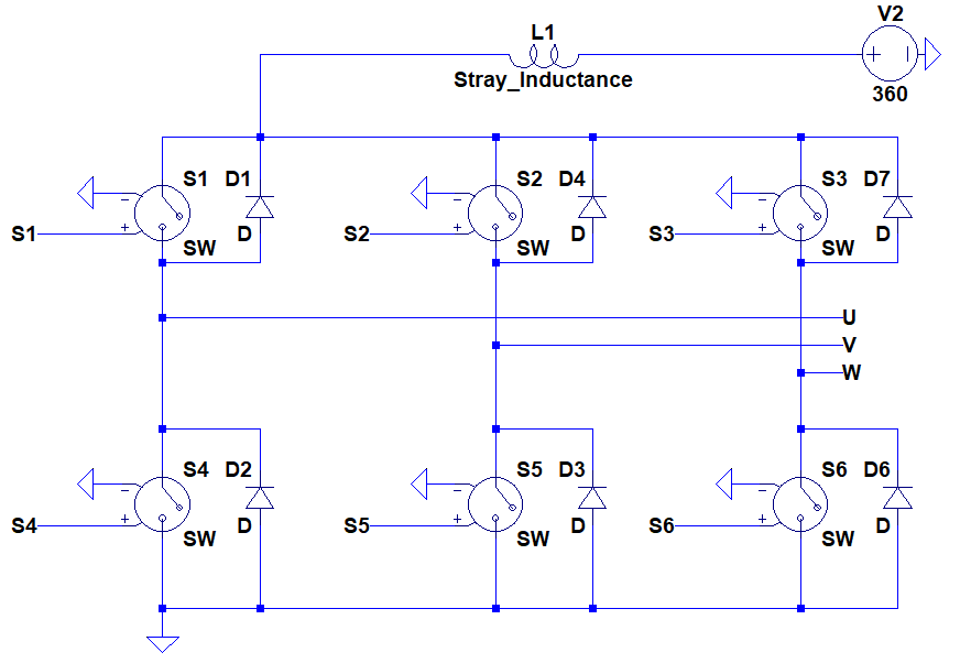

Unfortunately I've had quite a bit of bad luck the last few days. When I took the measurement from my previous post I wasn't expecting that level of voltage on the driver outputs. I was using a 1x probe which fried my oscilloscope.
I borrowed a scope and I decided to troubleshoot with a lower DC bus voltage (170v) to prevent damage to my borrowed scope. I thought this would be safe because my borrowed scope has a 10x probe rated for 300v. I began troubleshooting and I swapped the output between 2 of the driver circuits. The fault was still present so I started measuring the output signals again. Unfortunately before I could figure out if the fault was with the driver circuit or IGBT I had a new event occur which I had not seen before.
When I started the inverter I had a large voltage spike on the DC bus. Fortunately my borrowed scope was not attached to the faulty circuit so it survived this event, but my voltage source did not. My isolation transformer when up in smoke. I guess some of the voltage also made its way back into the mains because my Kurieg is also not working this morning :(
What could have caused this voltage increase? The DC bus voltage doubled. I've not see this before. At this point I need to order a bunch of new equipment to continue troubleshooting. Fortunately it seems the inverter has survived all these events.
