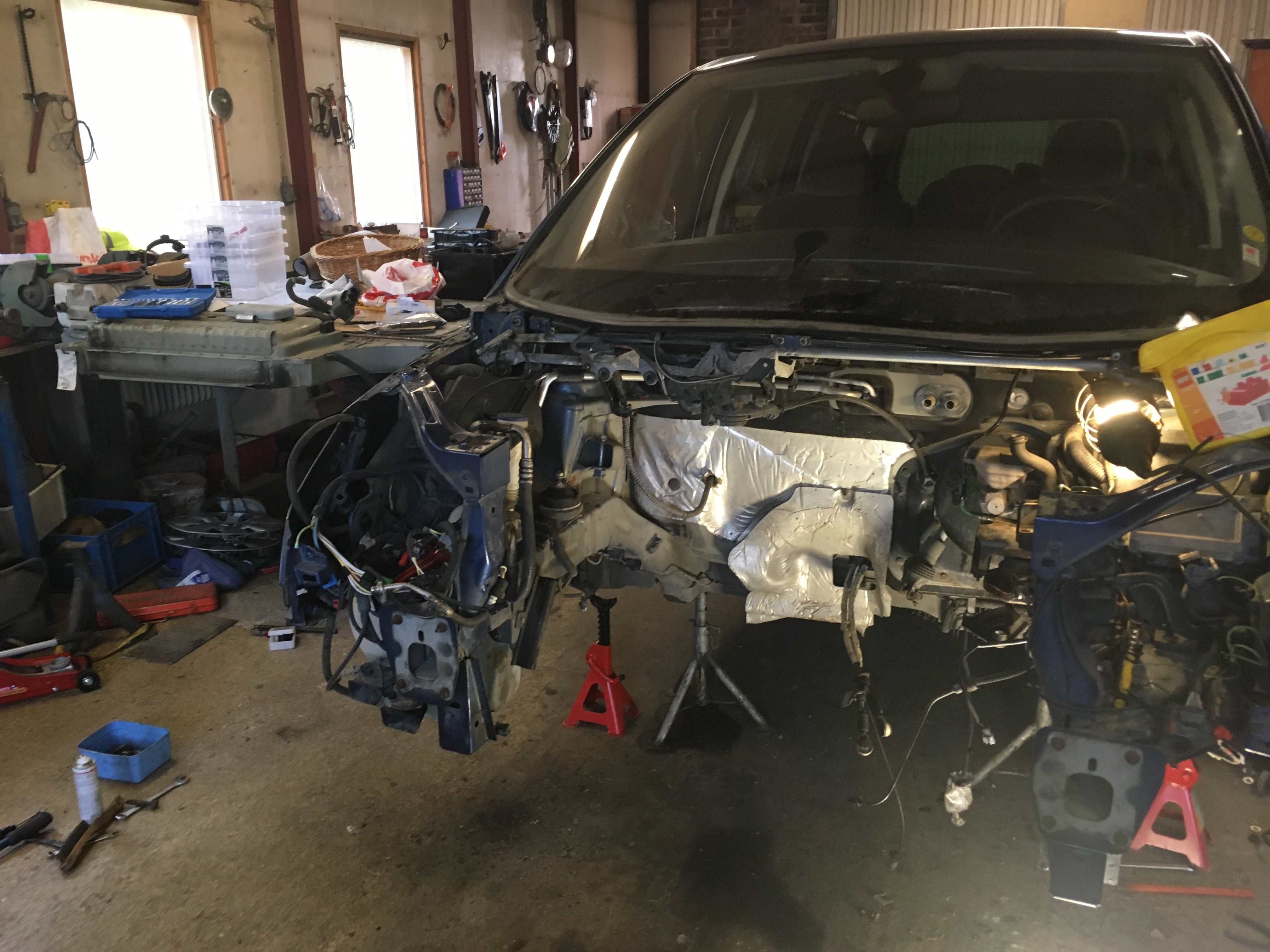

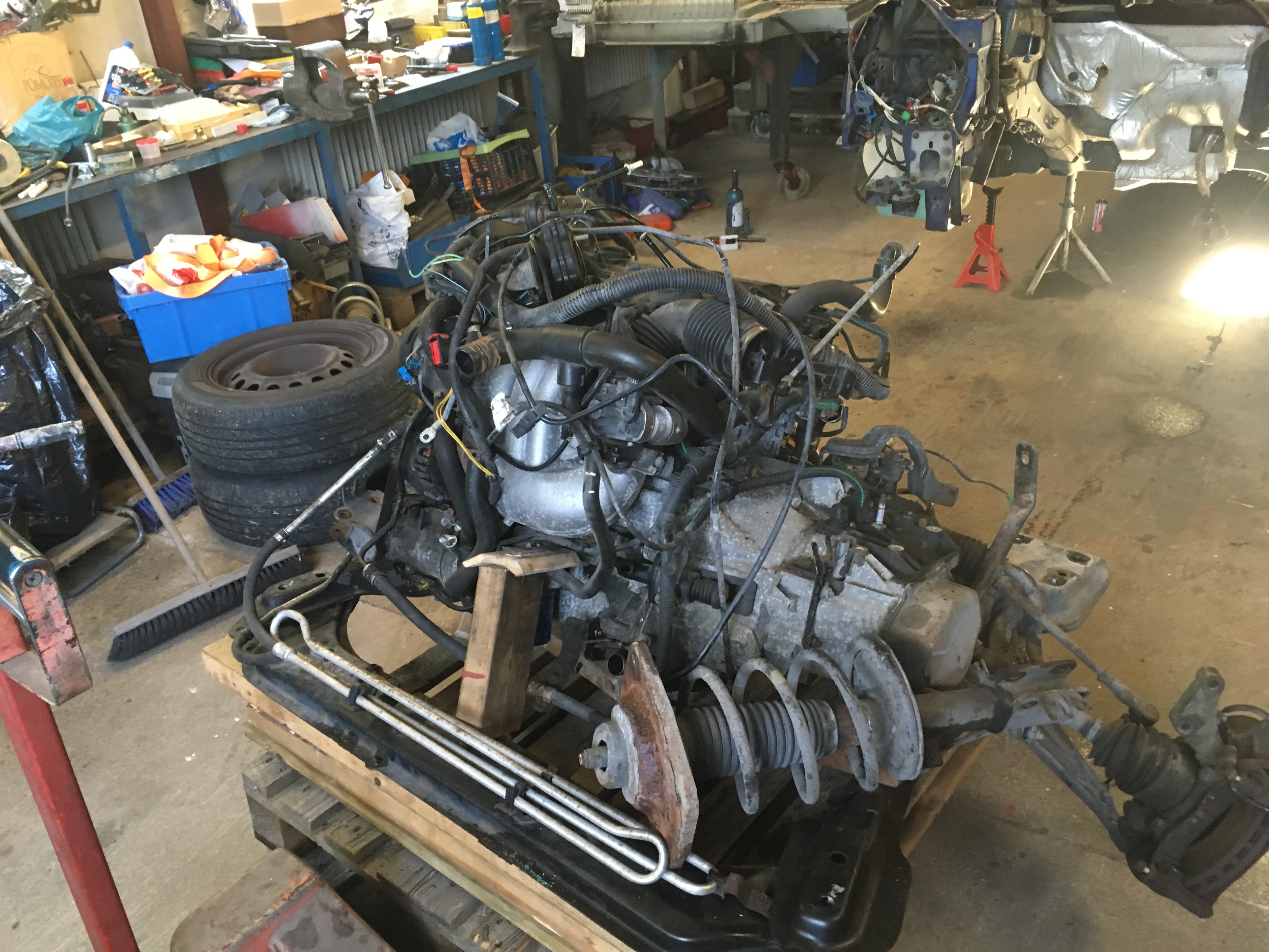

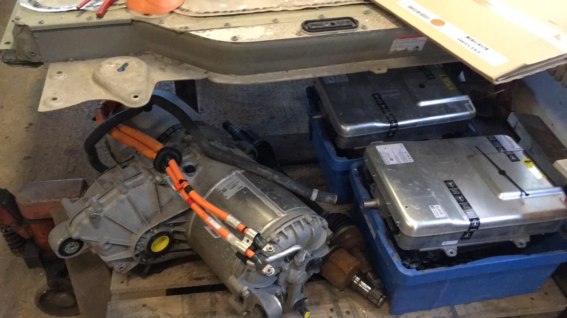

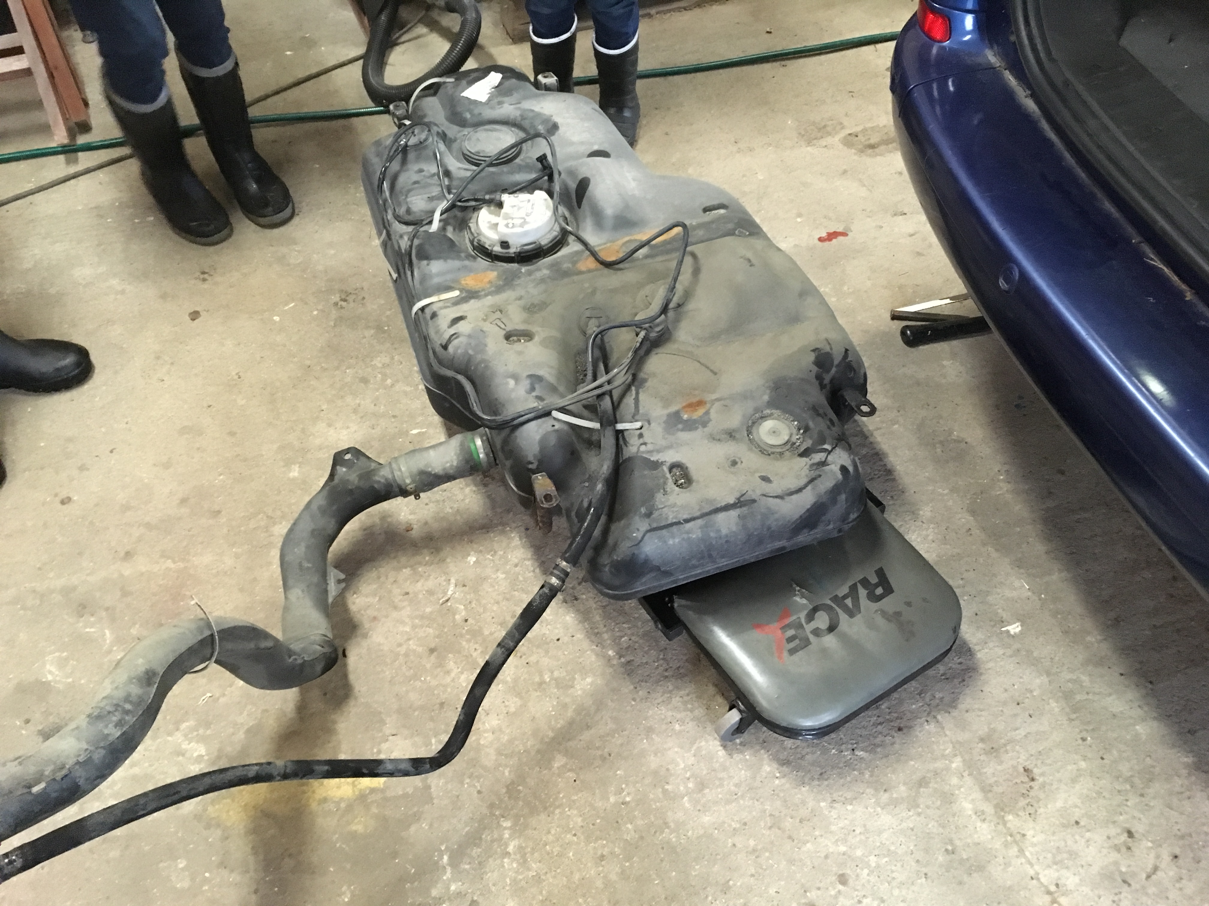

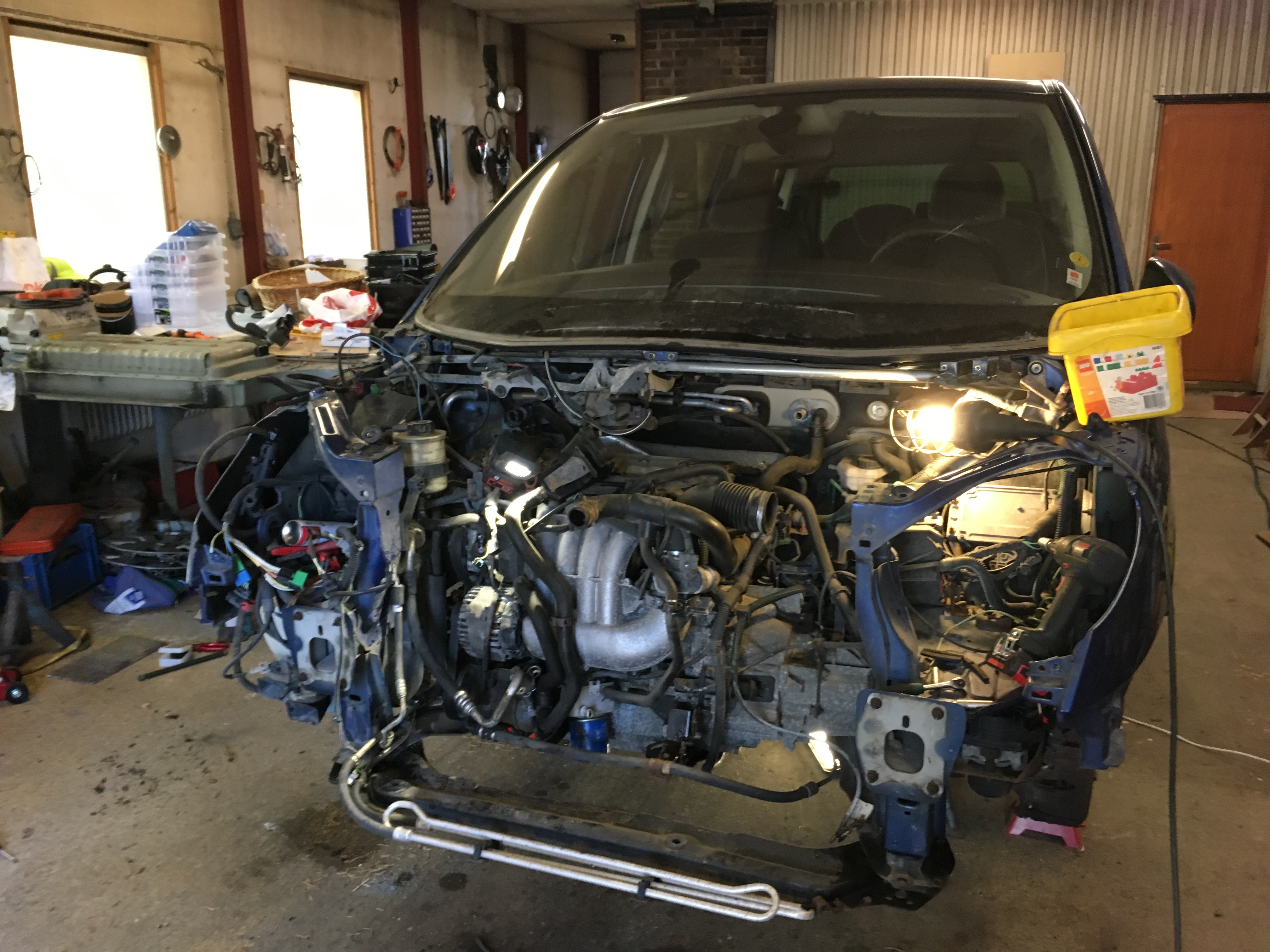

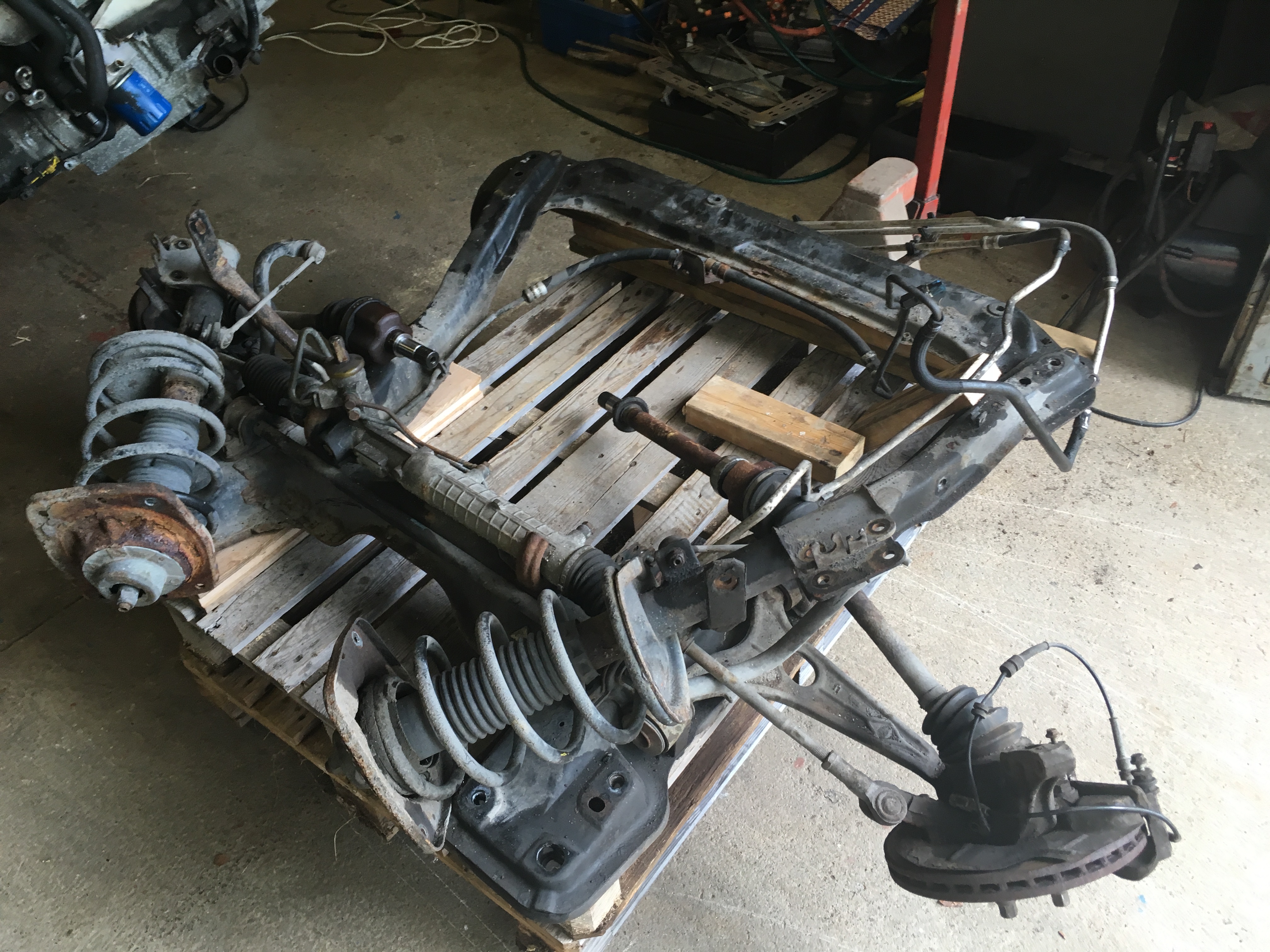

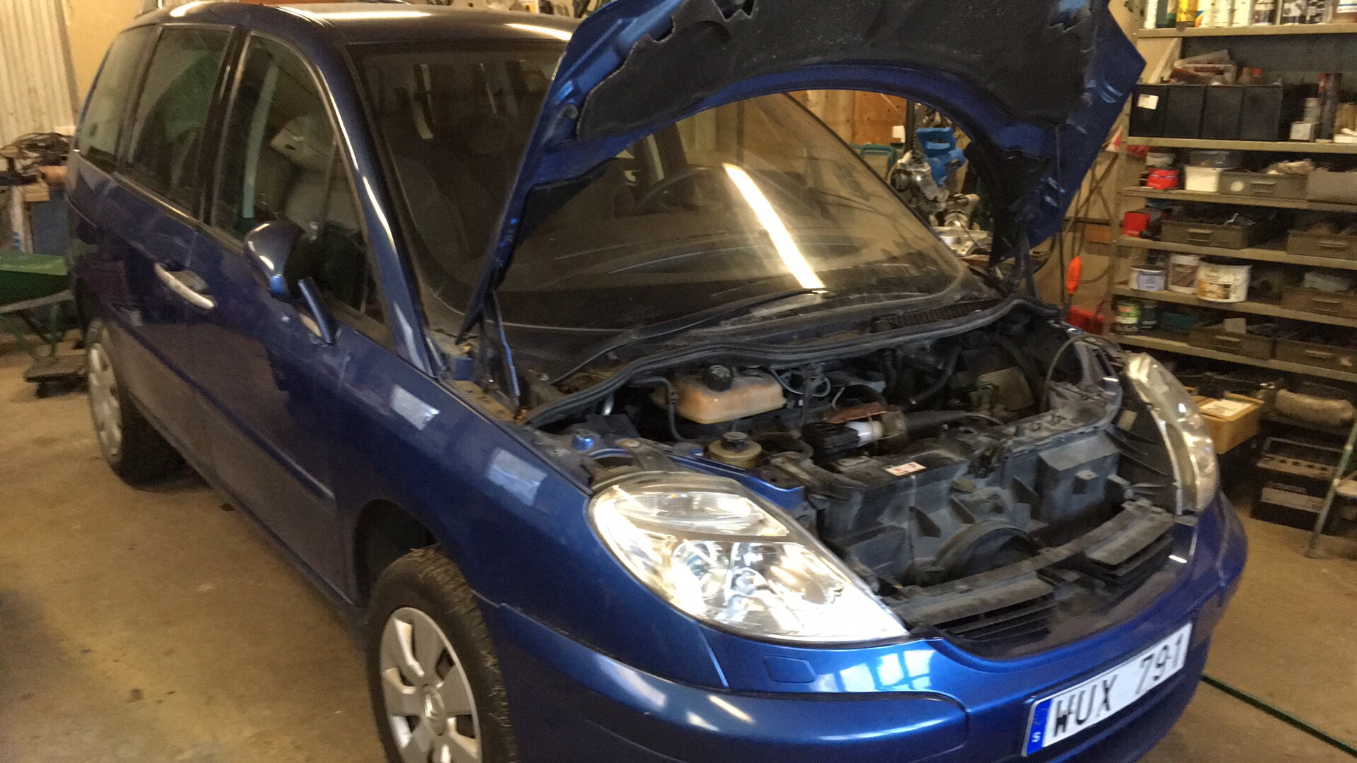

Re: Citroen C8 with Tesla stuff
Hi Again !

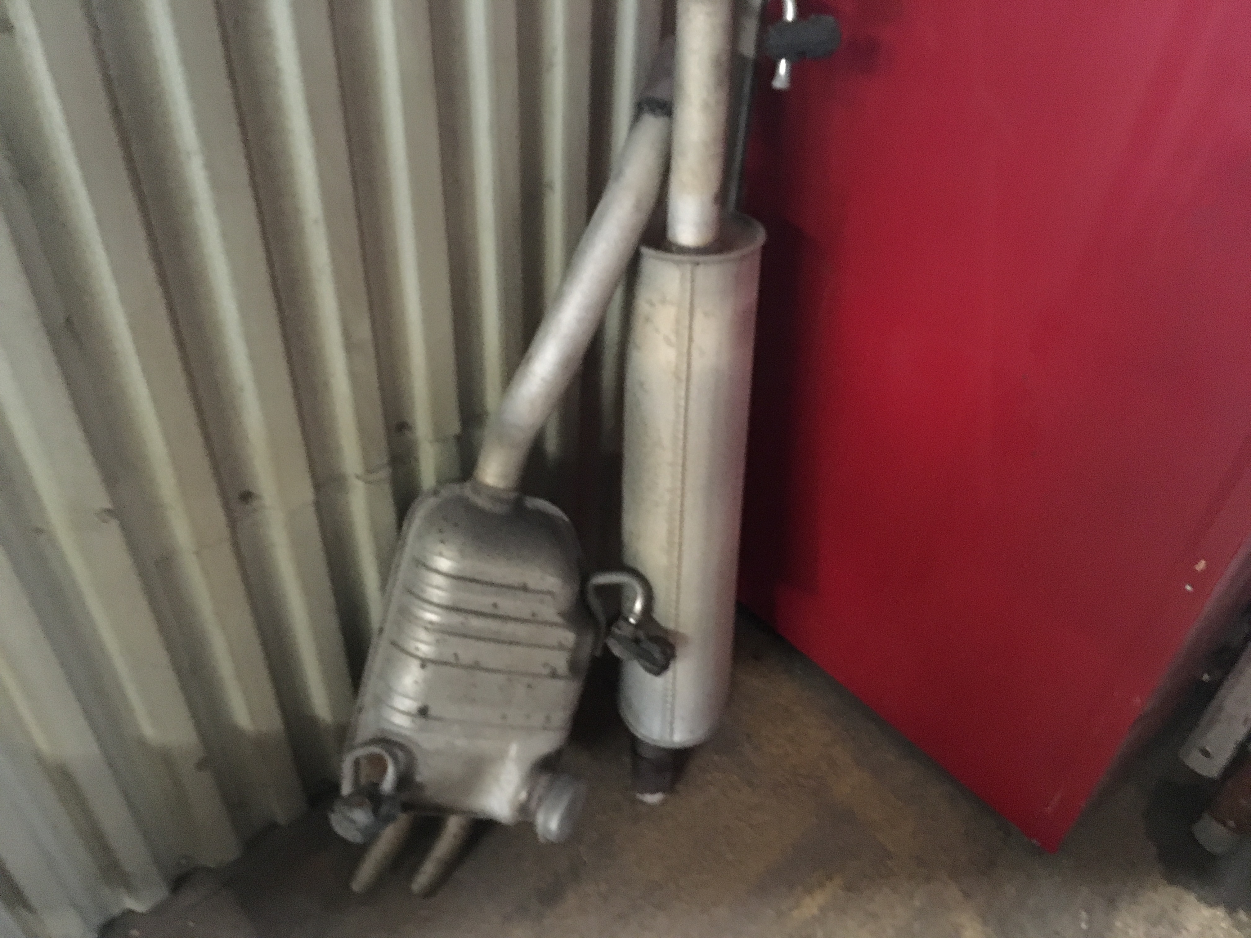

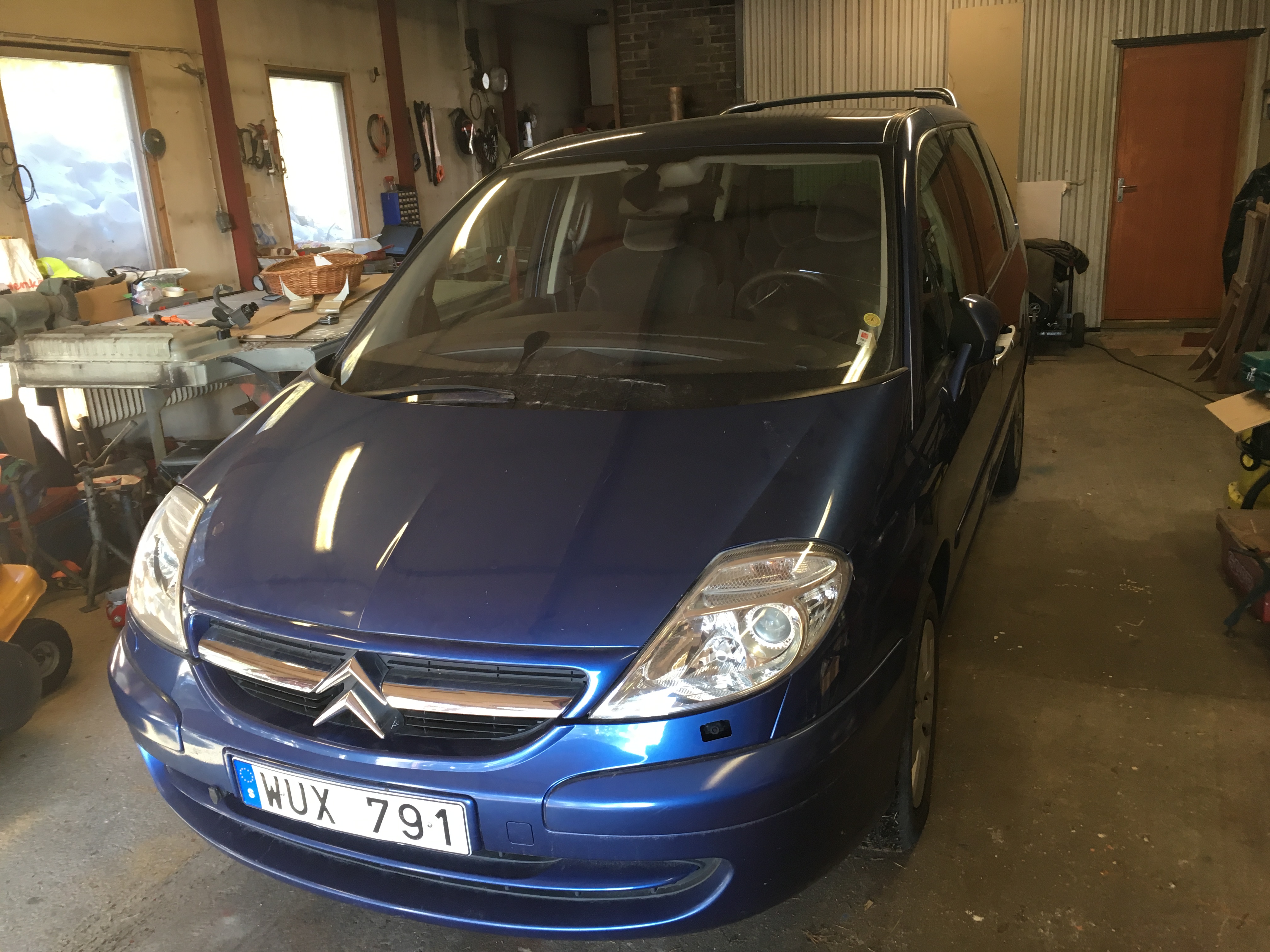

Here comes some photos.
The patient.
Parts Removed
Parts to put in it
Start to remove ICE ICE out More will come !!!!
The patient.
Parts Removed
Parts to put in it

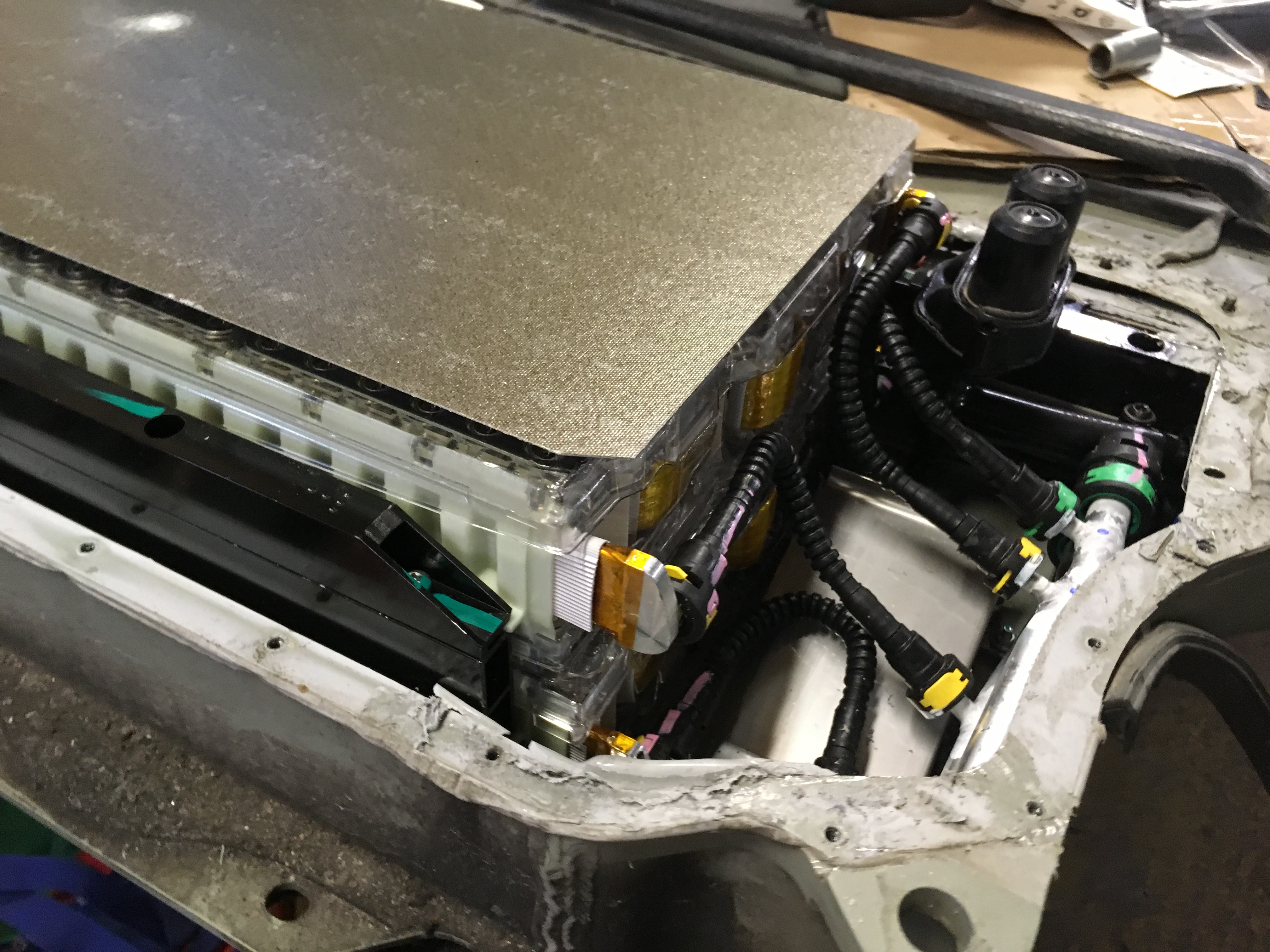

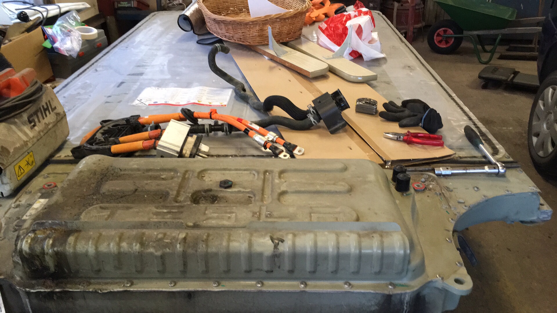

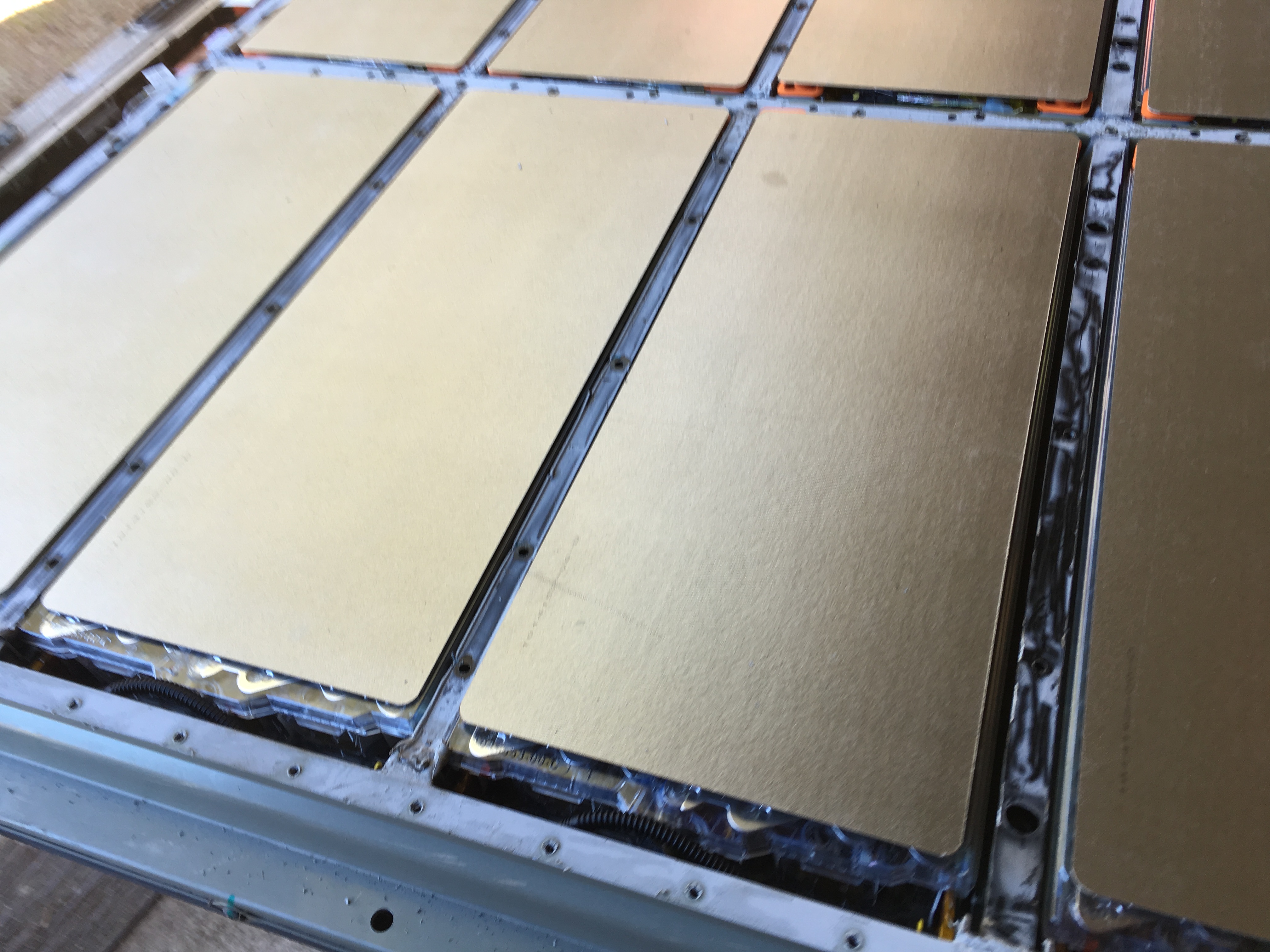

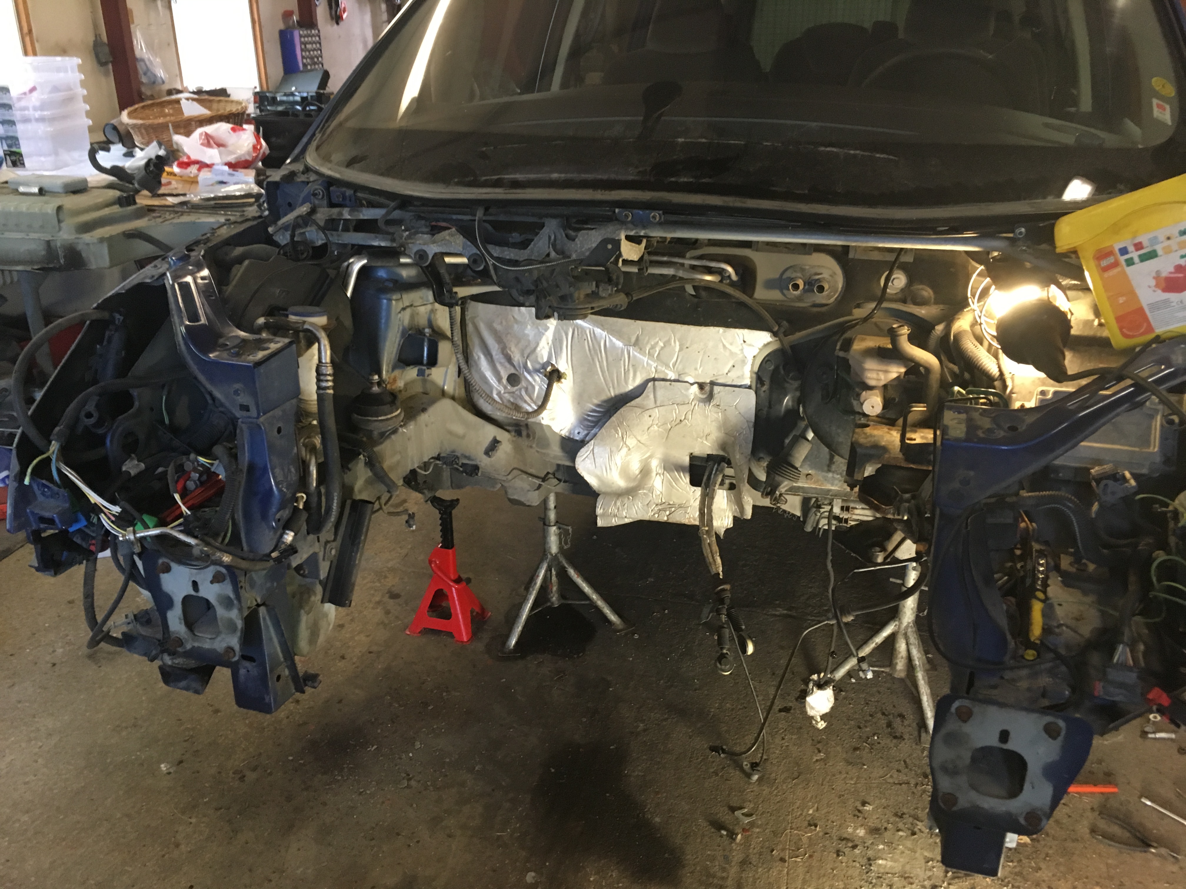

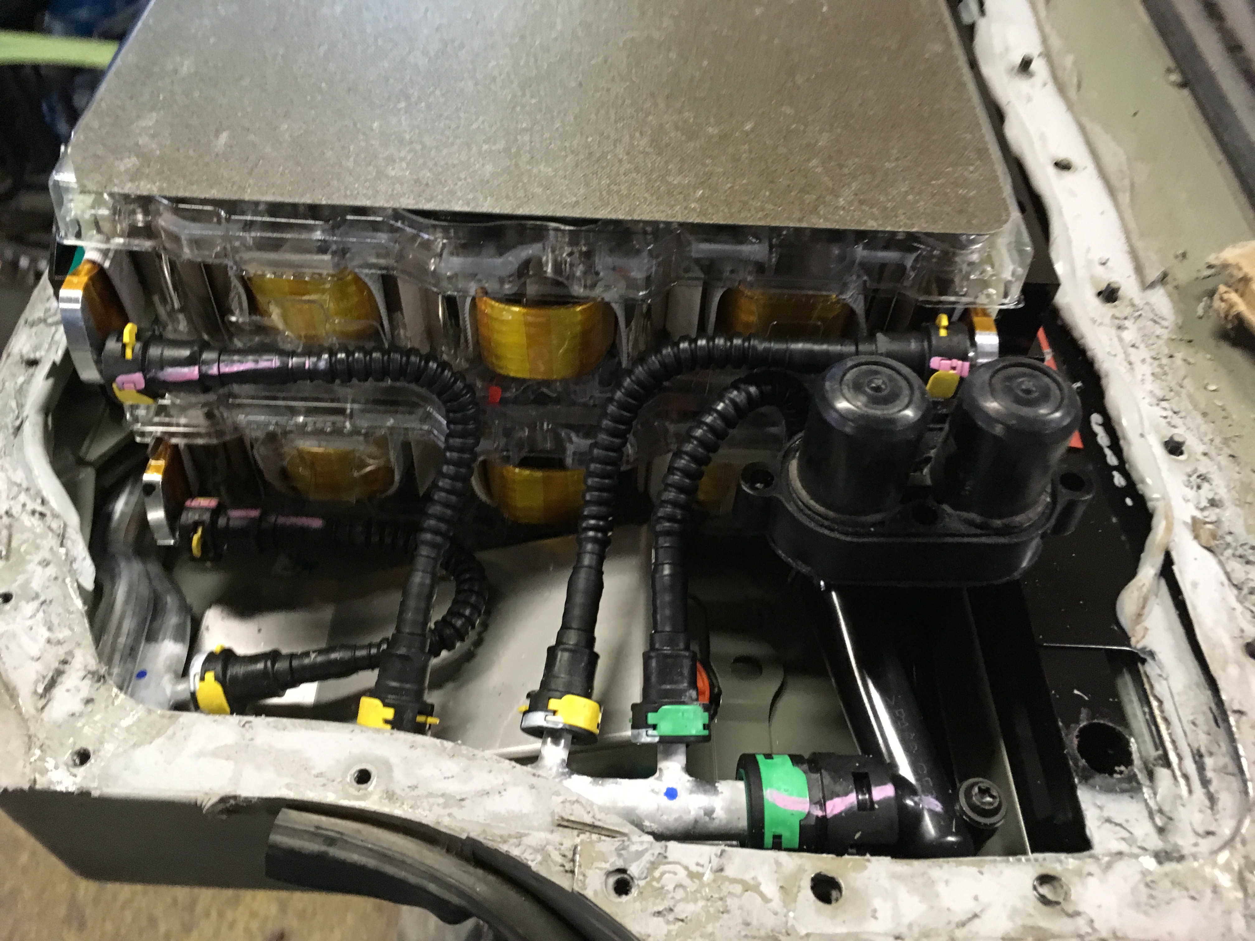

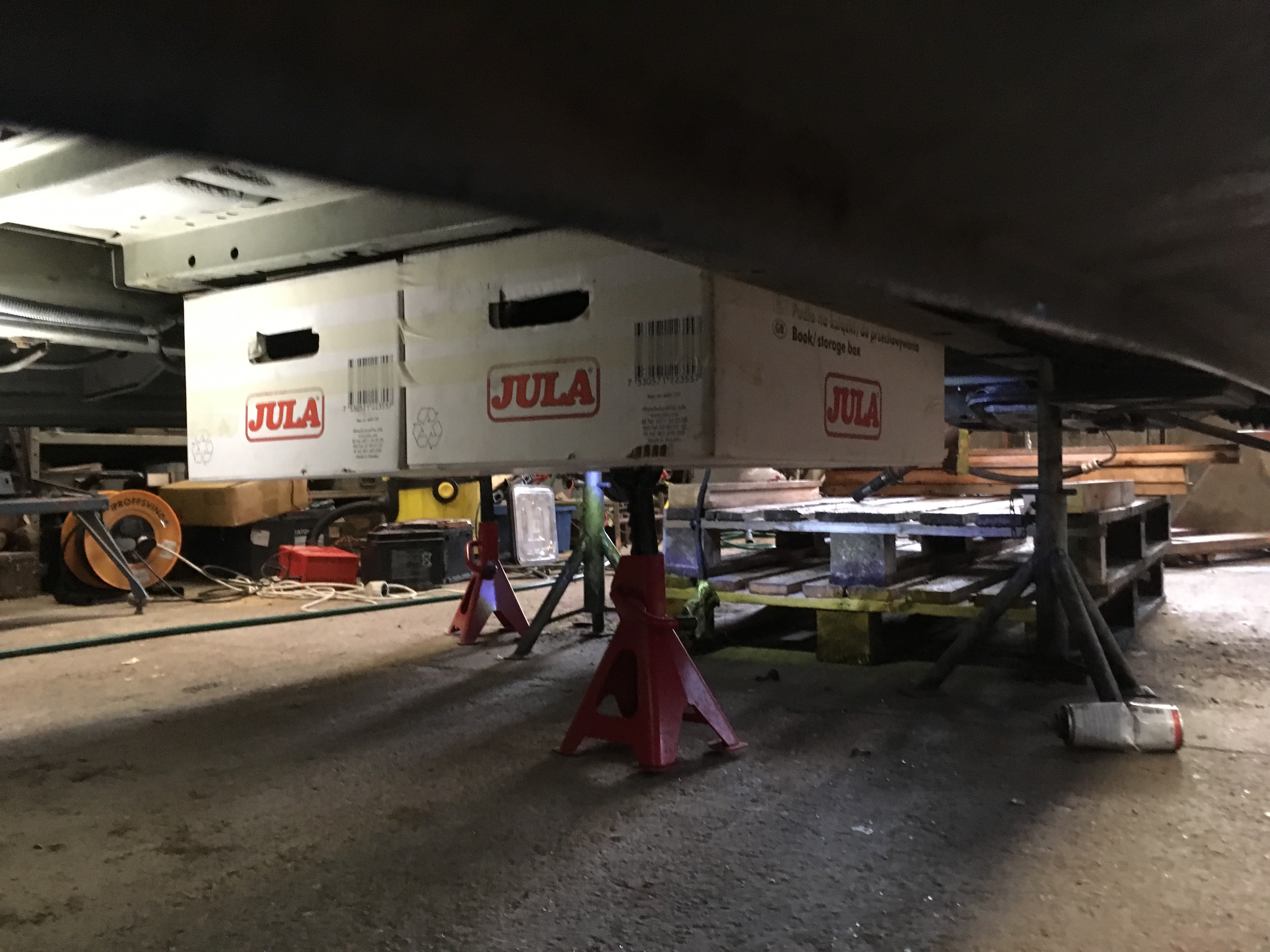

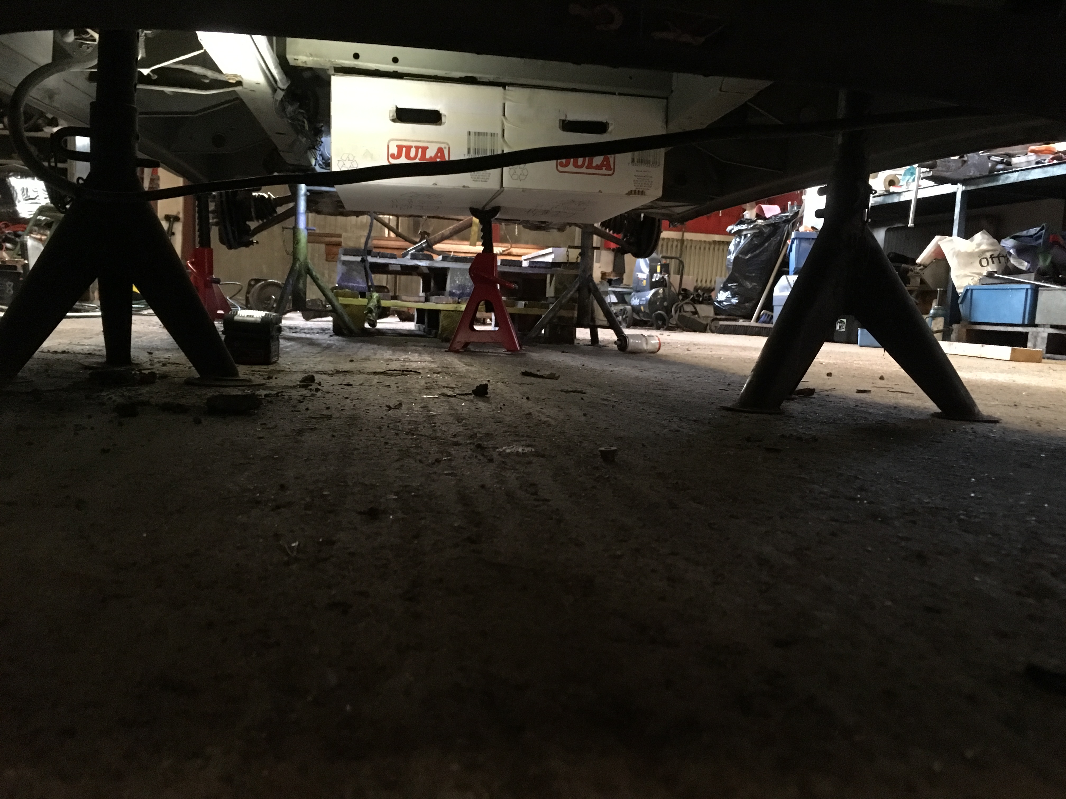

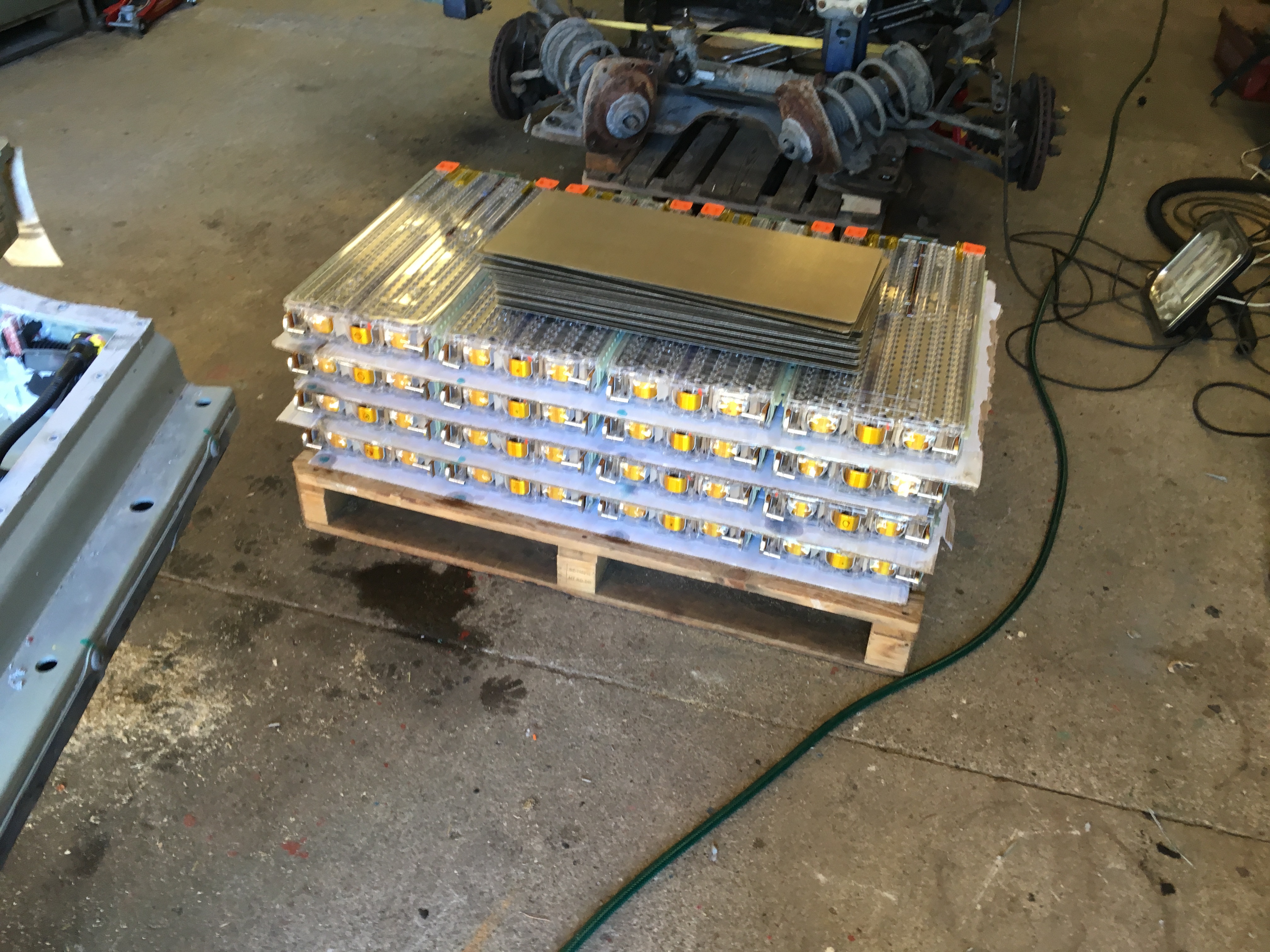

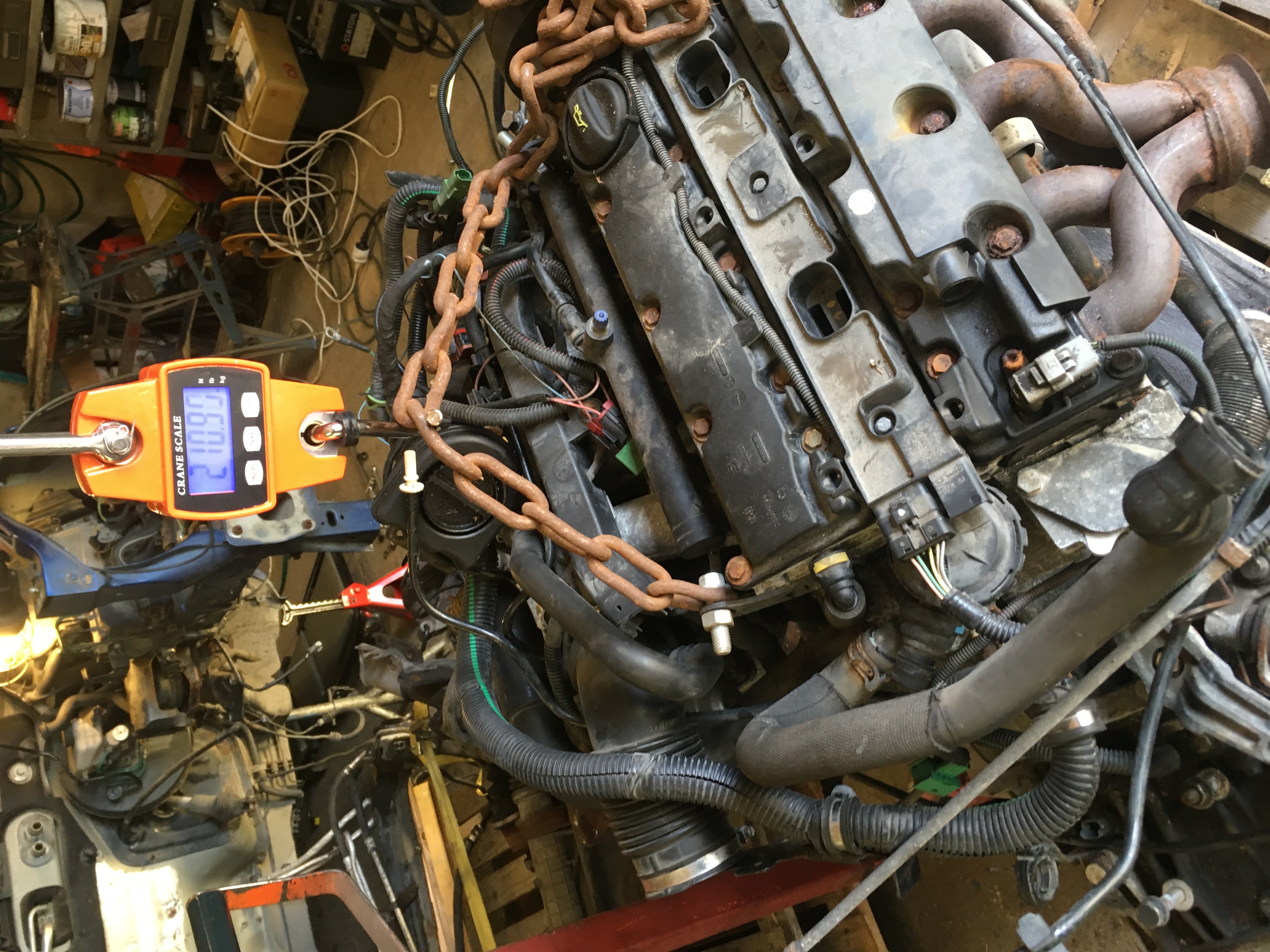

Here comes some more photos from my build.
Motor cradle
Getting to know the weight of the ICE. Thanks for the suggestion on scale Damien.
Unpacking the Battery
All modules out
Mocking up for the battery box.
The empty space where all the stuff should go.
Regards
/Per
Motor cradle
All modules out
Regards
/Per
