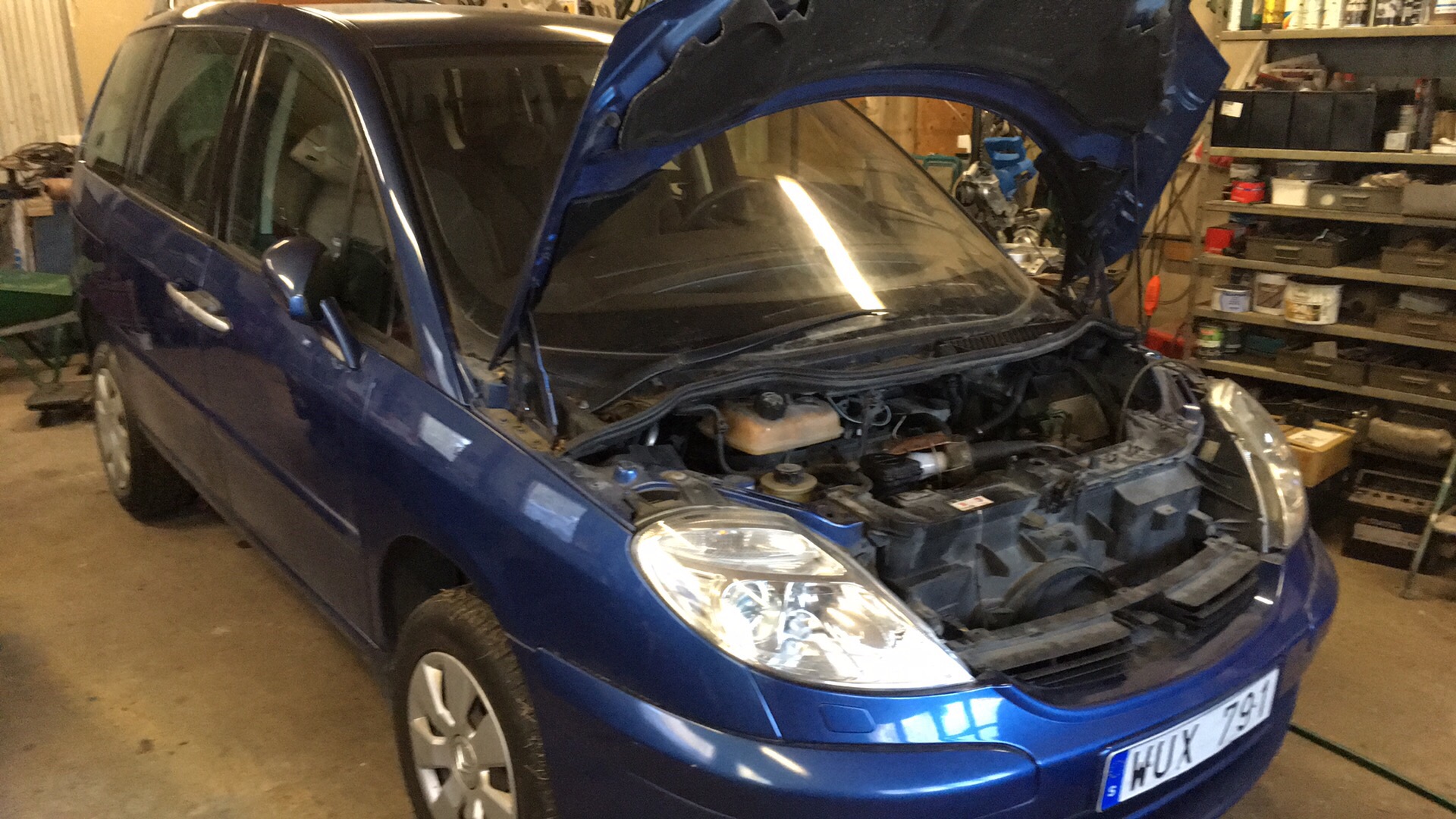

I have a conversion going of a 2005 Citroen C8 to electric.
Tesla LDU and full 85kwh battery to go in there and also two 11kw Gen 2 chargers.
I have been stalled for over six months now mostly due to lack of time.
But I feel that I need to get the car on the road soon.
Damien is always a good source of inspiration, so I follow pretty much everything he does.
I will try to upload some info and pictures.

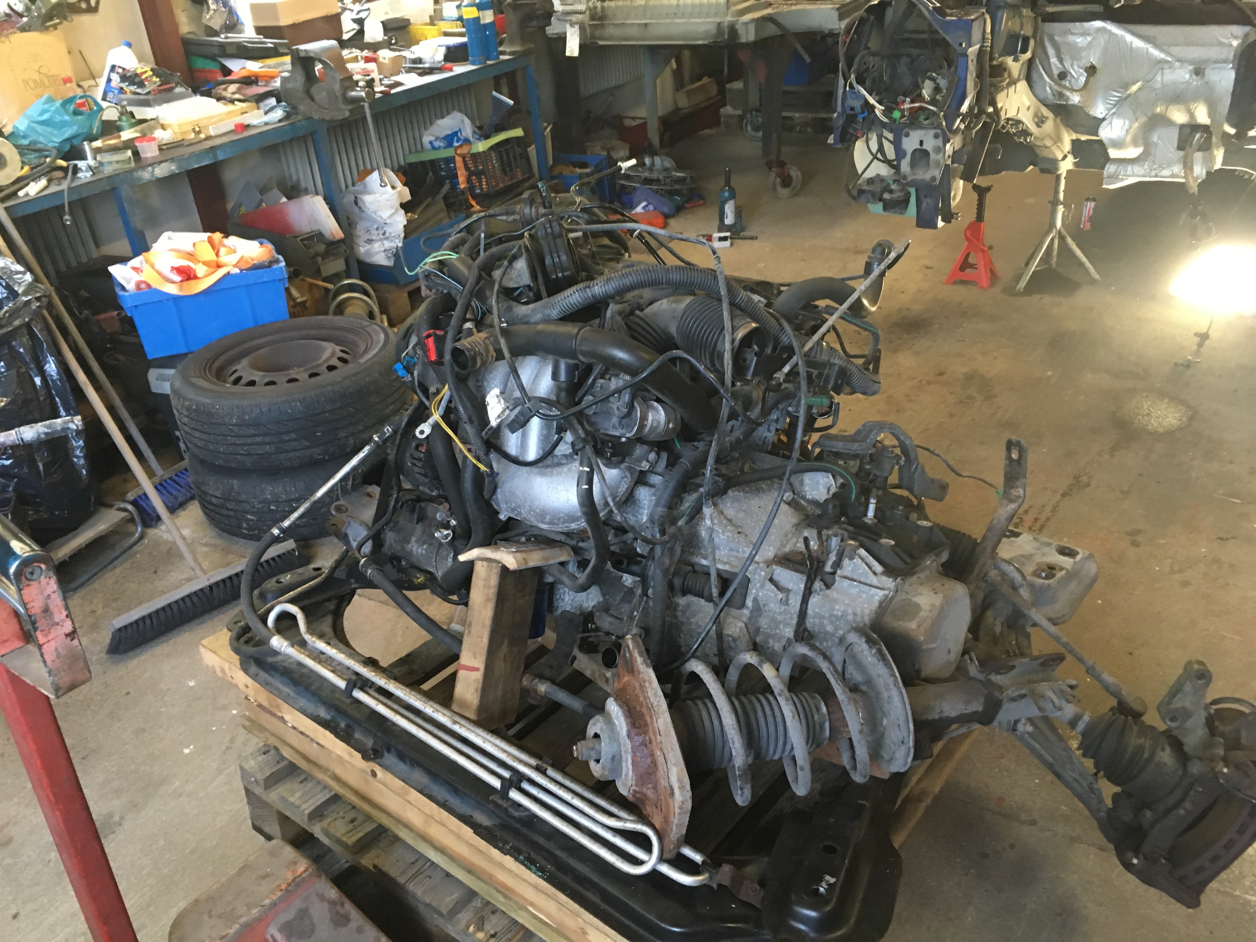

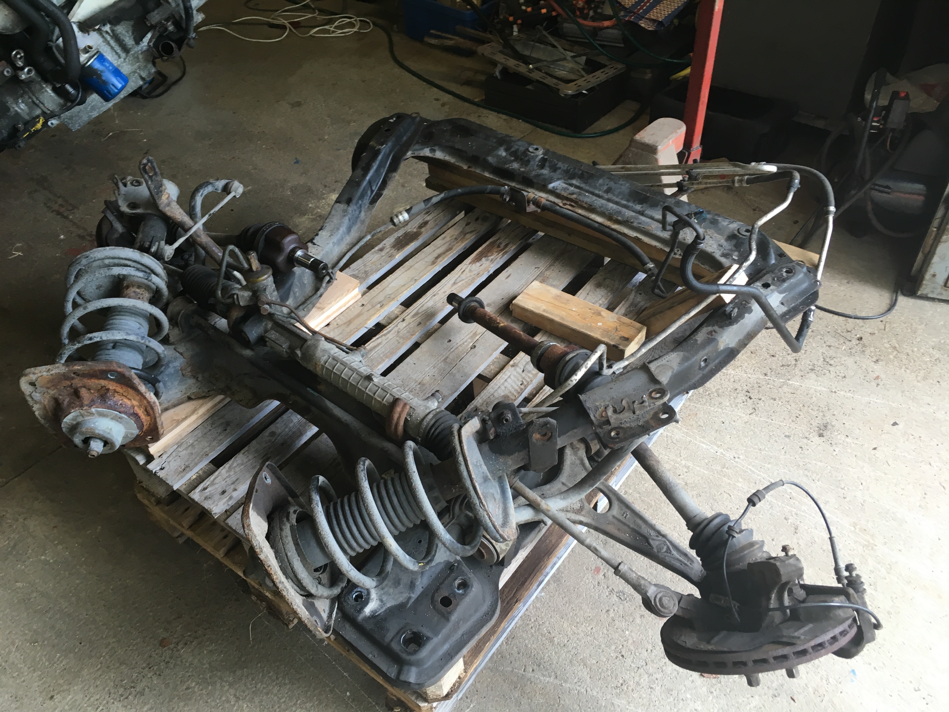

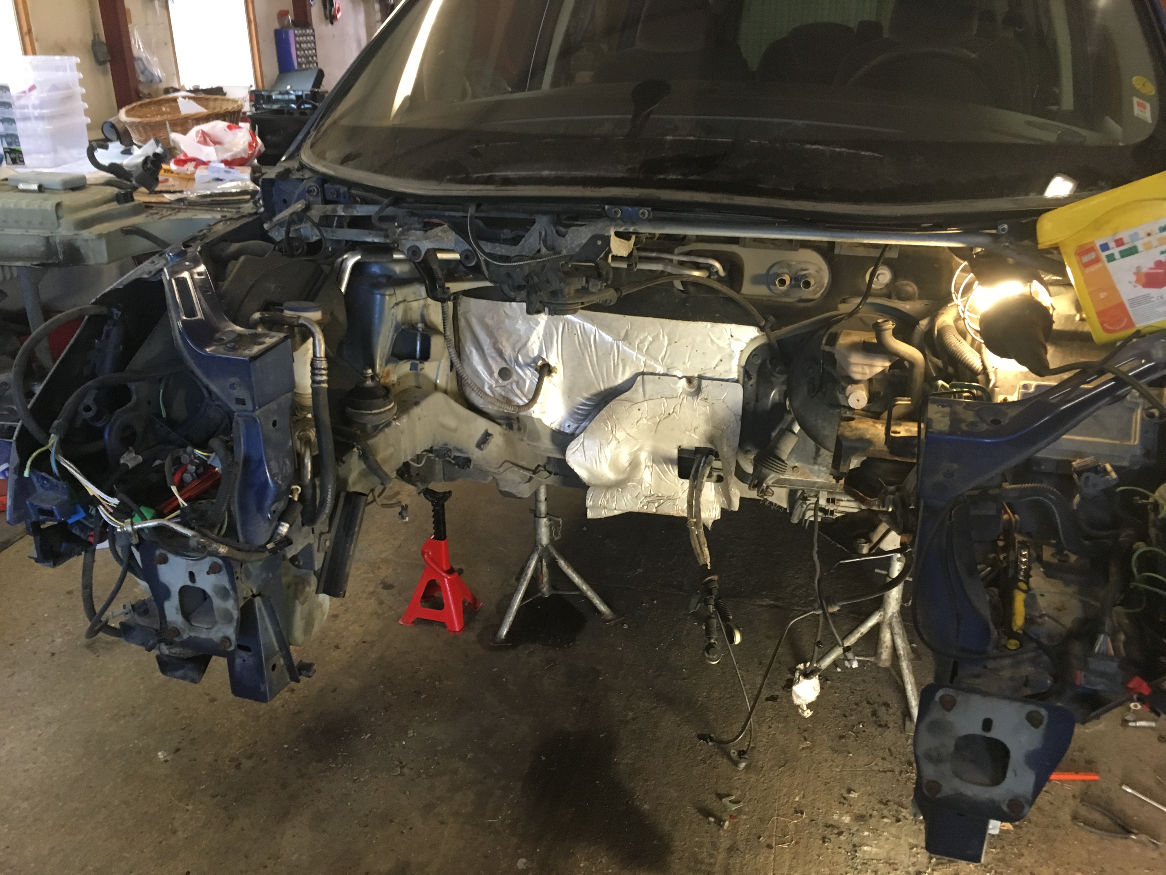

Hi Again !
Here comes some photos.
The patient.
Parts Removed
Parts to put in it
Start to remove ICE ICE out More will come !!!!
The patient.
Parts Removed
Parts to put in it

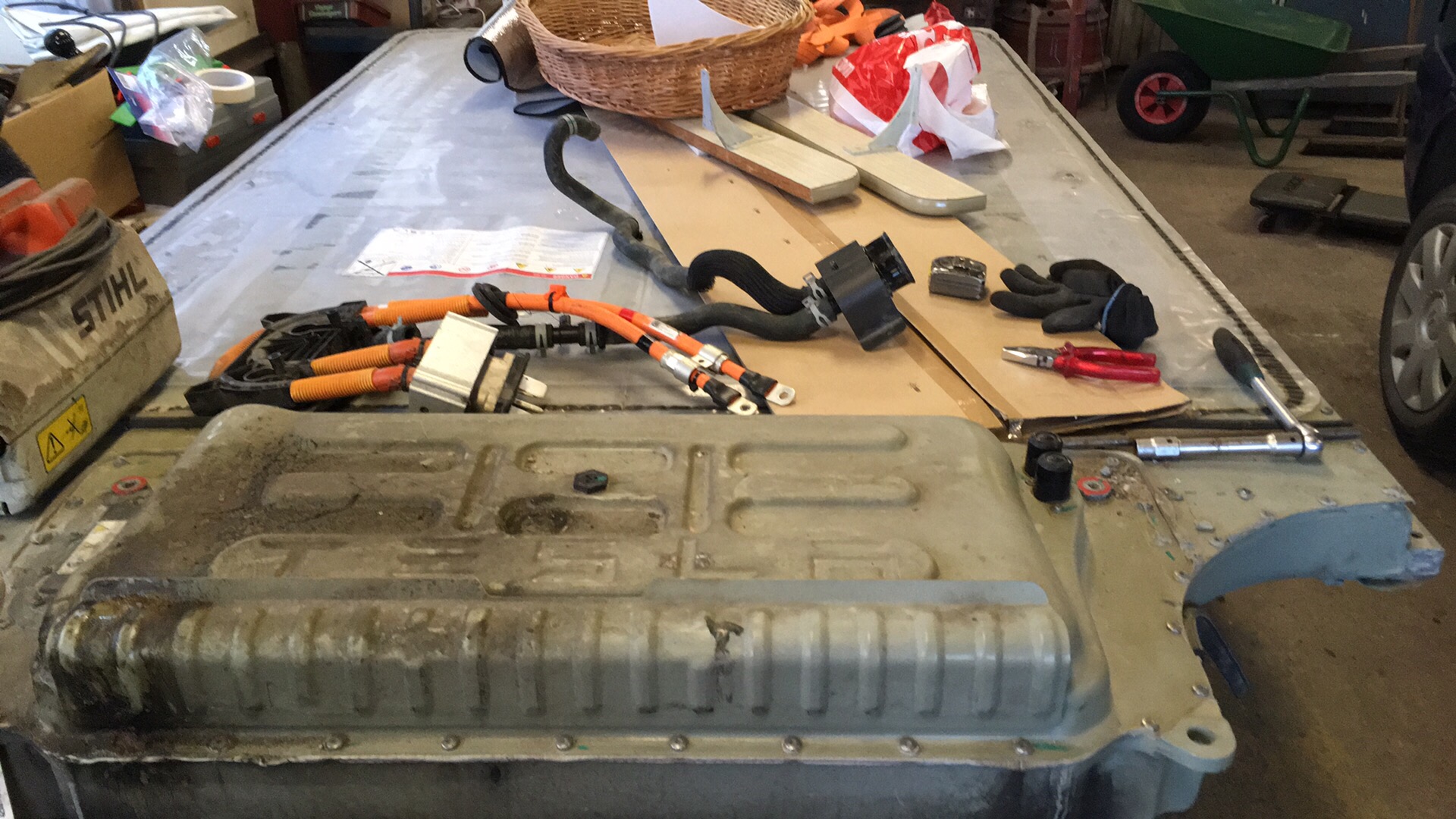

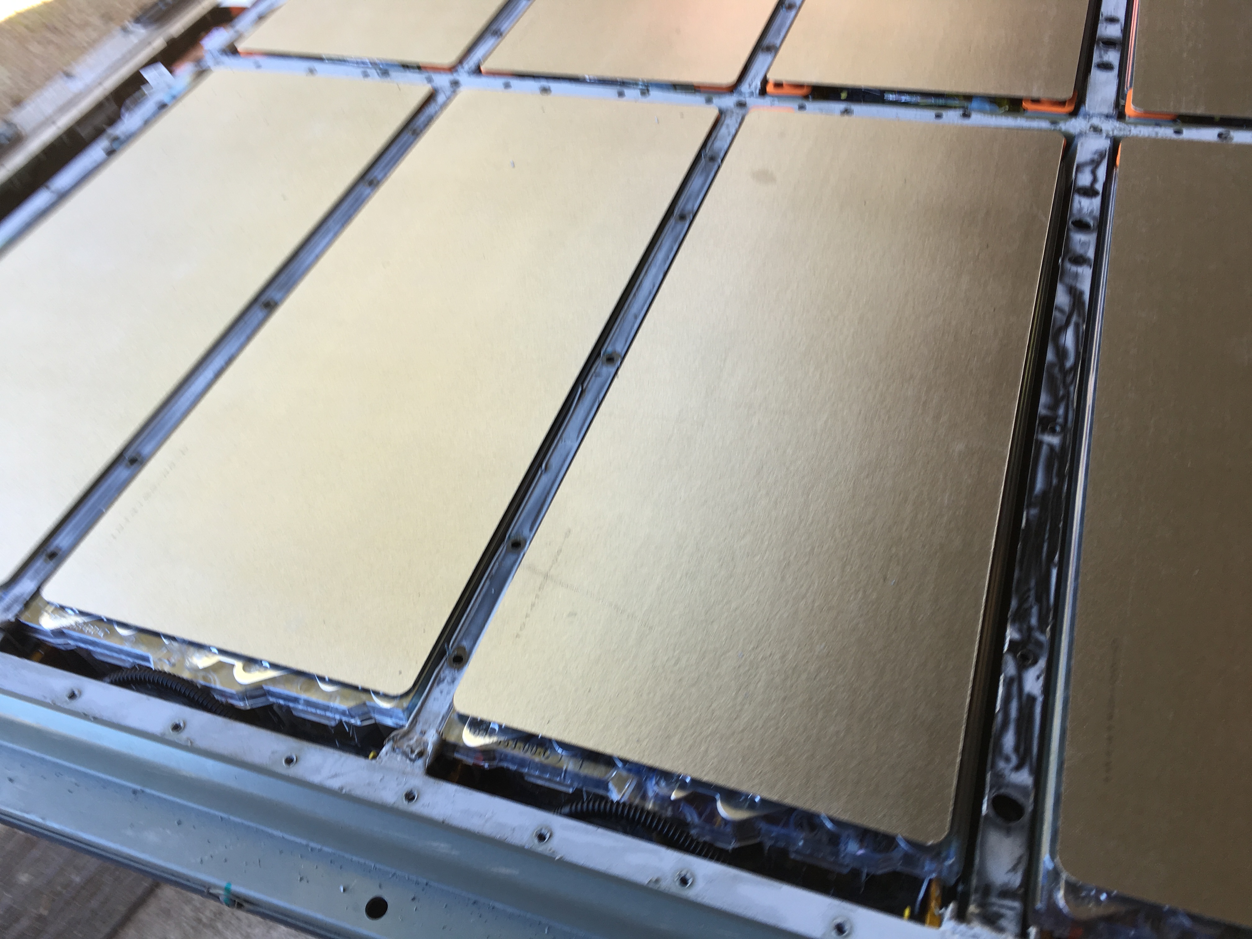

Here comes some more photos from my build.
Motor cradle
Getting to know the weight of the ICE. Thanks for the suggestion on scale Damien.
Unpacking the Battery
All modules out
Mocking up for the battery box.
The empty space where all the stuff should go.
