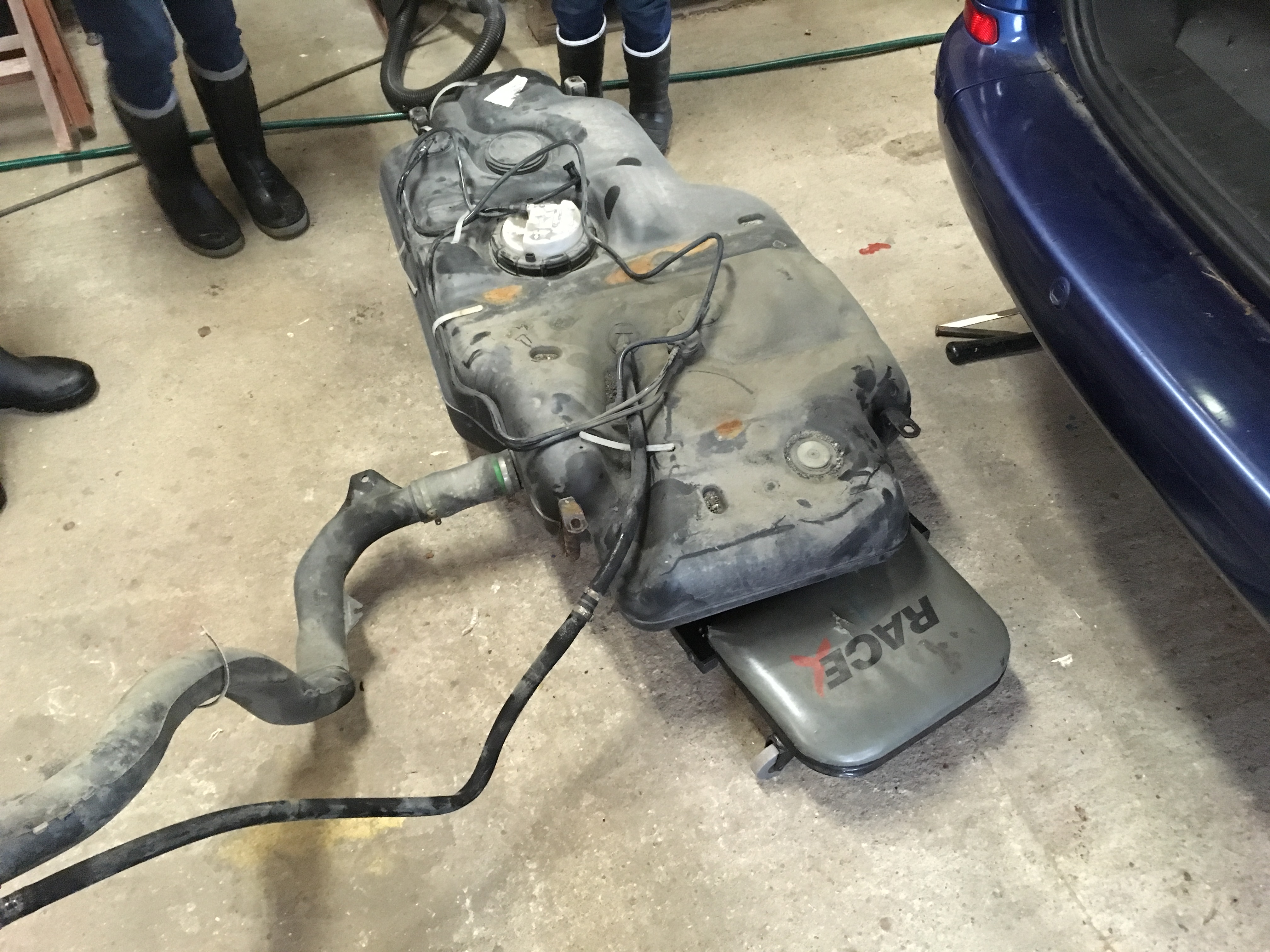

Post by pm_dawn »
Hi Again !
Here comes some photos.
The patient.
Parts Removed
Parts to put in it
Start to remove ICE
ICE out
More will come !!!!
