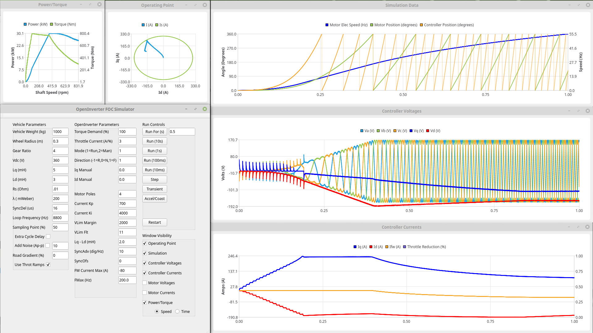

Thought it would be usefull to capture my thoughts on future enhancements for the simulator while it's fresh in my mind. I'm unlikely to get to any of these for a little while but at least if they are posted here I'm less likely to forget about them.
In a vague order of implementation:
  1. Logged data import and comparison - essentially allow the import of logged inverter data (ESP32 high speed log only). This would pop up another window which would allow a file to be selected, it would then run the logged motor voltage data through the motor model and correlate the results against the logged current data. Optionally it would allow a monte carlo style multiple run analysis to search for better matching motor parameters.
    Edit Feb23 - Done see viewtopic.php?t=3047
  2. Motor Loss Modelling - At the moment the simulator reports motor shaft power. By also calculating electrical power going into the motor it would be possible to calculate and plot motor efficiency.
    Edit Feb23 - Done, included in latest github repo
  3. Inverter Modelling - Desat - At the moment there is no current limiting in the model, infinite currents are allowed! It would be better to have a configurable threshold at which point a likely desat event is flagged and the simulation paused.
  4. Inverter Modelling - Losses - At the moment the inverter is considered lossless. It would be possible to calculate the IGBT/diode voltage drops and IGBT switching losses and use these to reduce the DC bus voltage that is available to the motor. There is an accurate way and a simple way to do this. The accurate way is to break each control loop period down into the individual phase switching events and then run the motor model for each of these states. The simple way is to pro-rata the IGBT/diode voltage drops based on PWM value. The accurate way will give very good results but slow down the simulation. The simple way is likely to be 80-90% accurate and have no real impact on simulation speed. Not sure which way to go but probably the simple one. Either way switching losses would just be based on PWM frequency, configurable IGBT turn on/off times and estimates of average current decay profiles.
  5. Battery Loss Modelling - Very simple approach, just allow the battery internal impedance to be entered and use this to calculate a voltage drop and power loss.
1. is mainly to see if we are using the right motor parameters.
2. 3. 4. and 5. are more to improve the realism of the simulation but also to allow the effect of different mtpa/mtpv schemes, particularly on efficiency, to be evaluated.
Really should also add some sanity checks on data entry fields and possibly allow changes to inverter parameters to be persisted across program restarts (rather than just reinitialising from the param_prj.h file each time - a button would also be needed to allow a manual refresh from the file though.
Any other ideas, or differing views on priorities, please let me know.

At risk of exposing myself as the dummy I am could someone give me a step by step guide to building the simulator?
Obviously I start with GIT clone ……

Sorry, been meaning to have a look at this but have been feeling a bit rough recently.
Not too keen on commenting out that block without understanding why the simulator doesn't like it (in case it indicates a bug with the simulator) so have had a look at it.
This is the standard code:
And this is with the block commented out:
What you can see from this is that Vq does actually need to go negative during the acceleration to keep full control of Iq. You mostly get away with it but do partially loose control until the frequency reaches 30Hz and Vq is allowed to go negative. Can't see any reason why this would be any better in the real world in the car (unless the currents are lower, it doesn't show up at all on lower throttle current values?, or it might be hard to feel as it only lasts a fraction of a second). I'm sure that if you go looking for it you will find traces of it so I think it would be better to fix it rather than commenting out the code for the simulator.
This is the best fix I have come up with:
      if (frqFiltered < FP_FROMINT(5))
         qController.SetMinMaxY(dir <= 0 ? -qlimit : 0, dir >= 0 ? qlimit : 0);
      else
         qController.SetMinMaxY(-qlimit, qlimit);
which gives this:
I can't quite remember why this block is here but would reducing the frq threshold from 30 to 5Hz be acceptable as it virtually eliminates the problem?

Ev8 wrote: Mon Nov 28, 2022 7:27 am At risk of exposing myself as the dummy I am could someone give me a step by step guide to building the simulator?
Again sorry should have done this sooner!
First install Qt, https://www.qt.io/download-qt-installer. I'm still using an old version but it should work fine with the latest too. The open source version is fine for this. Qt should be happy on Linux, Windows, Mac, etc.
Once it has downloaded create a directory and then clone the simulator code into it
git clone https://github.com/Pete9008/IPMMotorSim
if using Johannes repository which has the submodule already there you can include --recurse-submodules to also get the openinverter firmware. Otherwise if using mine move to the IPMMotorSim subdirectoty (the one that contains the IPMMotorSim.pro file) within the project and get the firmware
git clone --recurse-submodules https://github.com/jsphuebner/stm32-sine
Open up Qt and then open the IPMMotorSim.pro file. It should then ask about configuring the project, selecting the default kit (that should already be selected) will be fine. Then just to be safe do a rebuild (under build menu) and run (either the play icon or F5) and it should run. You will probably need to adjust the settings in the param_prj.h file (same directory as the .pro file) to match your install but make sure that both the resolver and motor poles are set to 4 (other values should also work but I haven't tested it, the resolver and motor poles values do have to match though).

One other though on the above code mod. Wondering if this is what is actually causing the low speed trips when stepping hard on the throttle from standstill. It would fit all the symptoms - not allowing Vq to go negative means that Iq rises in an uncontrolled way to a much higher value (460A plus another 150A of Id in the above example - with the limit set to 300A!) which could well cause a desat event?
@Bigpie - might be worth a try?
